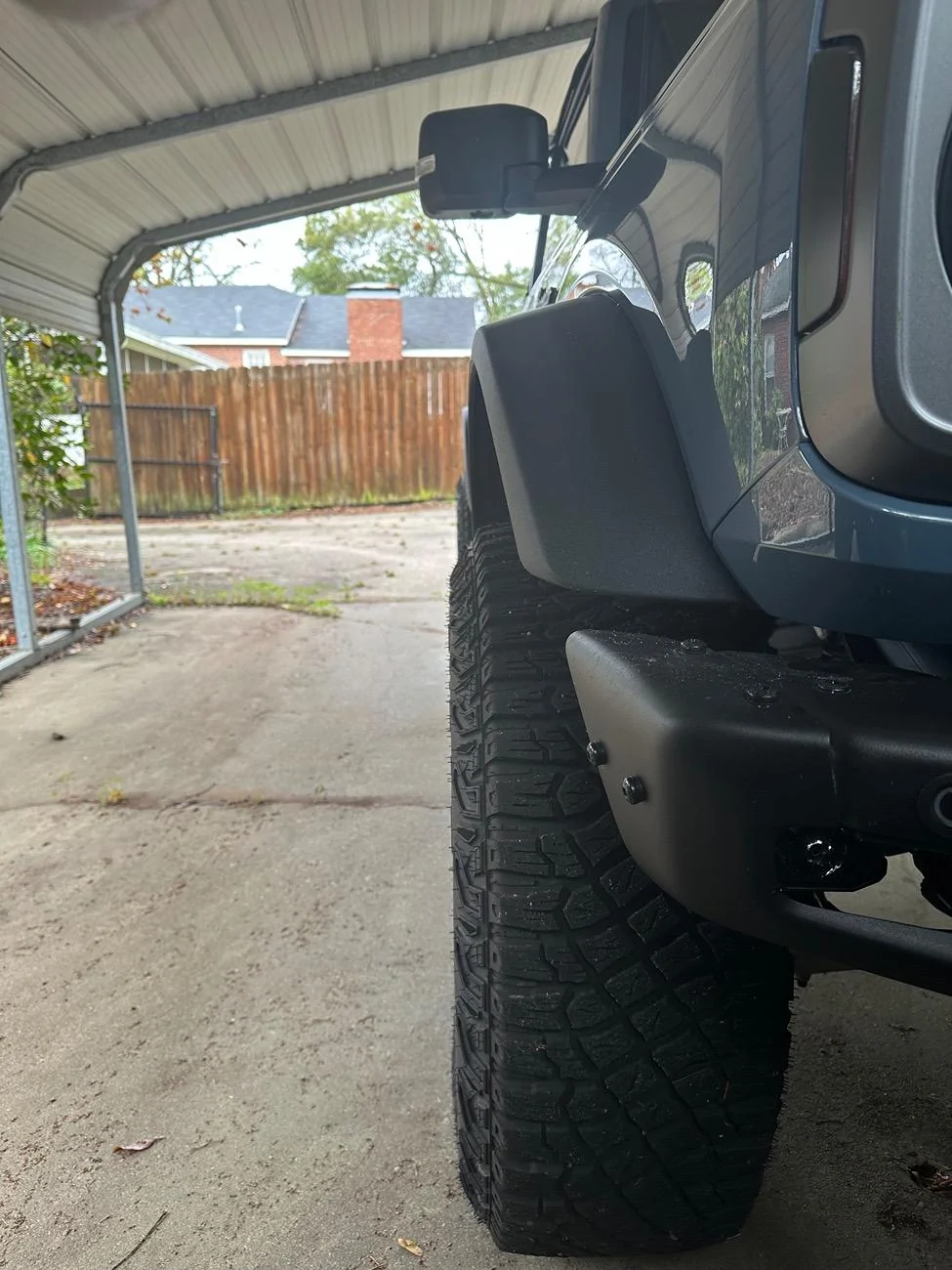

2023 Bronco Badlands 2 Door SAS
No issues here. SAS with stock tires and 0 offset wheels shown below. Now I am running -18 offset with stock tires with no issue. Note: I'm not into heavy off roading so I can't comment on that.
Ford Bronco 0mm Offset on Stock Sasquatch? IMG_1189
