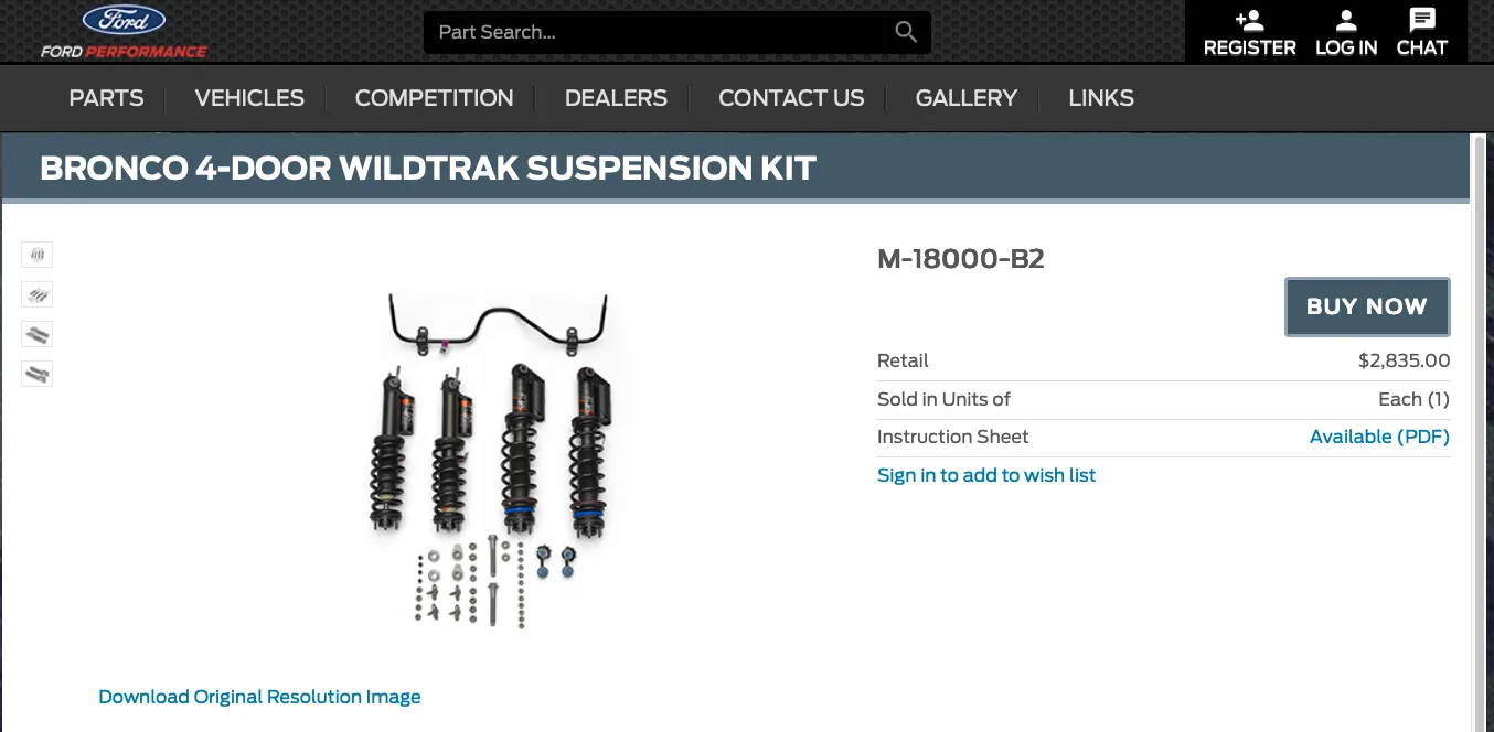

So I was doing my typical parts hunting for my Bronco Break series on YouTube (also because I'm obsessed and apparently have nothing better to do). Tonight's parts hunt found something I did not expect, and I'm sure many of you will be interested in it. So I'm sharing it now rather than waiting for the video.

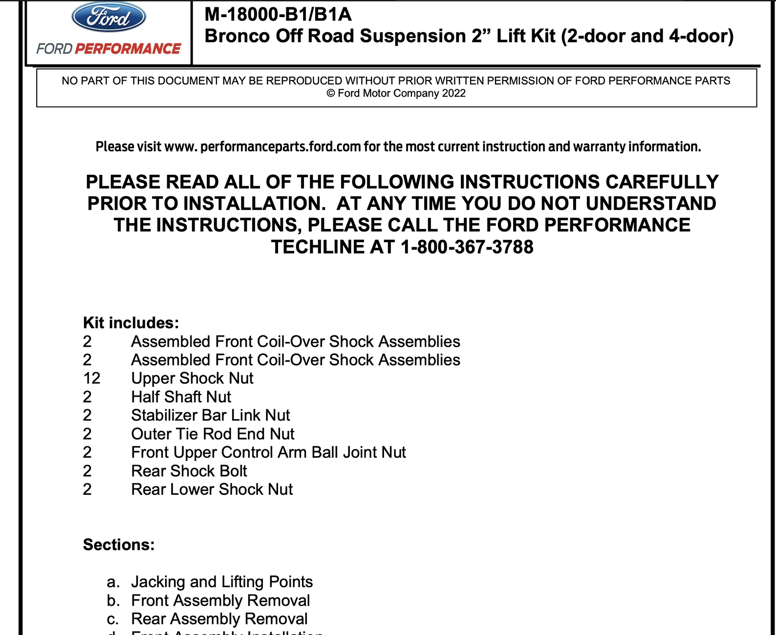

Ford is now selling the HOSS 3.0 suspension kit standalone through Ford Performance! Comes with both front and rear coilovers, and a rear stabilizer bar. The wording in the product description suggests that it's intended for installation on a non-Sasquatch Bronco, but I don't see why you couldn't use it on a Sasquatch Bronco if you wanted—you just might end up with a stabilizer bar that probably matches the one you already have.

To anyone who has actually swapped out the front coil-overs, do you REALLY need to go as far as pulling the front wheel bearings out of the uprights?!?! That seems CRAZY!!!

Hmm for less $$ one could order the Bilstein 6100/6112’s. I understand you get a warranty but I haven’t seen a direct comparison between the two. Are these better than 6100’s?
6100s would be more comparable to the Bilstein HOSS 2.0
These are Foxes and are a small step down from the Live Valve found on the Raptor
If they were height - adjustable it would be killer. The price isn’t horrible
