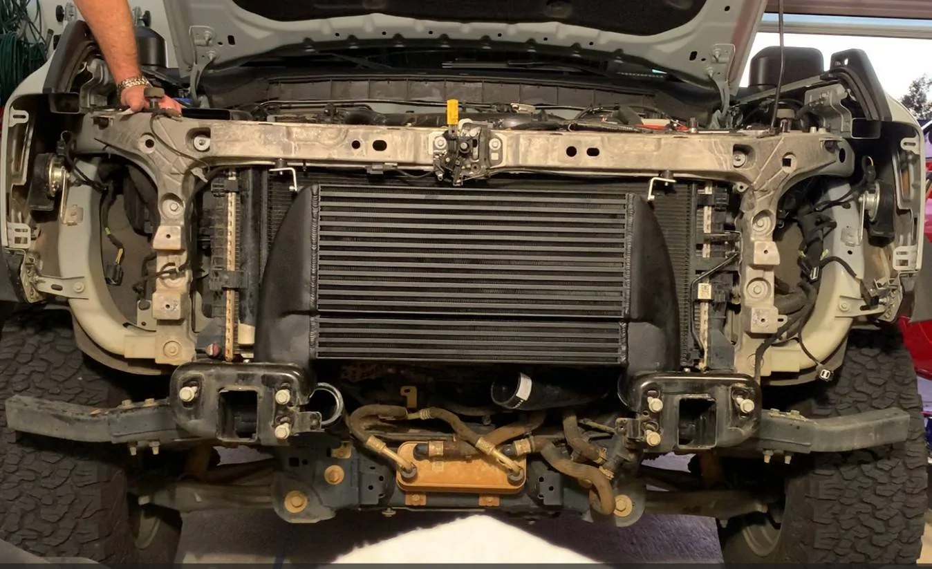

I also very much like the look of the Bronco without a front mounted winch or large winch bumper. With this in mind I set out and made my own. I had to move the stock intercooler out of the way. I went with the Wagner High Mount Intercooler and have a thread on here about that install. I am very pleased with it. This opened up the space where the OEM intercooler was to place the winch with the fairlead coming out of the OEM front bumper opening.

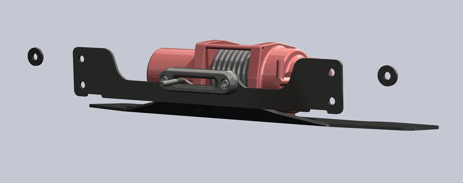

I then designed a pretty simple winch mount that picks up on the 4 frame bolts that mount the front skid plate mounts. It also uses the front inner four front bumper mounts. It is all .25" steel. So thicker than other currently available mounts with a more in-plane loading. Not shown in these is a 1" tall rib that is .25" thick and runs across the full rear face of the mount to reduce deflection. I did some stress analysis of the mount loading and found that without the rib everything should be fine at worst case conditions, but the rib helps reduce the deflection and becuase the space is so tight this was neccessary.
This is the CAD mock up.

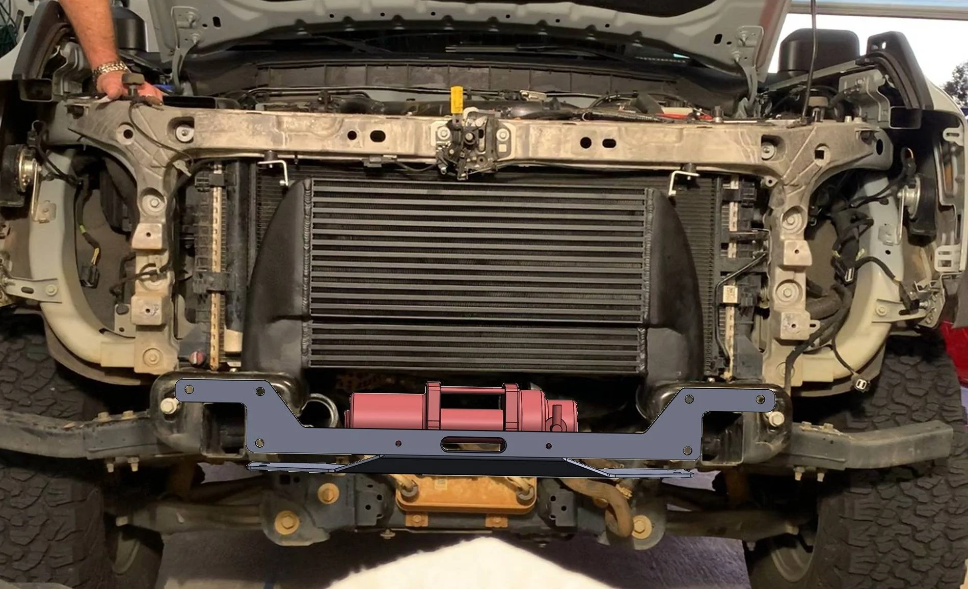

And test fitted to the bronco in CAD and image scaling.
Ford Bronco Highest Hidden Winch Install - w/ stock skid plates and bumper winch4
This was a slightly earlier design, but all of the mount locations lined up and this is actually where I decided to use the smaller fairlead and change the front mounts to only 2 locations on each side instead of 3.

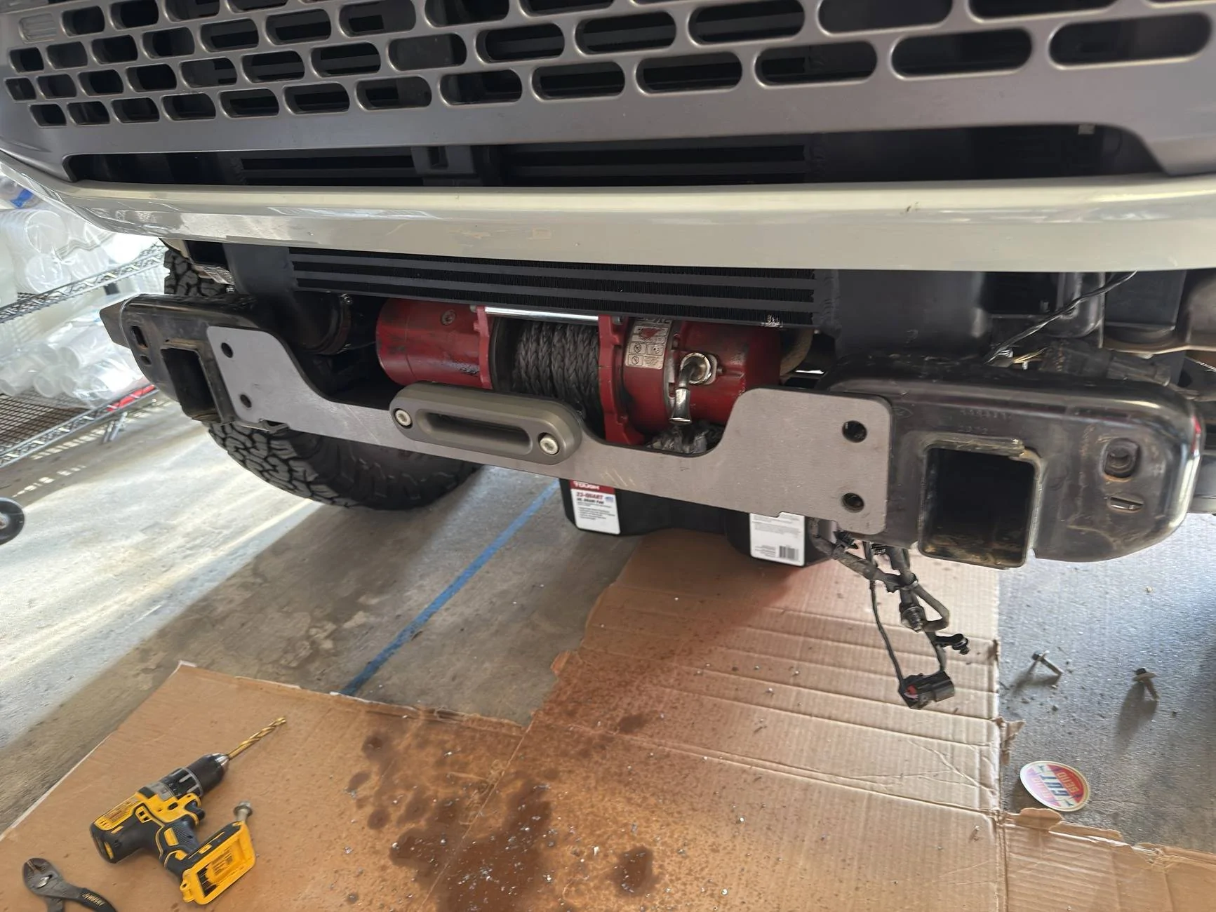

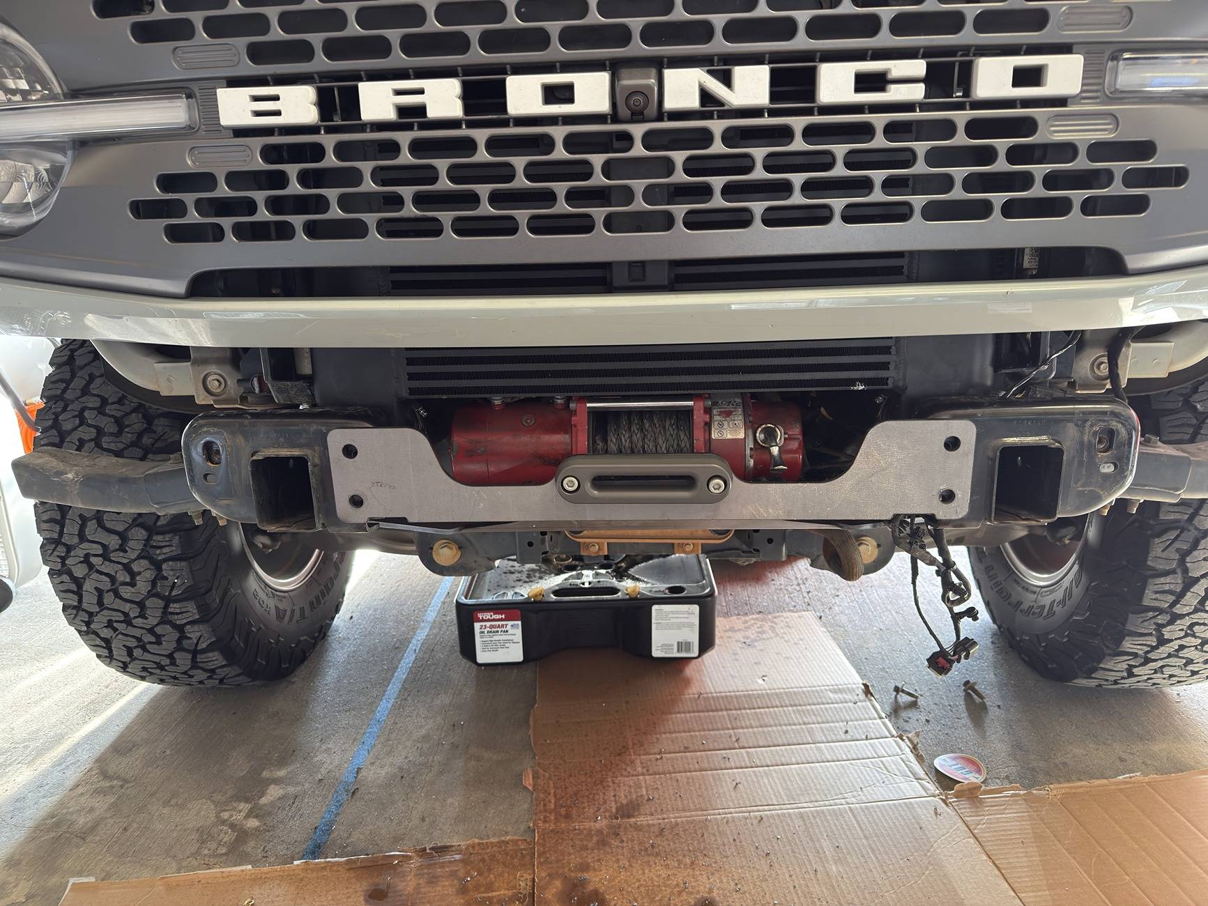

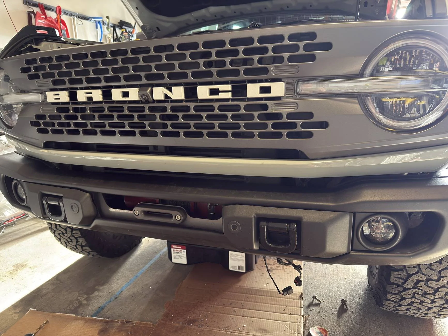

I finally got all of the parts in and was able to test fit everything and it looks great. It then came back off for the rib welding and paint.

For Wiring I am running a solid state winch controller mounted by the battery with a 500amp turn on solenoid conrolled by Aux switch 6. The solidstate controller is directly wired to a badlands wireless winch controller. Ill make another post about that wiring and setup, but I expect is to be very quick and easy.
I am running a small fairlead to allow for more room to access the cluch lever which is visivle through the driverside front opening.
