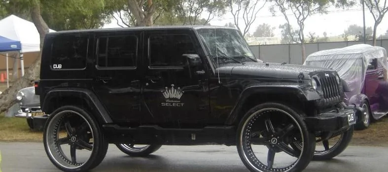

Gotta get the RUBBER BANDS MANG!!
Nitro Terra Grapplers or BFG KO2
The guys at that car show were hunting around for a steep pipe to throw at them spokes.
