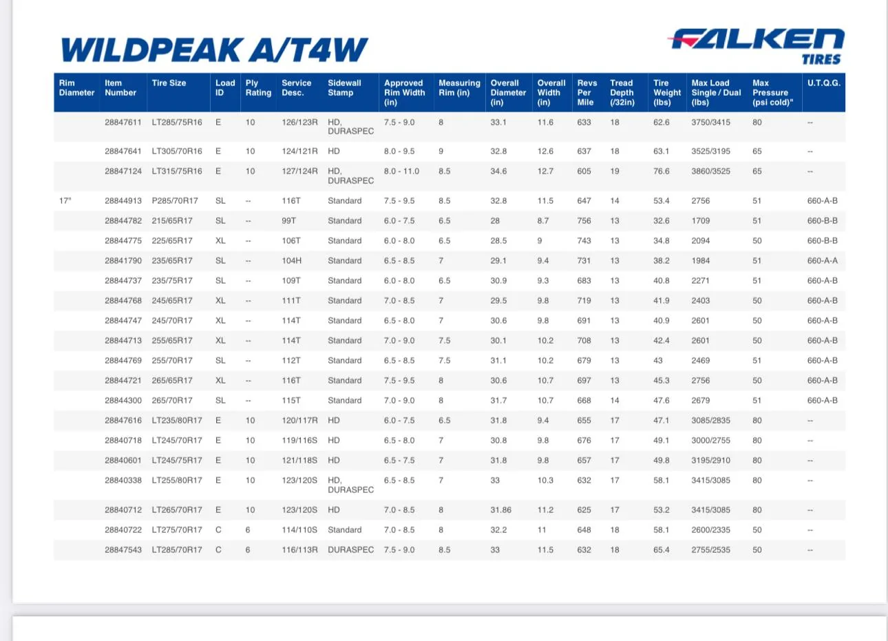

It’s so confusing as Falken doesn’t seem to fit those descriptions for the size needed
Towards the bottom, the C rated have a “duraspec” 6 ply that weighs a whopping 65lbs
The “standard” 6 ply is 58lbs
Then the E rated 10 ply “HD” is only 53lbs but it is a slightly smaller tire
the duraspec supposedly has the plus up the side for a safer/more durable sidewall. Which s ema safer however that is a 10lb per tire jump in weight. A 2.7L engine might lose too many mpg?
and this is why we have been so confused

Weight was what kept me from Falken when I was buying tires for my Big Bend. They were a lot heavier than every other option it seemed. But people LOVE them. You will most certainly see some MPG hit going with heavier tires. If you do more daily driving than off-roading I’d probably stay away from E even if they are lighter (which is weird and seems to defy logic).
