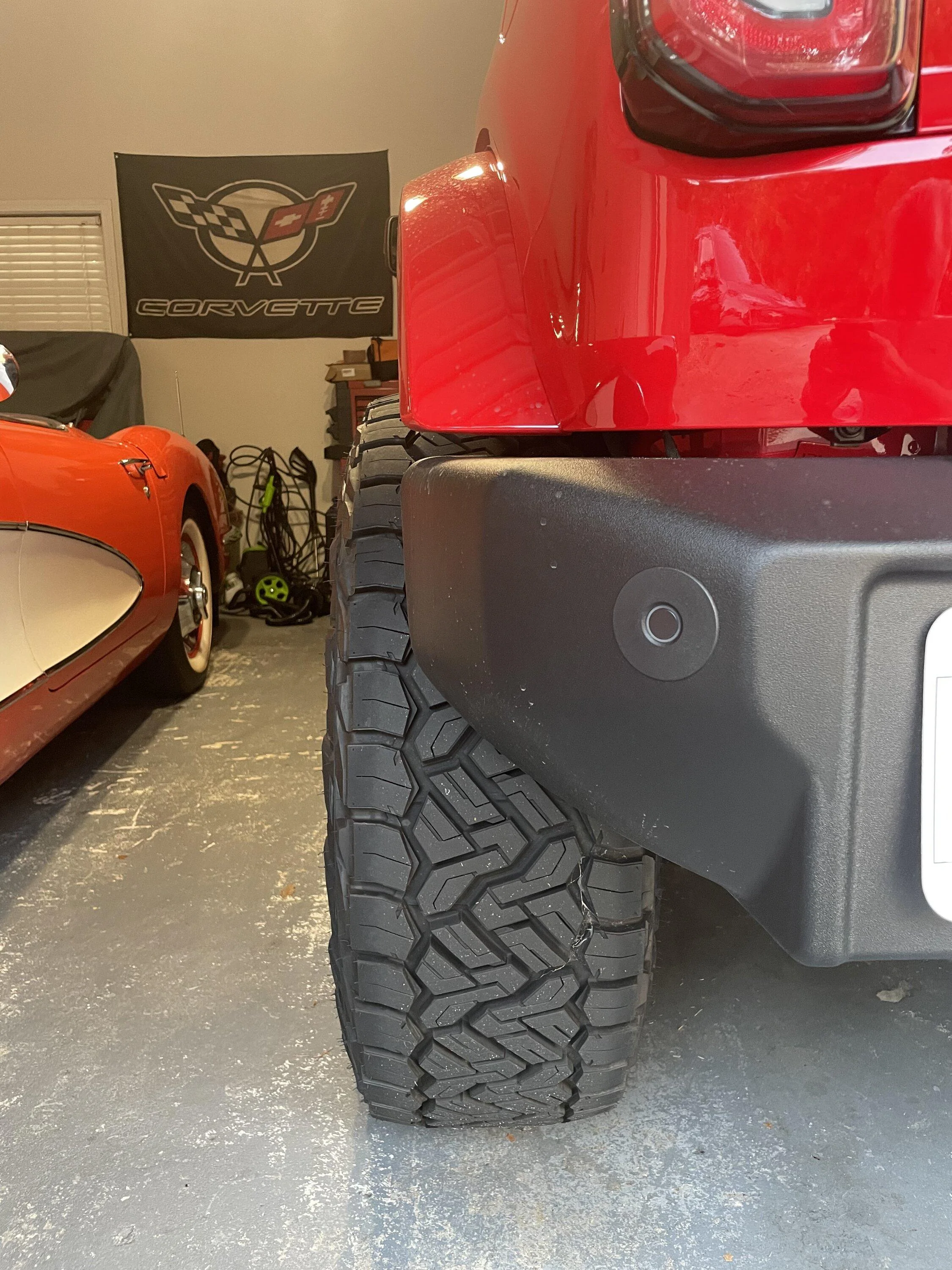

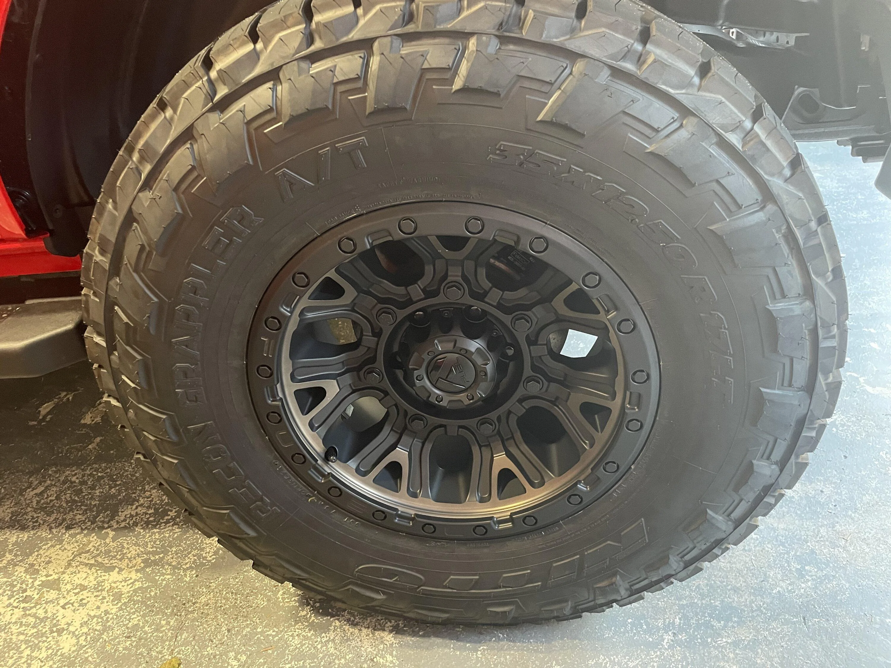

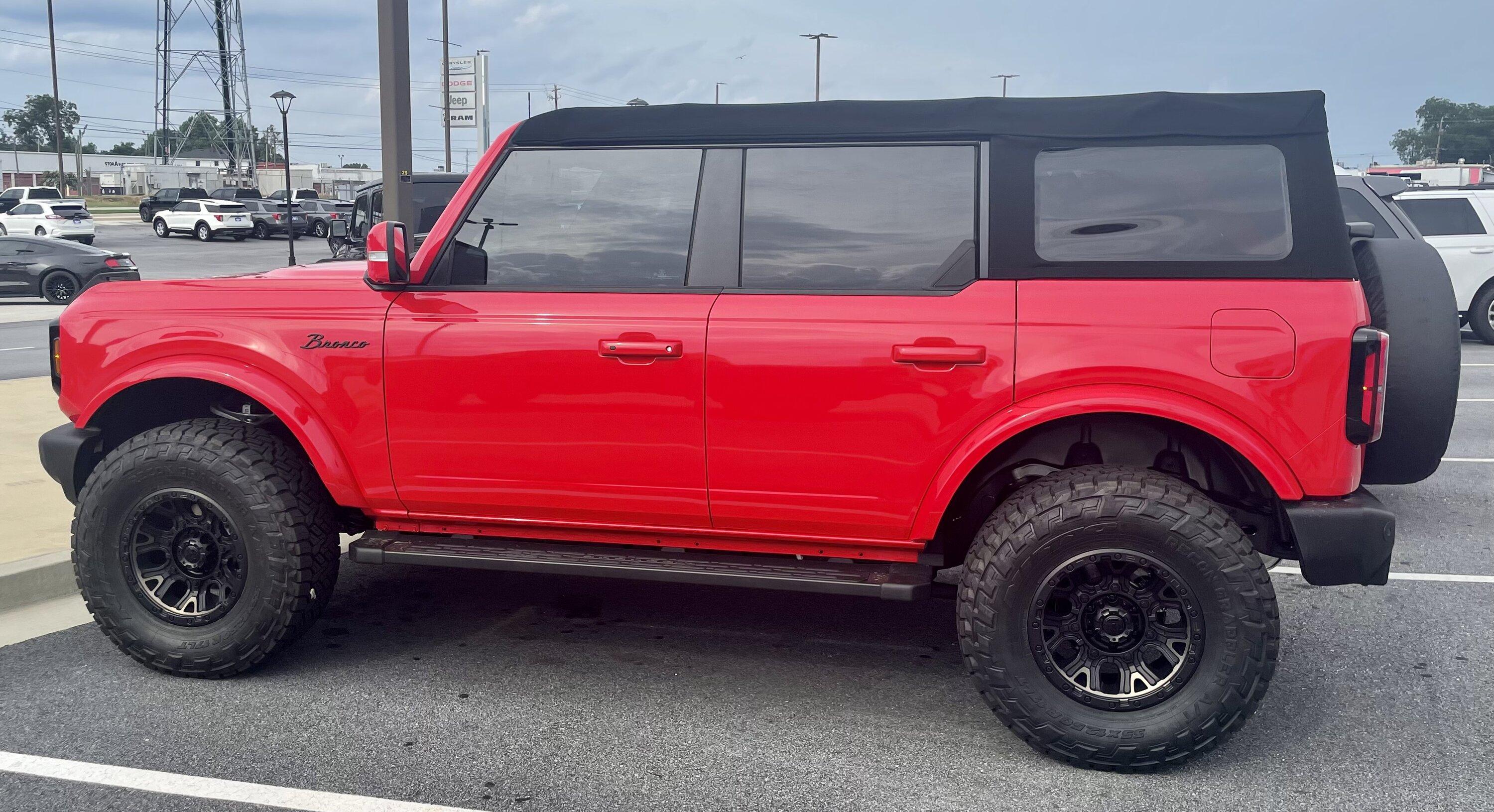

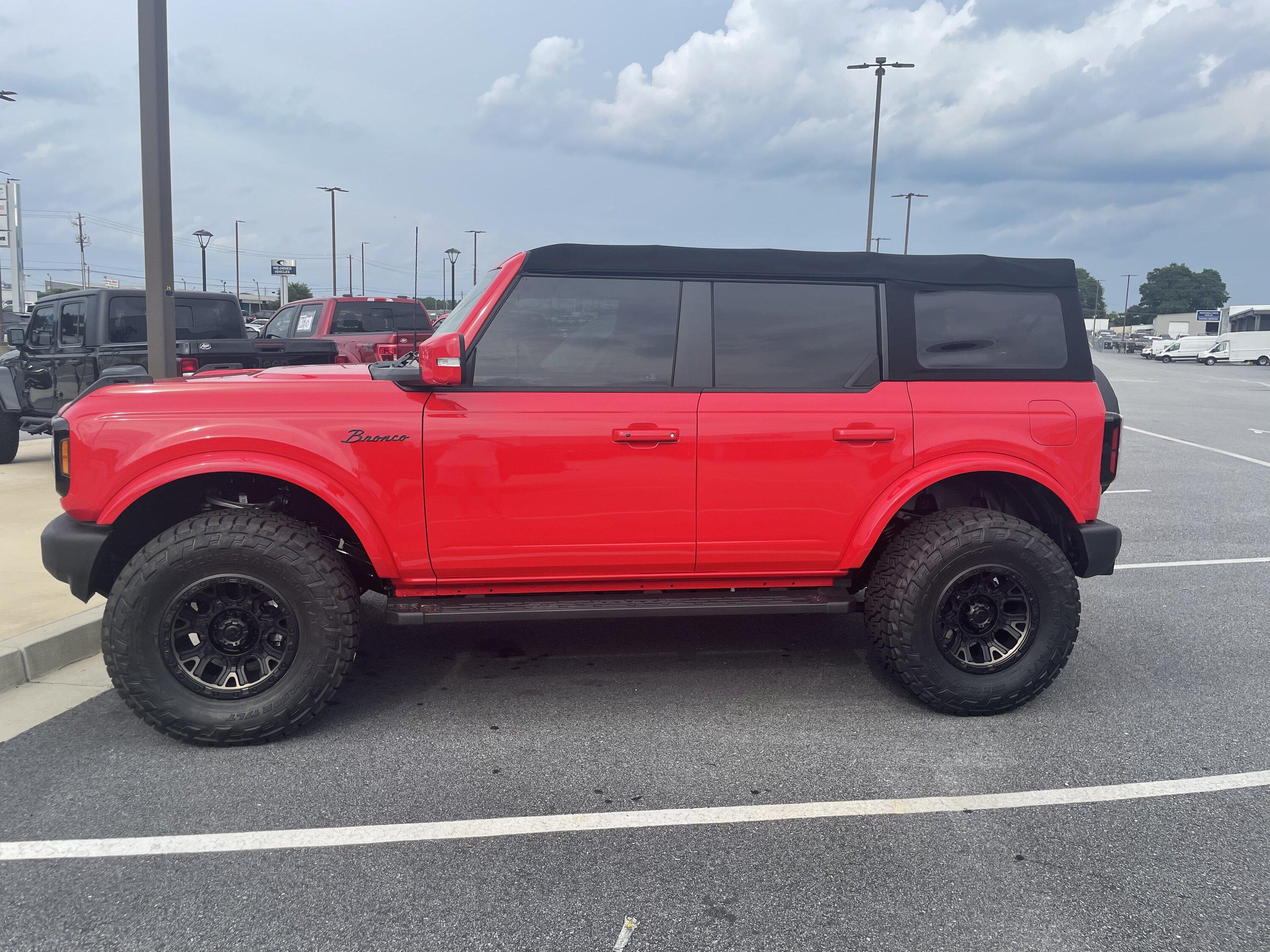

We went with 2” readylift lift/level kit. Lift not needed to run 35s. Just need to remove crash bars. 35x12.5r17 Nitto Recon Grapplers with Fuel 17” wheels. +1 offset so has slightly aggressive stance. We love the look!
