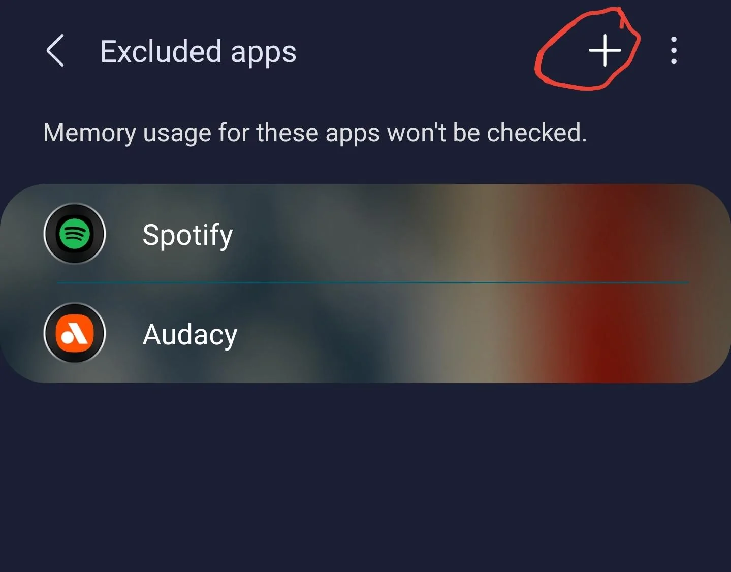

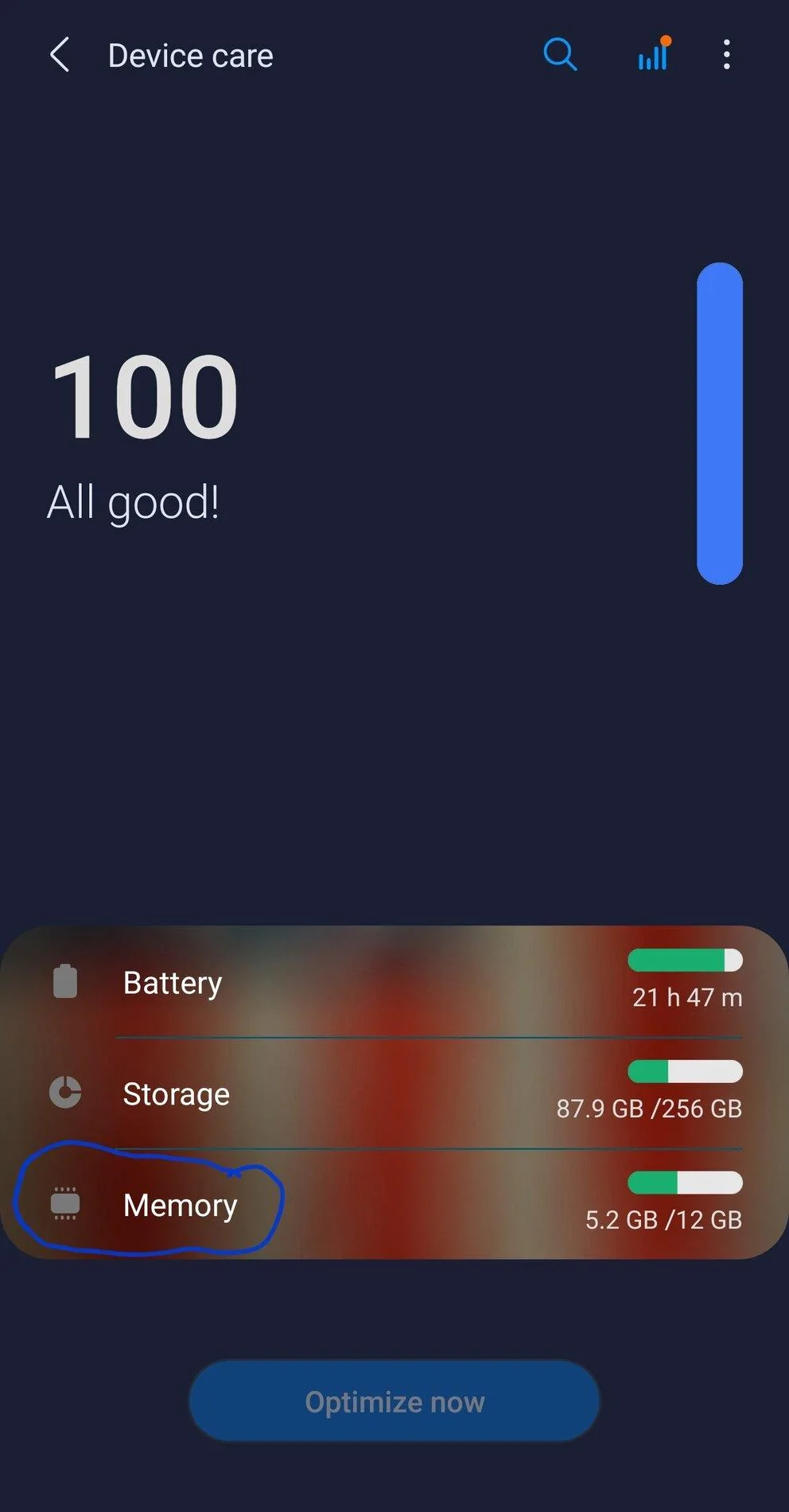

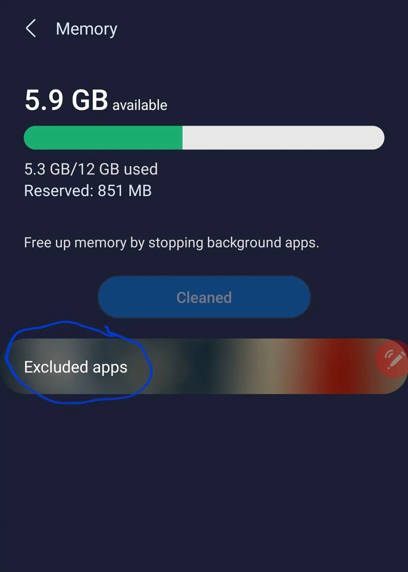

I have been having the same problem with wireless Android Auto. While streaming audio, it starts "skipping" very badly. If I use it wired it is not a problem. I have LUX. I use Galaxy Note 10. In my research I found it to be a common problem and found somewhat of a fix. It has to do with the battery keeping up with memory usage. You can exclude an app from the memory usage being checked. Under settings go to battery and device care. Then select memory, then exclude apps, then add the app to the exclusion list. This worked for Spotify but not Audacy. I am sure Apple has different steps, but this might give you a general idea of how to do it on Apple.
Ford Bronco Wireless Apple Carplay is Awful Screenshot_20210817-104723_Device car
Ford Bronco Wireless Apple Carplay is Awful Screenshot_20210817-104800_Device car
Ford Bronco Wireless Apple Carplay is Awful Screenshot_20210817-104834_Device car
