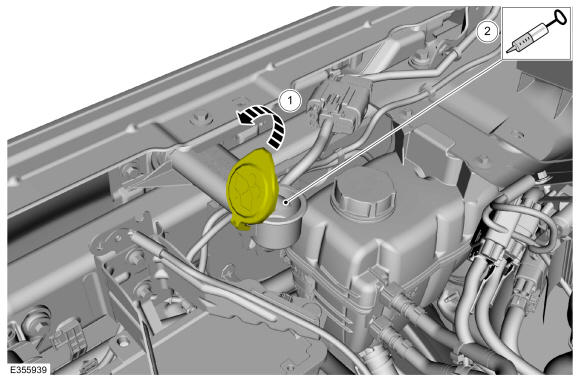

  1. Siphon the windshield washer fluid out.
    1. Open the windshield washer fluid reservoir cap.
    1. Siphon the windshield washer fluid.
      Use the General Equipment: Fluid Suction Gun
      Use the General Equipment: Fluid Container

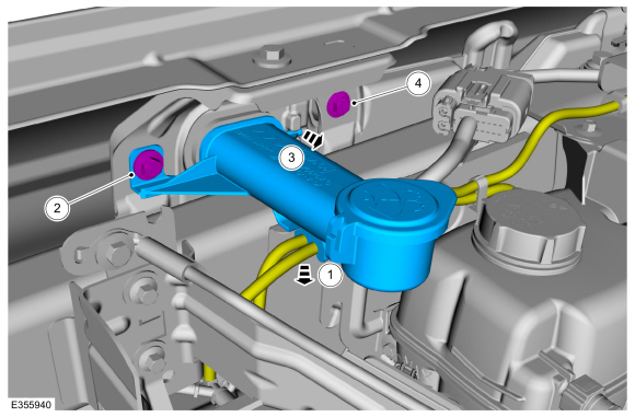

  1. Remove the windshield washer fluid reservoir fill neck.
    1. Detach the windshield washer fluid hoses.
    1. Remove the windshield washer fluid reservoir fill neck retainer.
      Torque: 42 lb.in (4.8 Nm)
    1. Remove the windshield washer fluid reservoir retainer.
Ford Bronco {thread} {filename}
