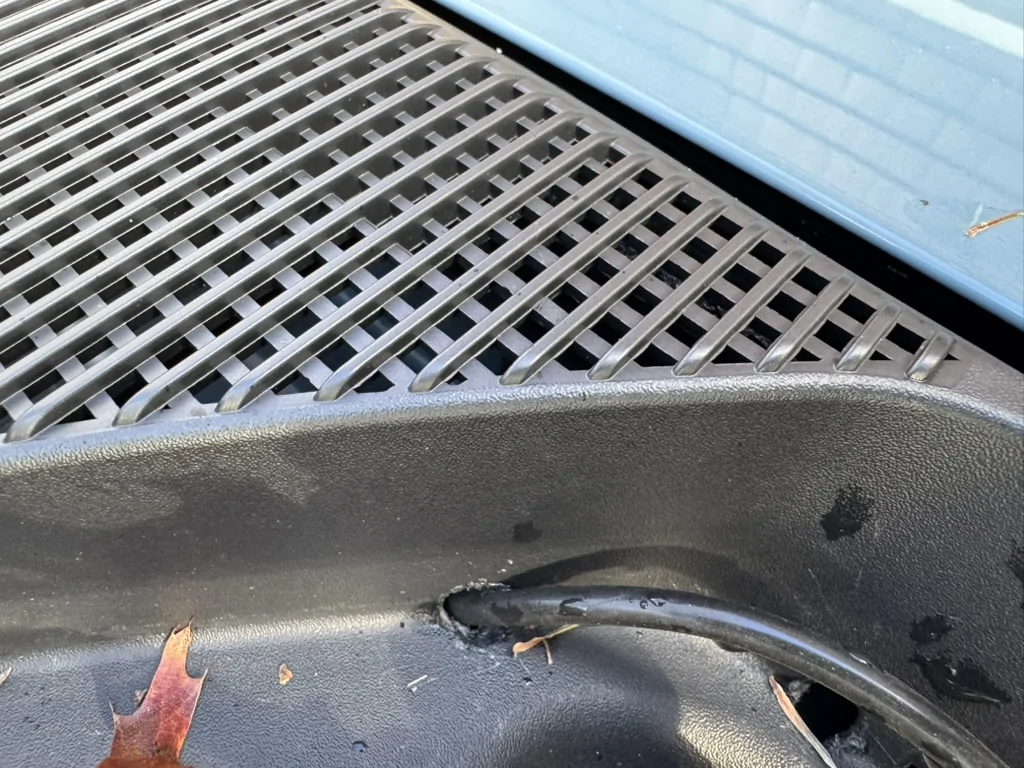

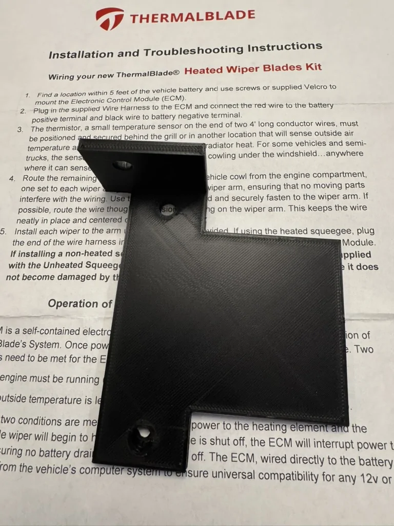

Since there's been no followup on this, I went and purchased a set of thermalblade heated wipers. They are the ones Gatekeeper resells, but Gatekeeper also includes a bracket for the extra money. I 3d printed a bracket (if anyone wants he STL or the tinkercad info, let me know.

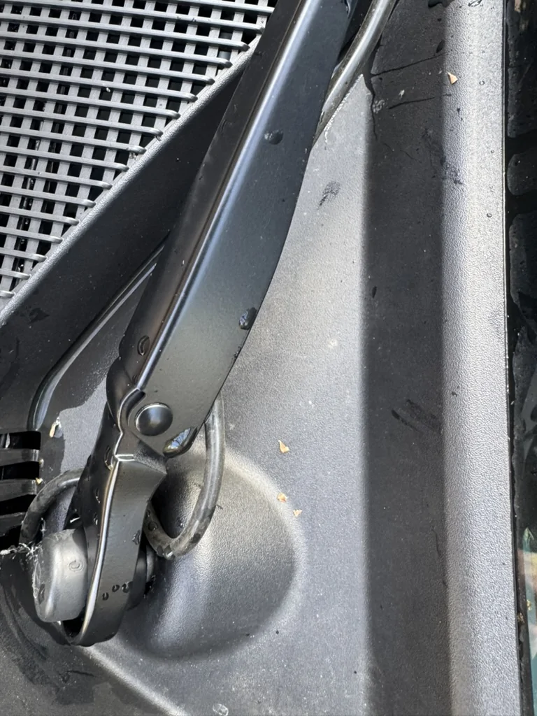

Kind of a pain to get the wires through the Cowl, and the passenger side I had to add another 'drain hole' that I ran the wire through.
Just getting around freezing in my part of the north east, so no reports yet. I'll post when I have more feedback about them. Some pics of the install, needs some cleanup this weekend.

So no complaints so far. Had some snow and ice overnight this week and seems to be working well. Remote started the bronco and wipers were pretty clean when I came out. I haven't driven it in a big storm yet, so that's the next real test. I do think the warm squeegees are cleaning my windshield well. So no issues so far.

So I ran them all winter, drove through some really bad storms that I had to stop and deice my headlights. The wipers were great, no accumulation. And when I remote started in the really cold mornings or with snow/ice accumulation, there was no sticking to the windshield and the warm blades worked well in the morning. So no issues and it was worthwhile.
