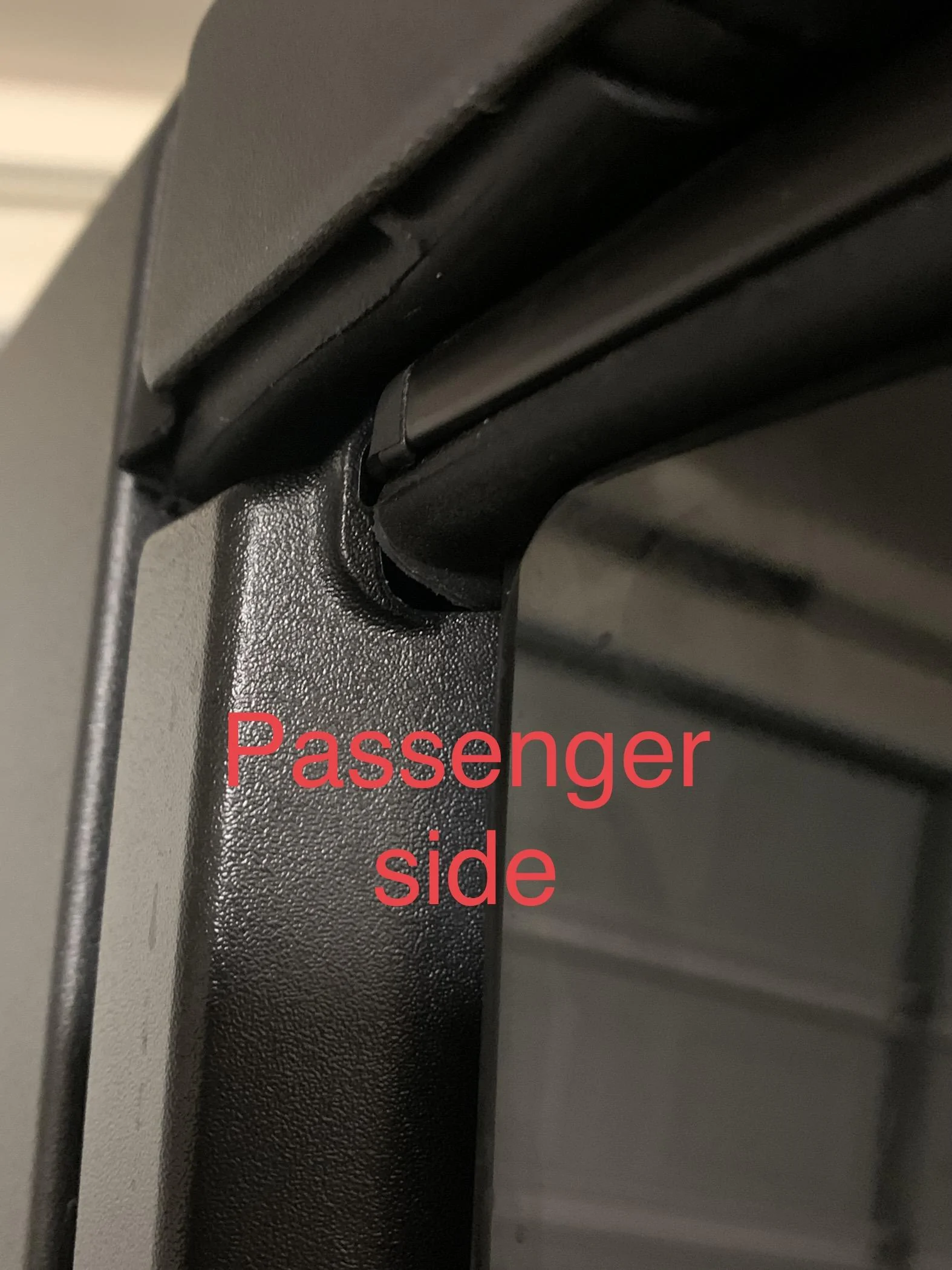

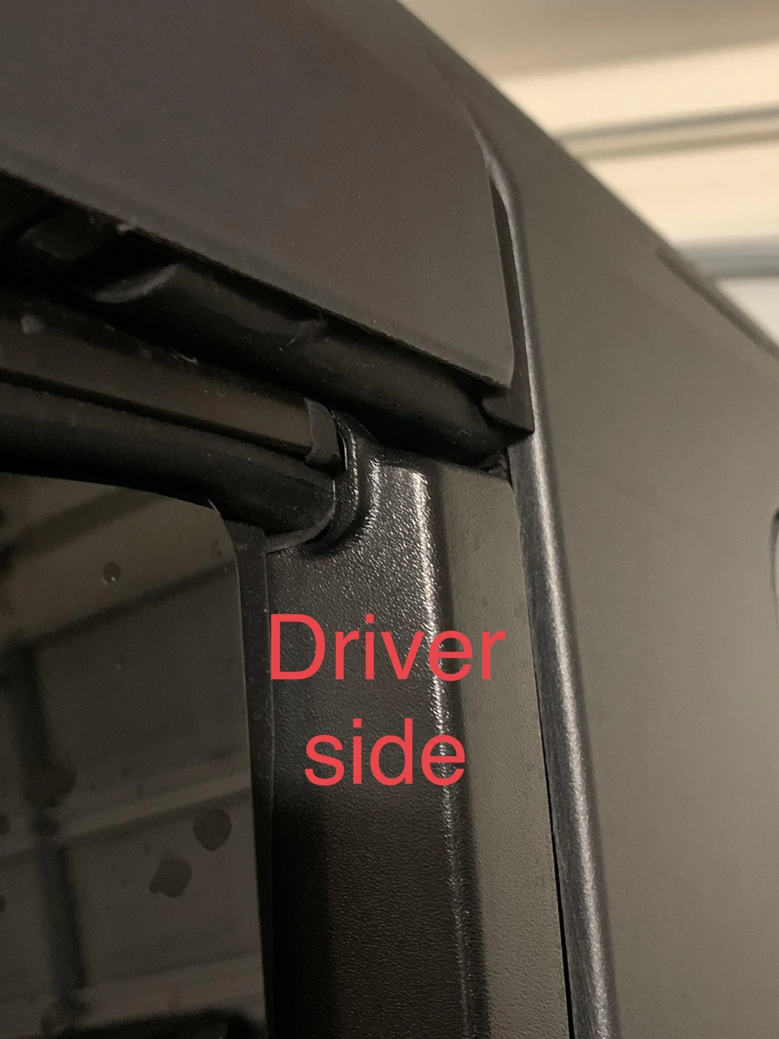

Hey everyone! Since receiving our Bronco, I’ve noticed a lot of wind noise on the passenger side. I figured, “it’s a convertible. Expect some wind noise.” But upon checking it out, I noticed that I can see and feel the top of both windows on the passenger side. I checked both windows on the driver side, and they are slightly higher (and I can’t see or feel the top of the window).
I’ve tried the reset, although I know it’s to resolve an issue when the window isn’t going down. I thought I’d still try that, but it didn’t work.
It’s almost like the glass needs to come up about 1/16-1/8 of an inch more. Also, the glass is level and doesn’t seem misaligned.
Has anyone had this problem? I’d hate to have to take it to the dealership, who is a three hour drive from me.
*Edit-I just figured it out. The seal on the passenger side sits higher than the seal on the driver side, causing there to be a slight gap between the window and seal. Now..how to fix it.

You can go to the dealer and compare yours to one on the lot. If they are different you can I use this as a reason for a warranty repair.
If only there were Broncos on the lot to compare to! 😆
But even like that, I know they are too low, because I can see the top of them. Also, they are lower than both windows on the driver side. 😕
