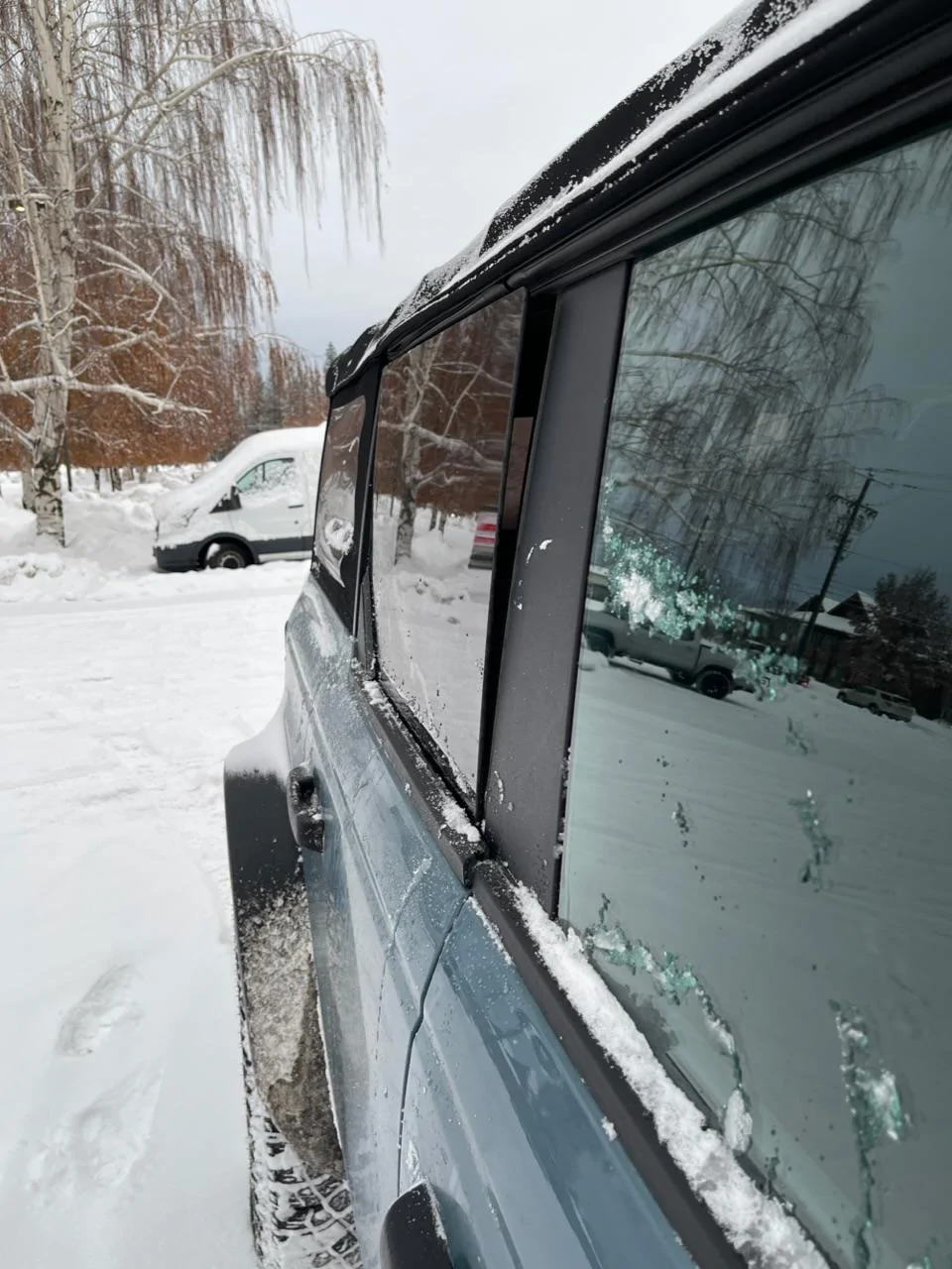

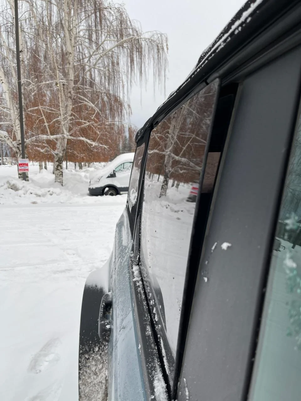

Either things break at -4°, or someone tried to pry their way into my Bronco last night. I’m leaning towards the latter since I was parked at a hotel last night.
The window seems to roll up fine until the last 20% or so, then it appears to “pop out” of its channel and ends up looking like this. I can push inward on the window as it’s rolling up and that allows it to close properly.
So what do we think? Did something break? Will this fix itself when I drive somewhere warmer? Can I fix this myself somehow? Really hoping warranty covers this if something did indeed break.

My only concern is why go through that window on a soft top. You can just take of a side window and maybe open a door somehow. Have not tried it but I have a soft top and have always been concerned about bad people. Anyways, could be something fell out of alignment on the actual tracks for the window. I would take it to a dealer.... warranties are a great thing.

Trim piece along bottom on the window isnt alligned with the front window trim piece. Another symptom instead of a cause
