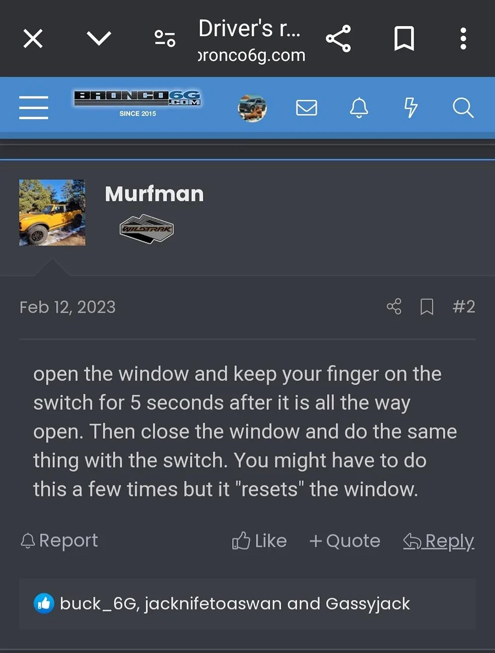

I remembered there was a thread about it, looked it up and then took a screenshot to save it to my phone in case it ever happened again.
It did, one more time.
I think it's from holding the window buttons down too long after they were done, in my case because I wasn't paying attention.
