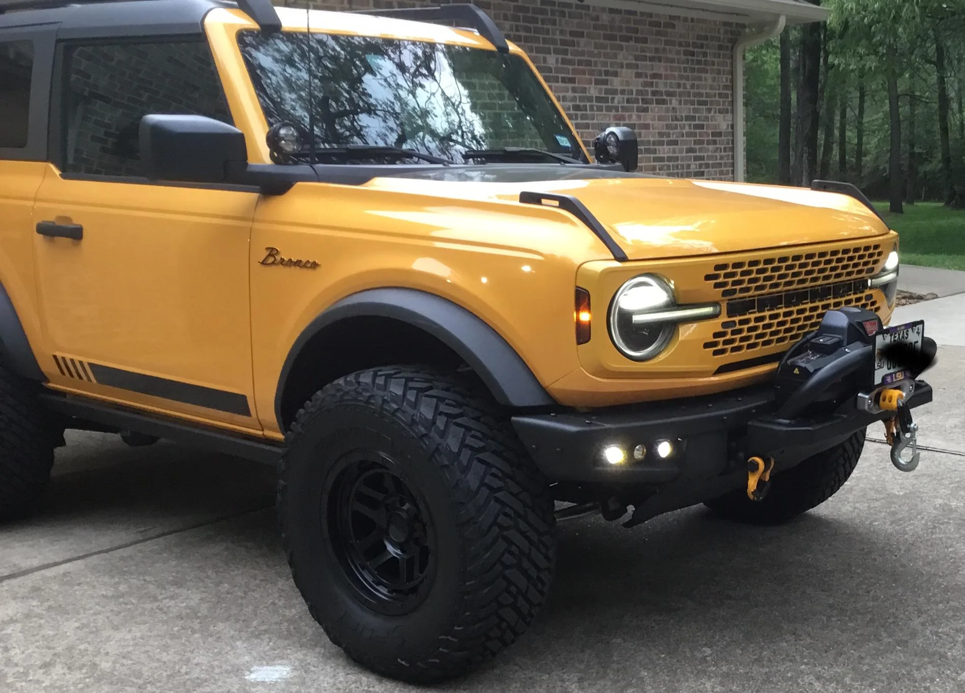

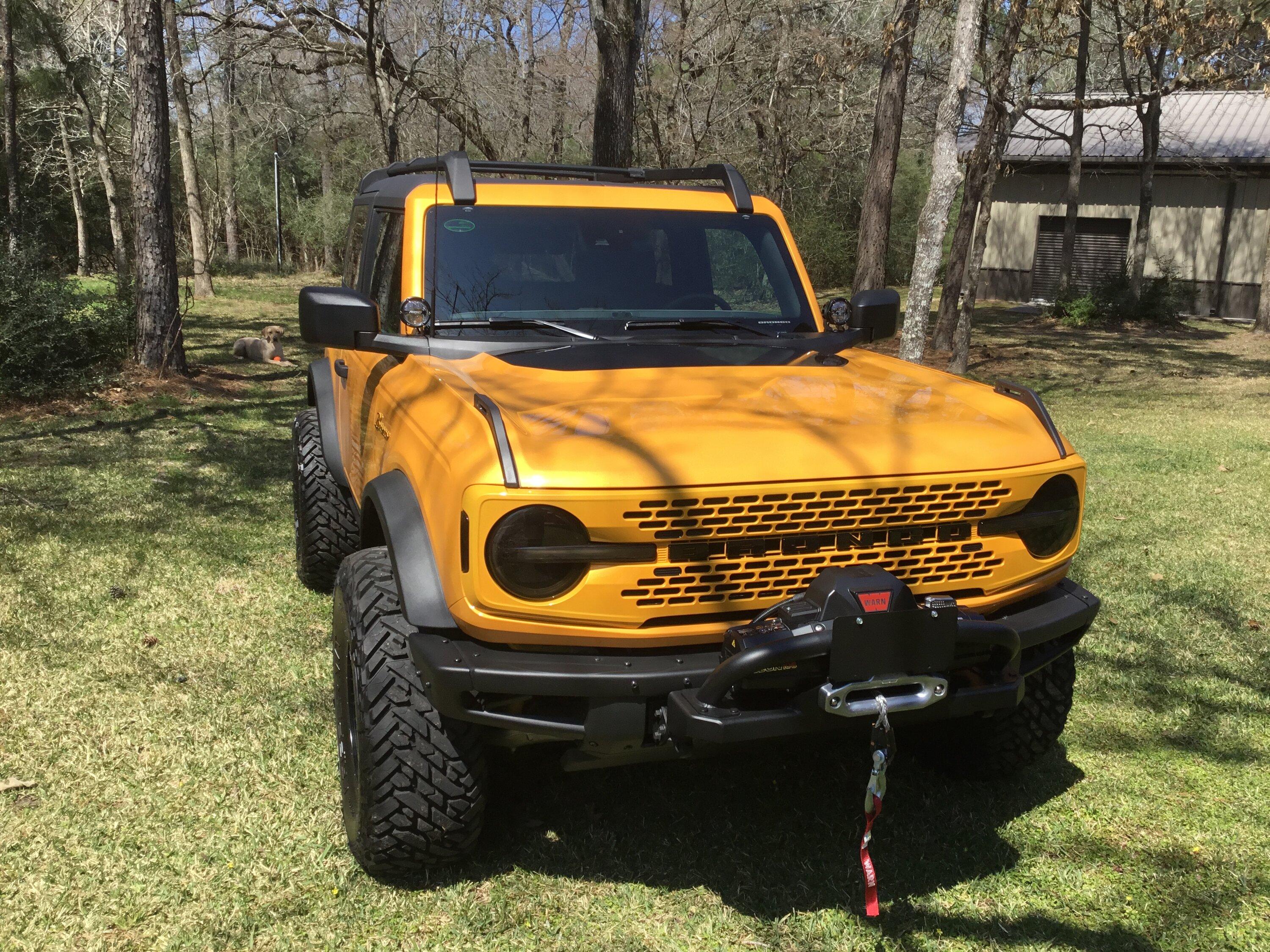

Winch that fits modular bumper without an issue?
Hemisfear
Bronco Bob
Aug 21, 2020
1,818
2,082
Lotusland
2014 Focus ST
Warn/China-Have since installed the camera relocation, fog mounts unaffected.
Ford Bronco Winch that fits modular bumper without an issue? bronco
Ford Bronco Winch that fits modular bumper without an issue? bronco3

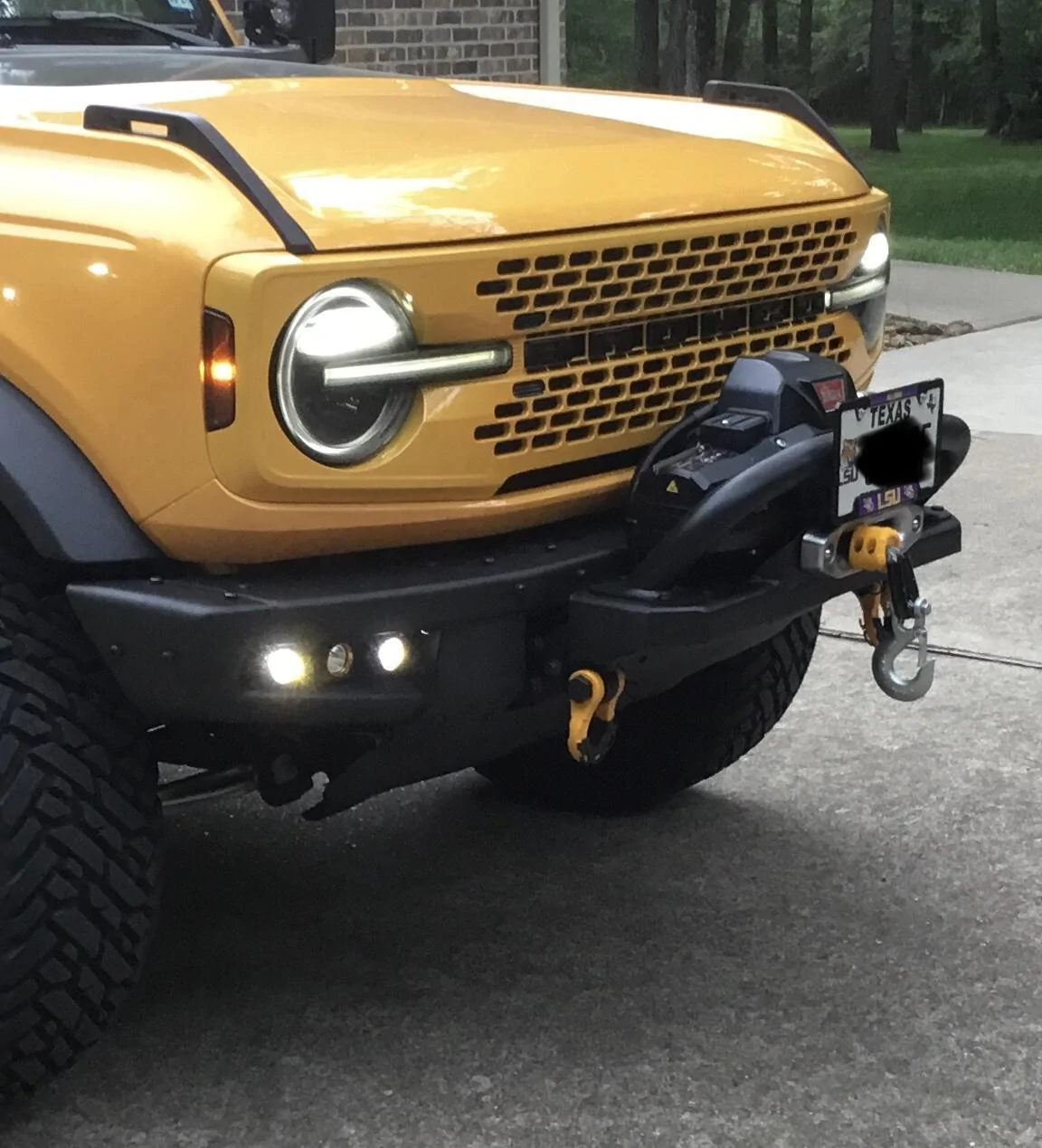

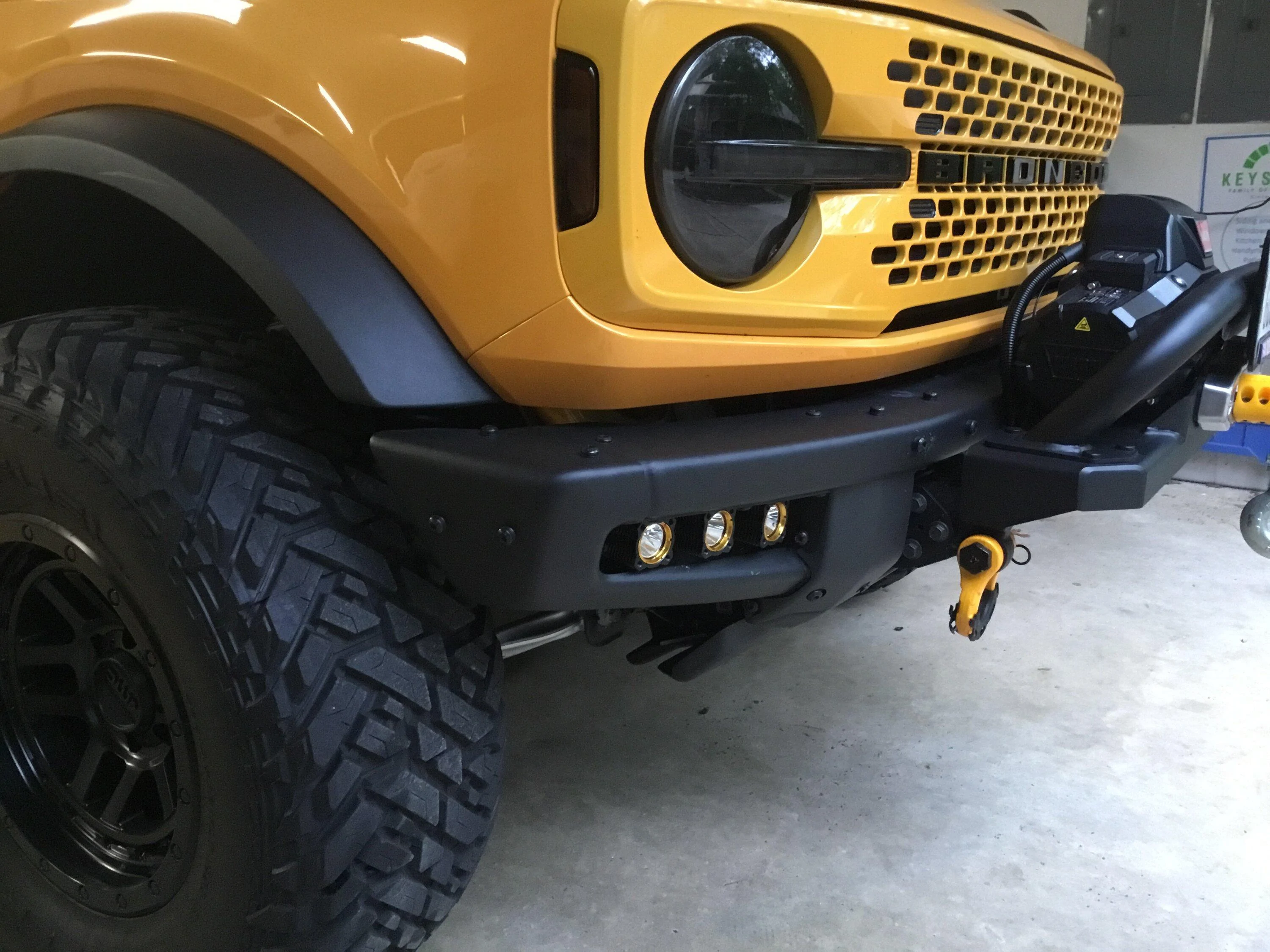

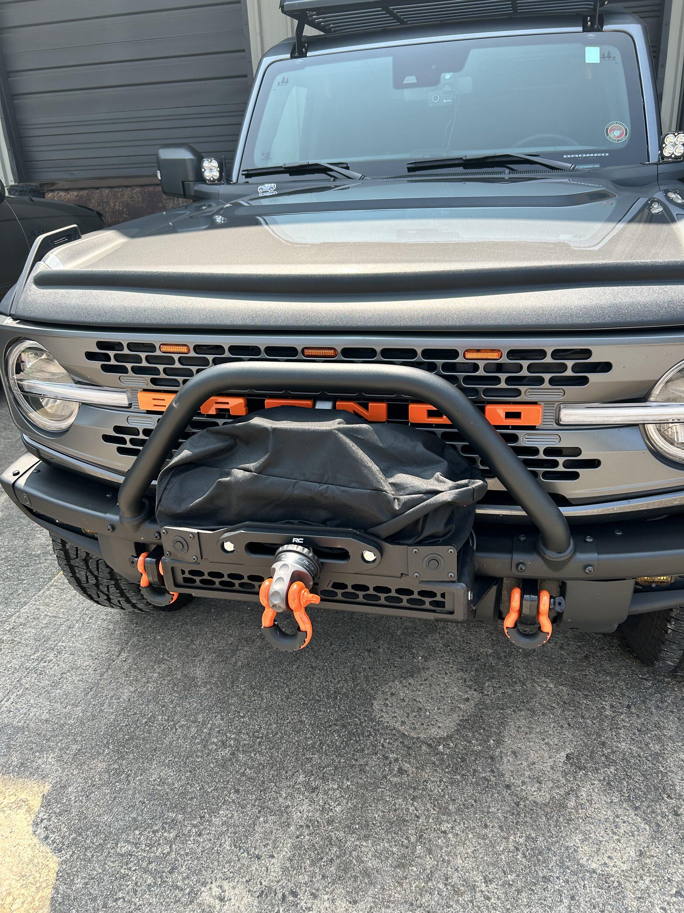

I know you don't have this any longer but do you remember if there was any gap where the arrows are? I have a SPV light mount bracket there, its thin but wasn't sure if the winch mount/bracket had a small space or not.
Sorry I don’t remember specifically, but in these additional pictures I dug up it does look like there is a gap.

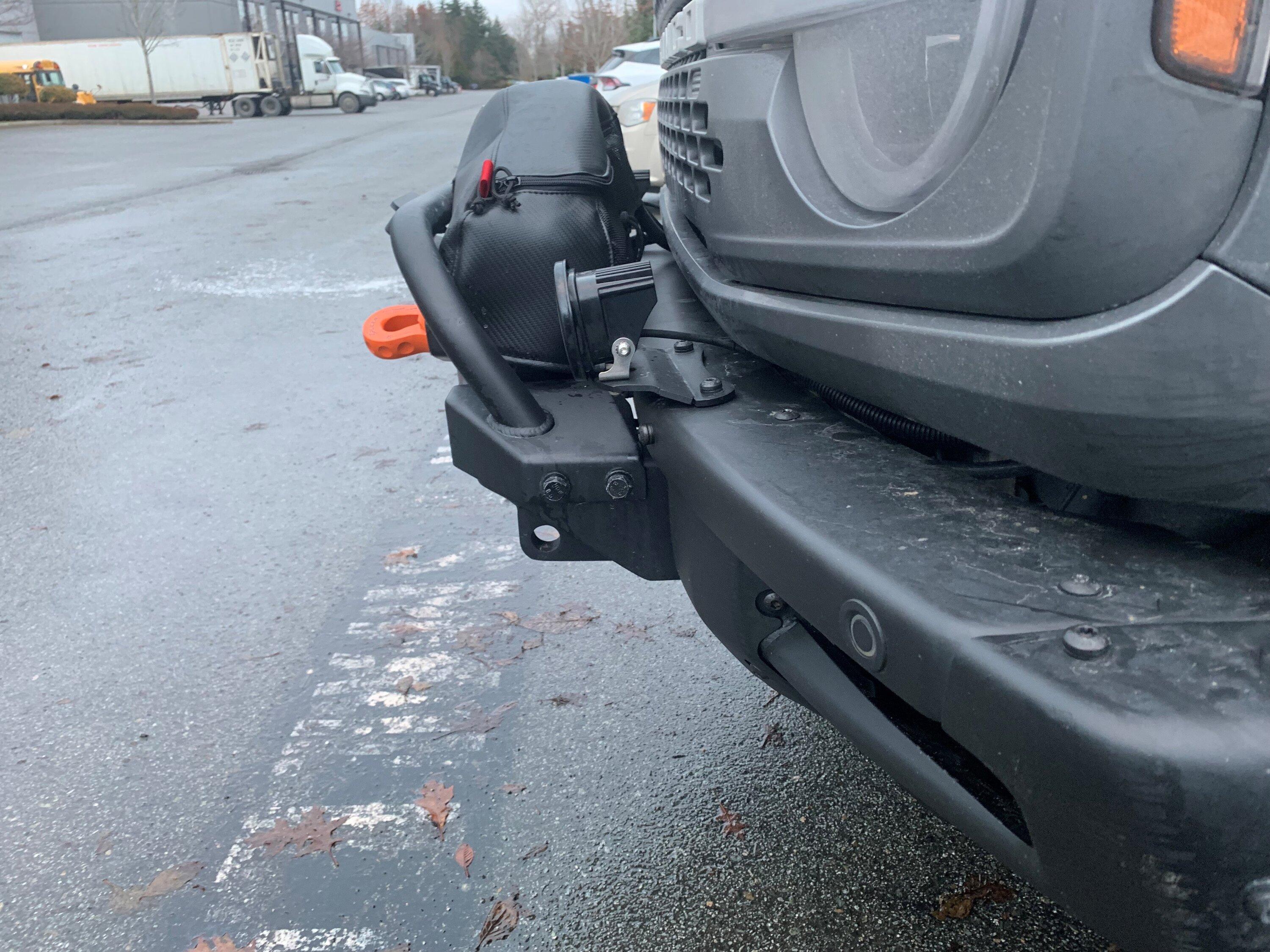

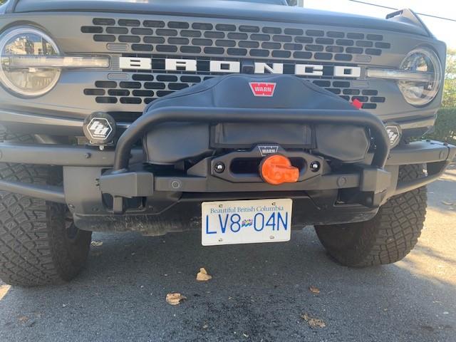

Another option is the Rough Country Hidden Winch on the modular bumper. It works really well, the downside is the engage/disengage lever, which I developed a fix for.
What was your solution? Any pictures?

Here is the title: DIY - remote engage/disengage Rough Country Hidden Winch lever
Bellime
Keith
Nov 12, 2022
68
721
652
2022 Ford Bronco
I have not been able to figure out how to reference/link to the original post, but while this solution is a hack it has worked like a charm since it was install.
