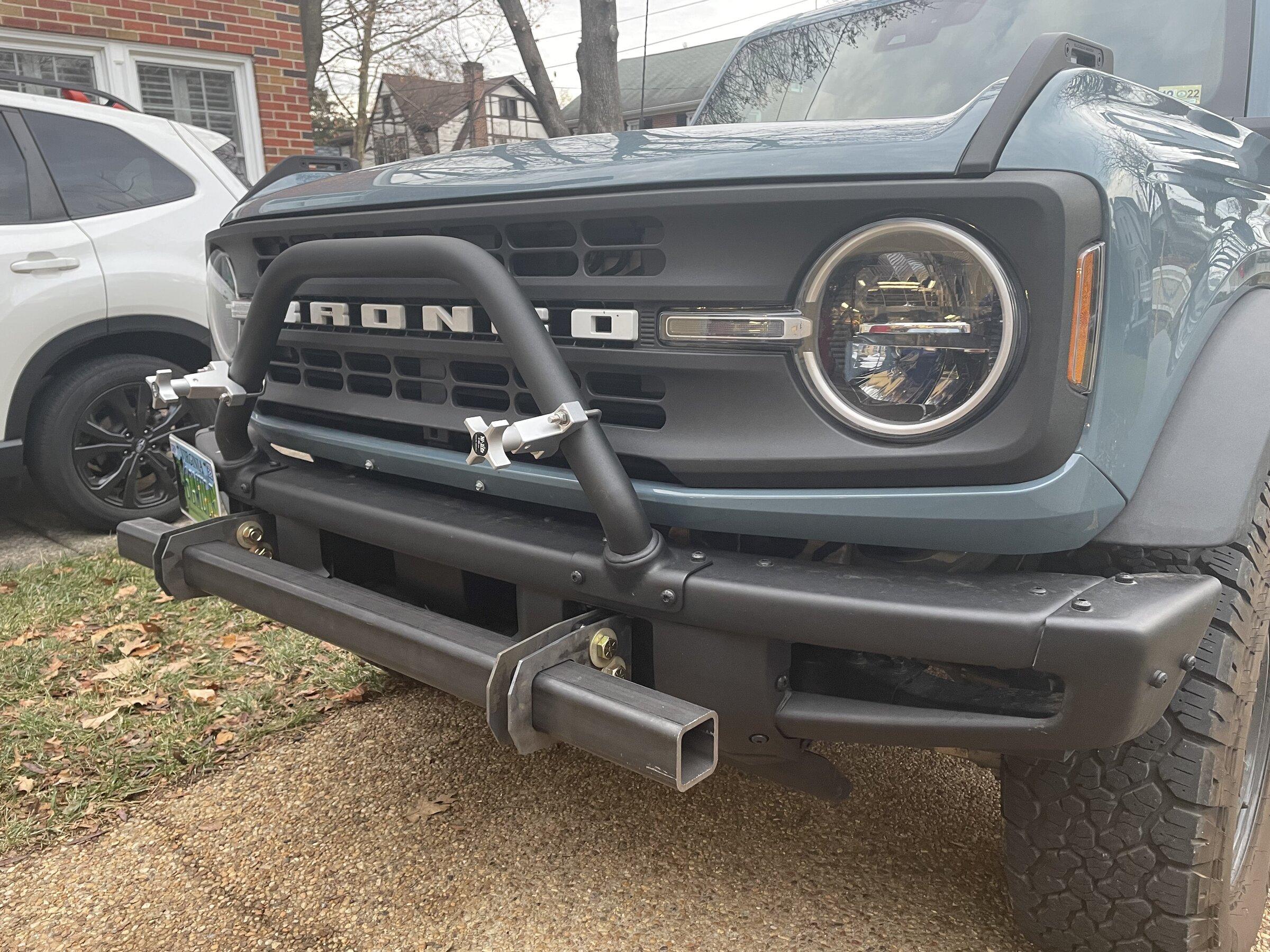

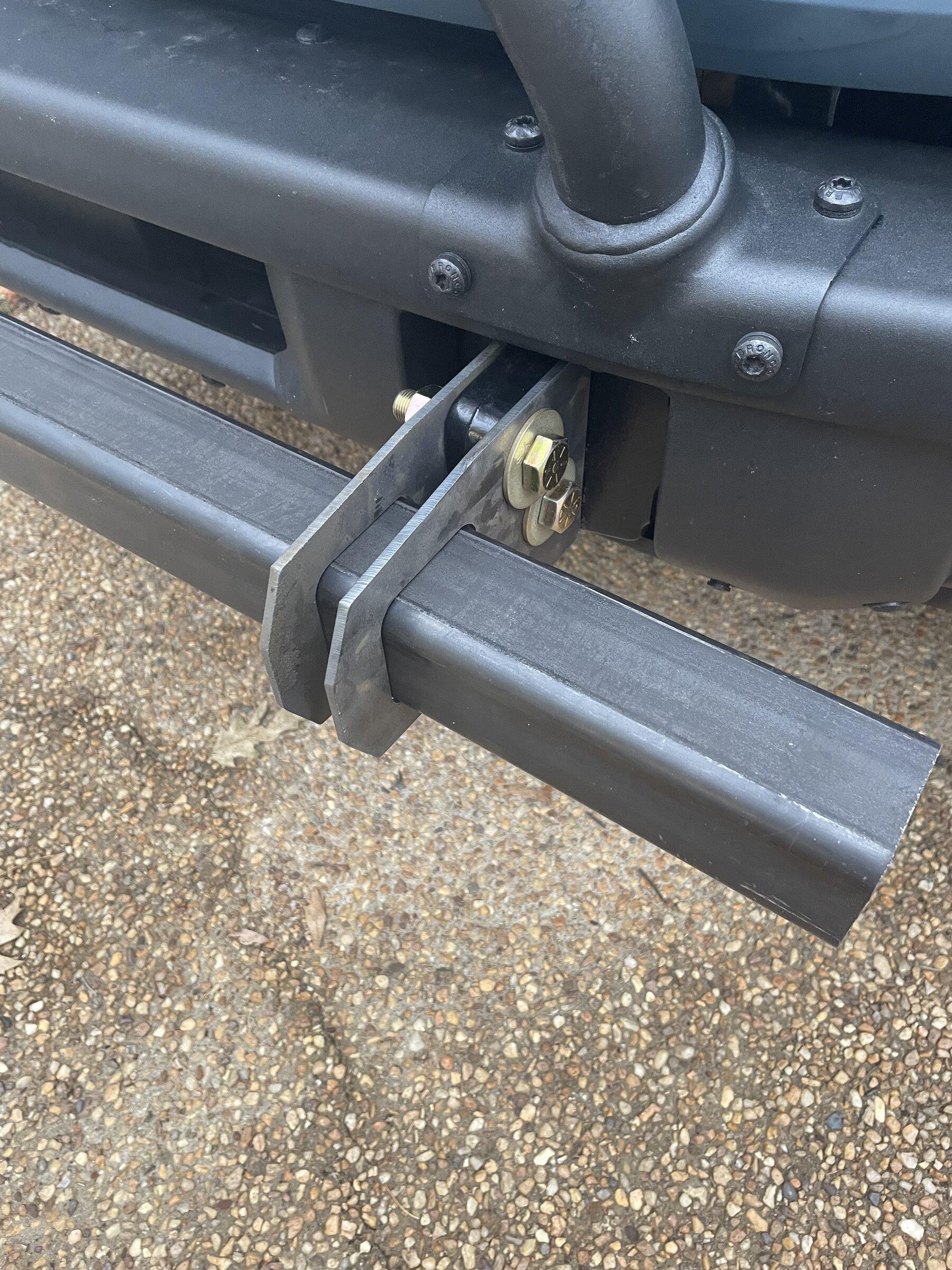

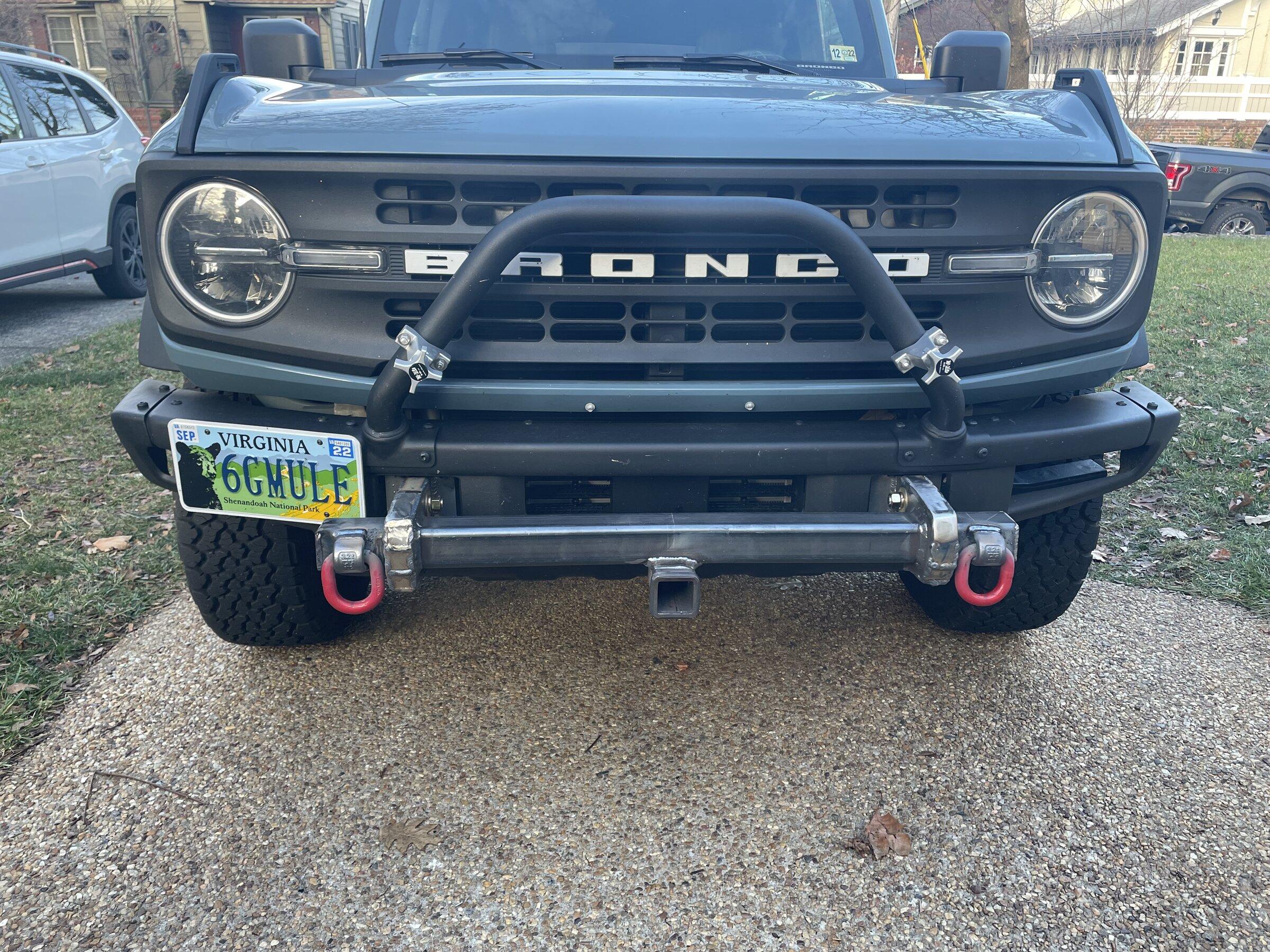

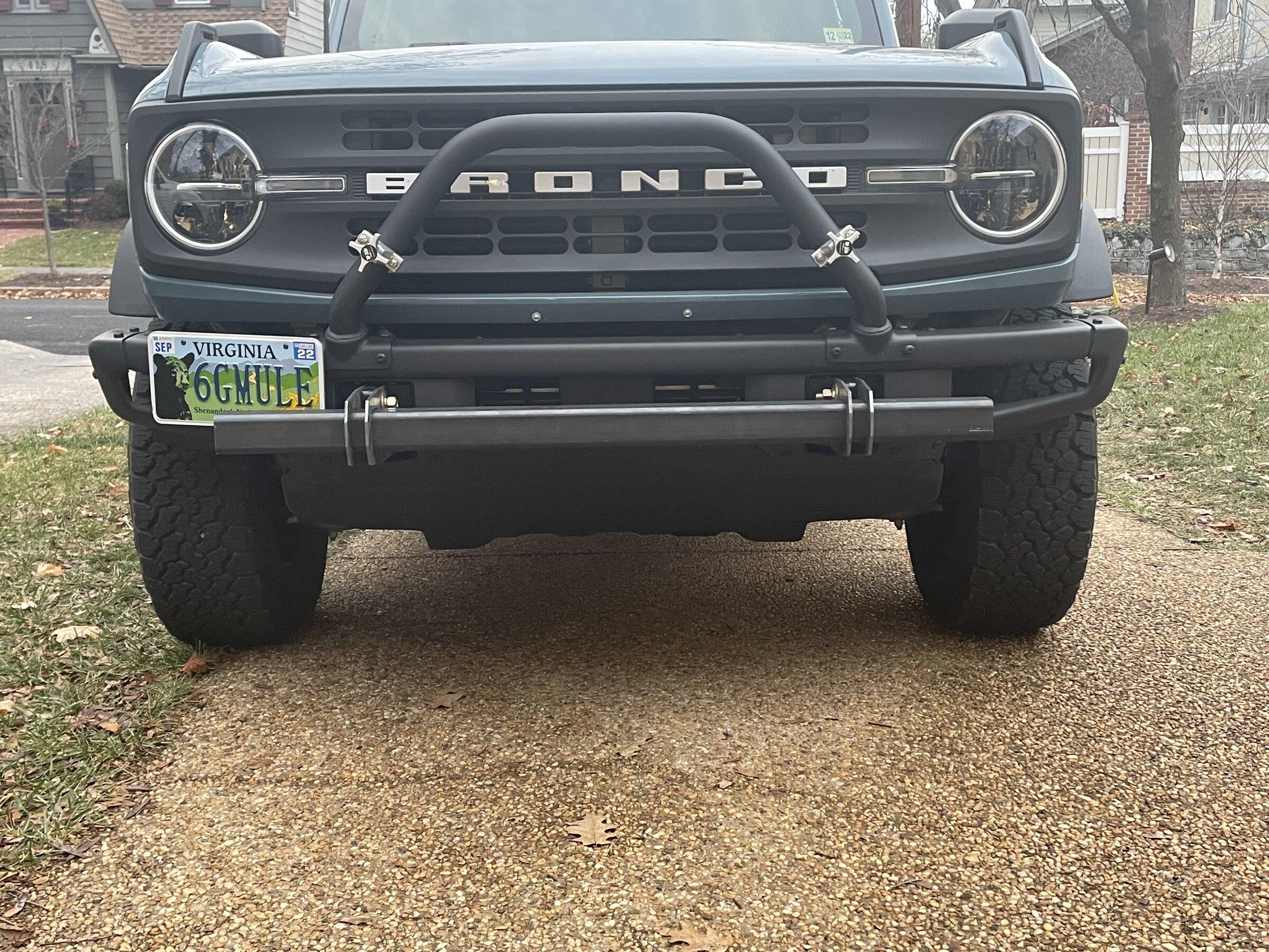

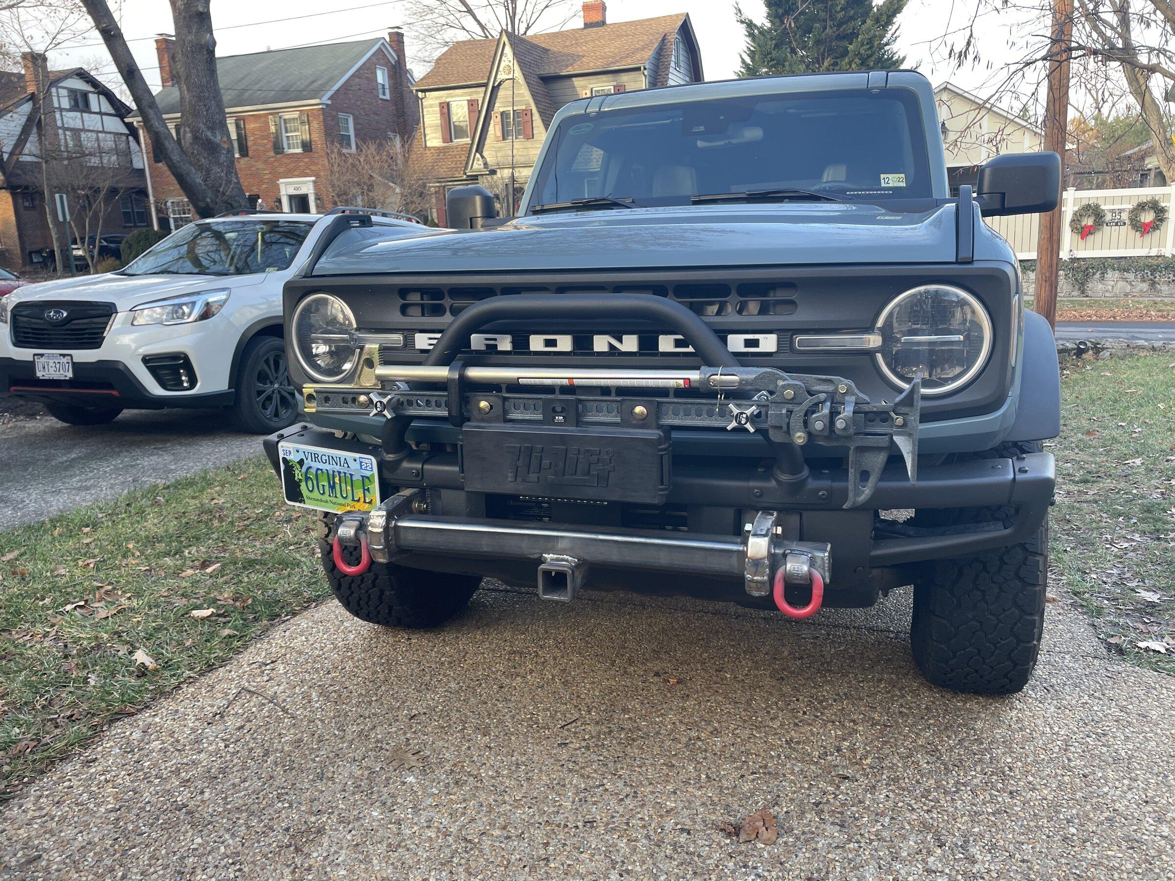

Sooo…lots off different options out there, and who likes to ride around with the winch mounted upfront all the time?! Working on a receiver for the front of the modular bumper…
Ford Bronco Winch on modular bumper (Badlands) F986F09B-6CB8-4241-B75E-163D1019D821
Ford Bronco Winch on modular bumper (Badlands) BE024B47-DCB0-4355-A15F-B3B8EDE47472
Ford Bronco Winch on modular bumper (Badlands) 537B6D22-35FA-495B-BBE0-6CF1DA967AFD
