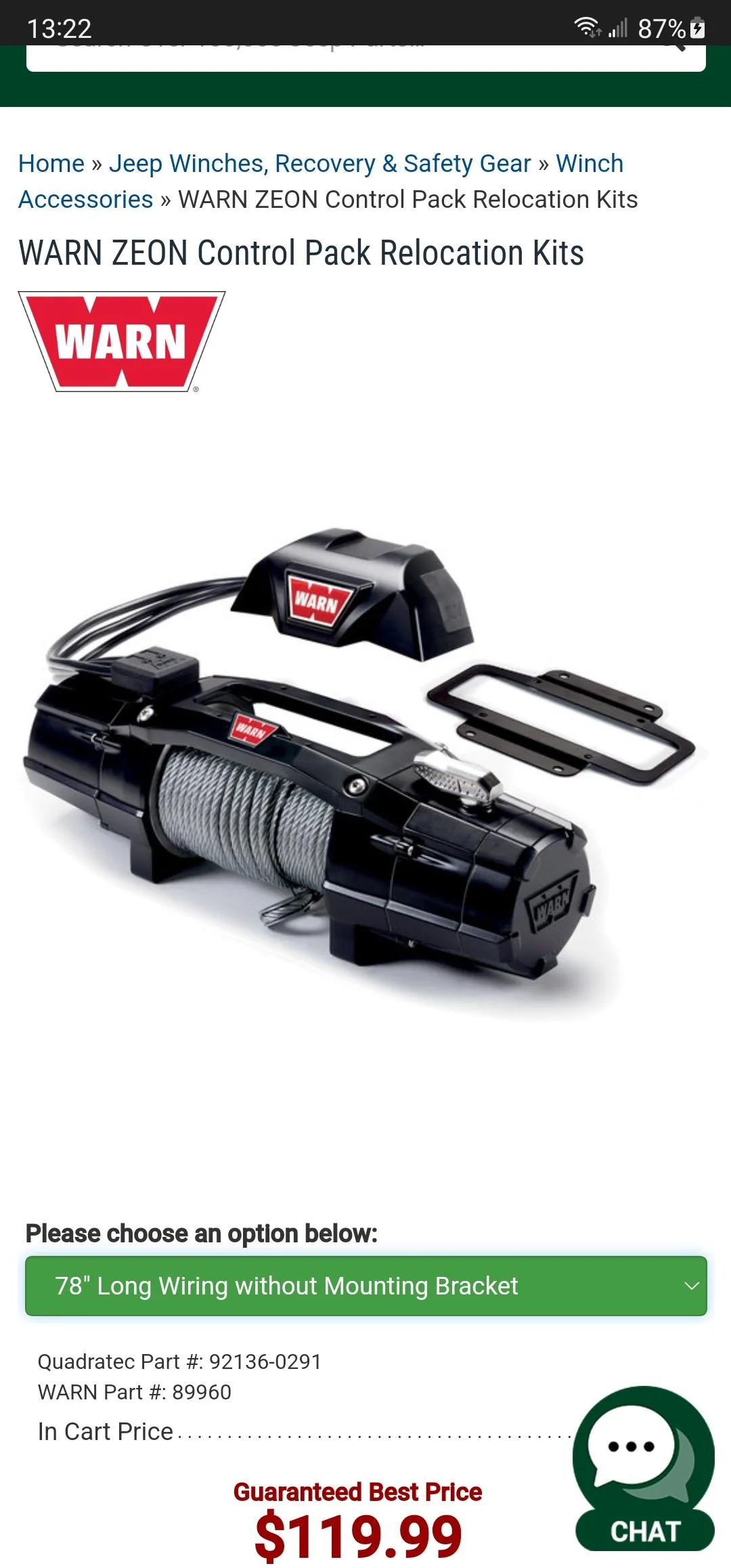

Are you able to explain that at all? Connect the two what?
Is there a reason you need a full blown fab shop? Wondering if a buddy and I can make it work with more typical tools, or if you literally had something machined out. We have welders, torches, grinders, etc
Thanks. Yeah, but even with the wireless remote the Warn still has a hump on top. The RC, while not my favorite, has the removable control box and has no hump on top at that point allowing more space for the relocation. Haven't seen another winch like that (I'm sure there is) also, I don't plan to really wheel the Bronco, just wanted this as a backup for fun, mainly use the Gladiator.
Like this?

They have a control pack relocation but again, more $$ 👀👀👀

Based on that pic of the Warn, you can separate and use that if it fits in the space width wise and you'll need to find a location for the top half of the winch.

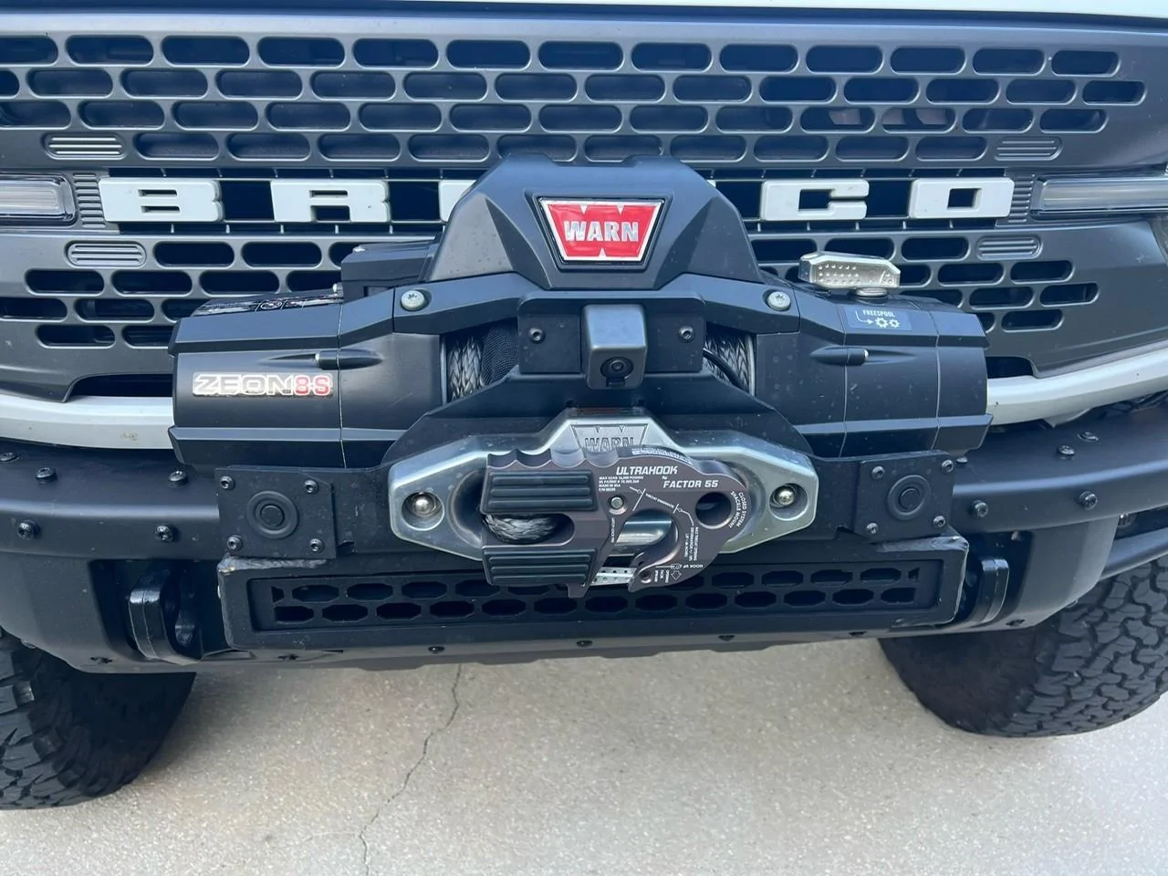

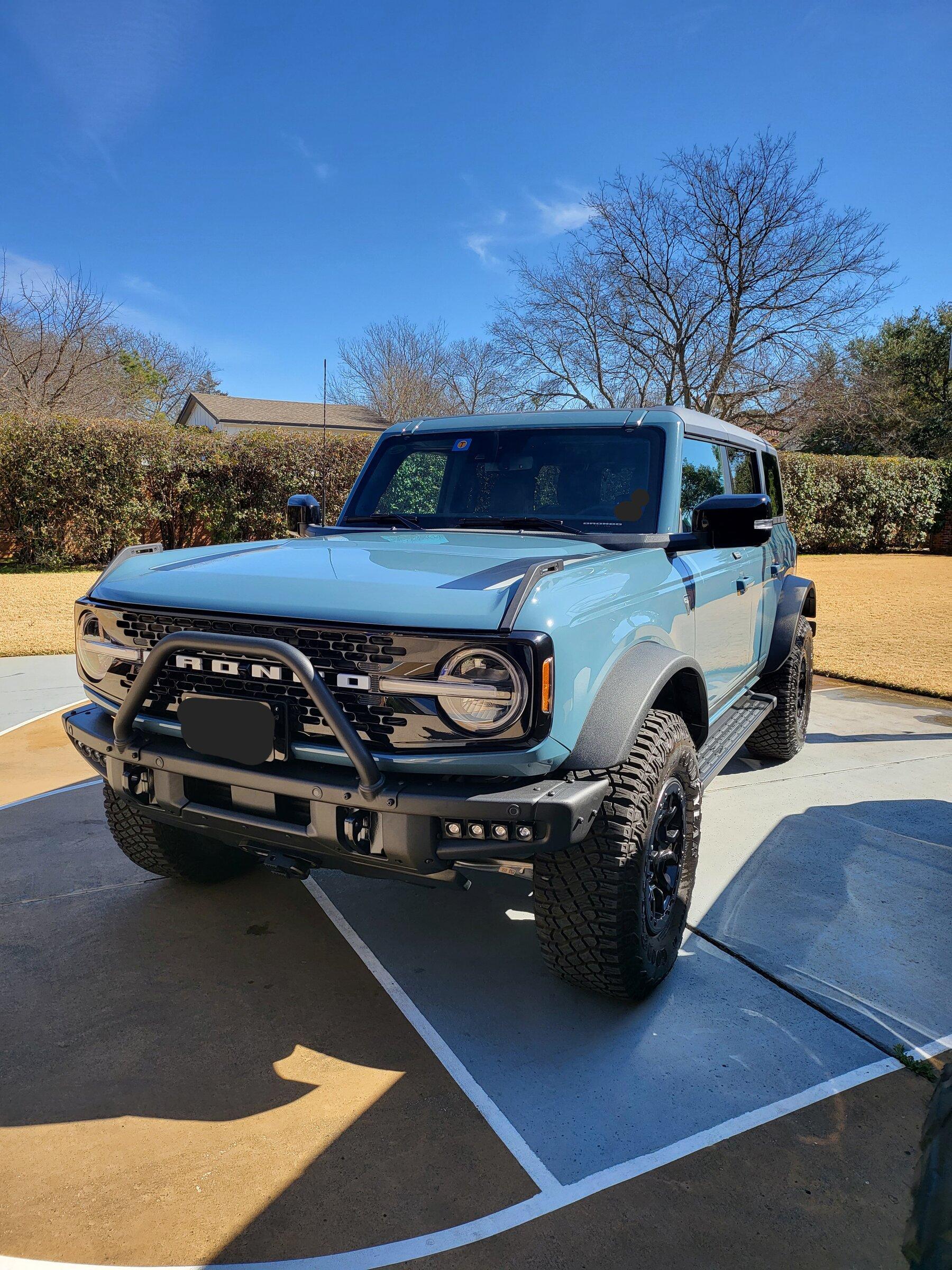

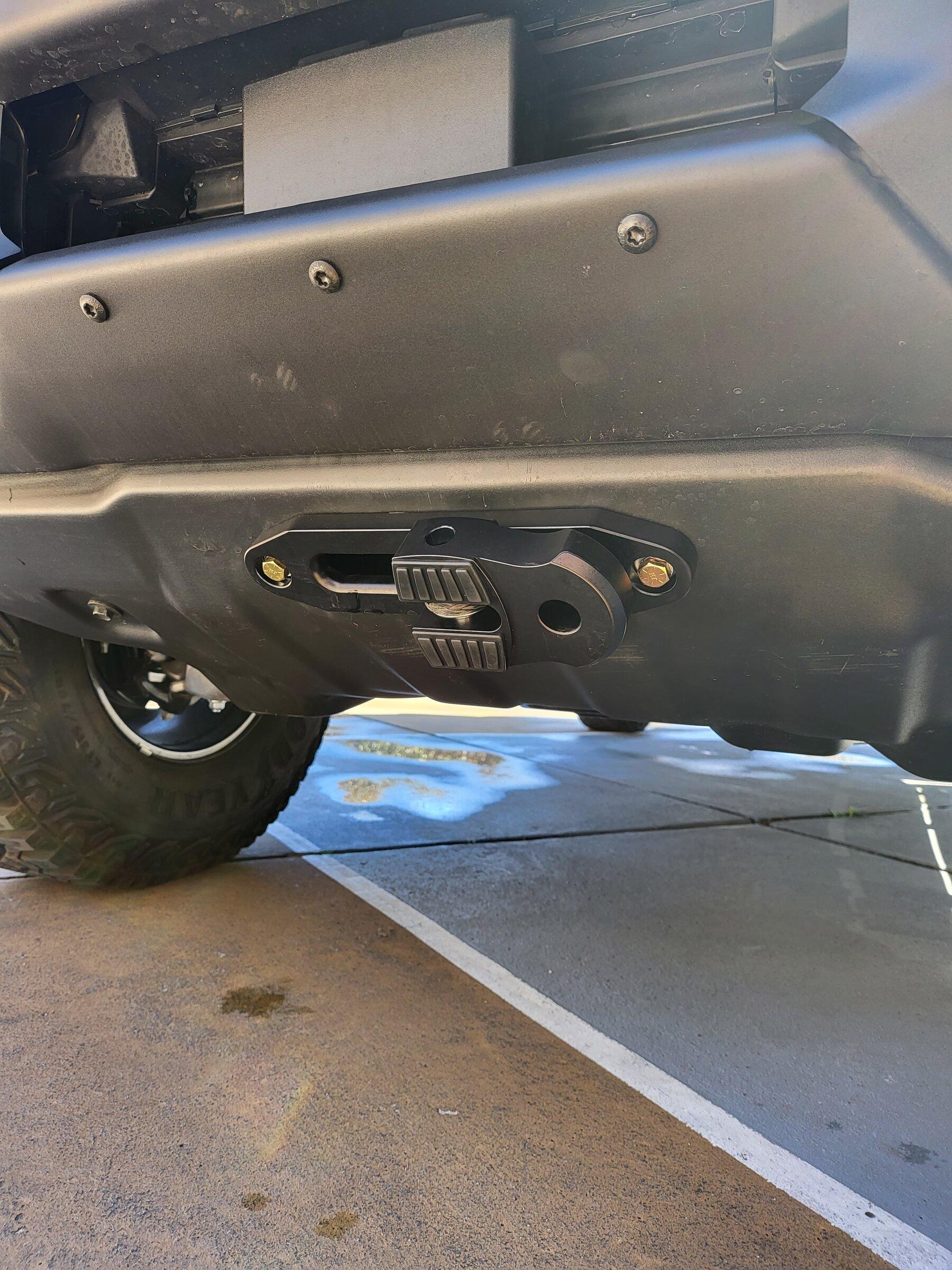

Rough Country Modular Bumper Winch mount; JCR front camera mount. All radar sensors remain functional. Factor 55 winch hook. Warn Zeon 8S.
Ford Bronco Winch on modular bumper (Badlands) Winch pictur
Ford Bronco Winch on modular bumper (Badlands) Bronco front
