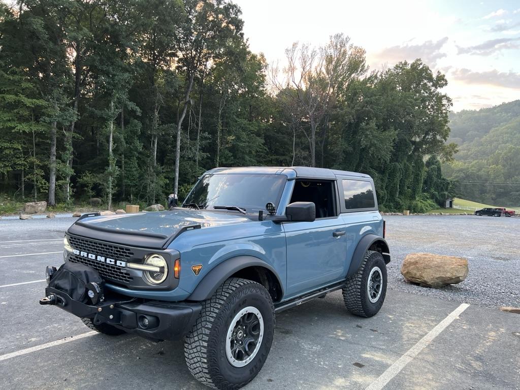

I have the JCR winch mount. I was looking at the RC hidden mount at first.
I went with the JCR because of where I go off roading. Along with the instal. If you have a 2.7 engine, the hidden winch requires you to move an intercooler and a few lines. The JCR requires you to cut the plastic piece that covers the bolts.

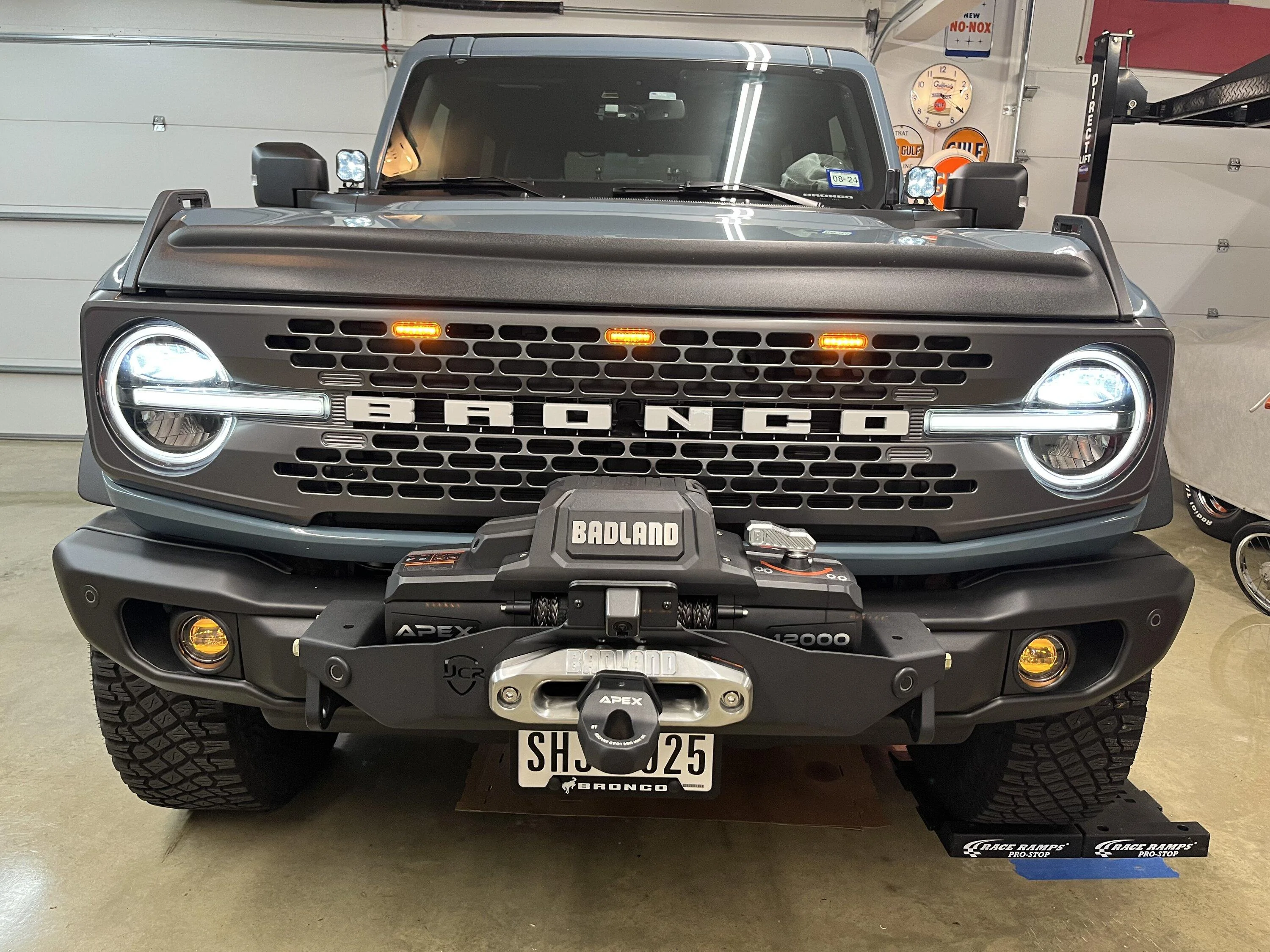

After a lot of research, I went with JCR as well with a Badland 12K winch. ‘22 Badlands, 2.7, SAS and LUX. I just had to trim the plastic covers slightly and extended the sensor wires.

Thanks, High Velocity! I like the look! Your setup looks great. Does $700 sound expensive for a winch mount?
Educate me on why you opted for this solution vs. buying an after-market bumper that may have had a winch plate included? I just want to learn!
I got mine on sale for around $550, however I would have paid full price if that were the only option.
I don't like aftermarket bumpers, especially anything that would be around the same cost of this. I find them cumbersome, unnecessary and mostly unsightly. I'm not a hard-core rock crawler though, so I don't get the value out of them as some others do.
I prefer to patronize small, US manufacturers that put out consistently good products. JCR fits that.
The winch plate fits great, is built extremely well and I feel it can take a frontal impact much better than some of the other options presented here.

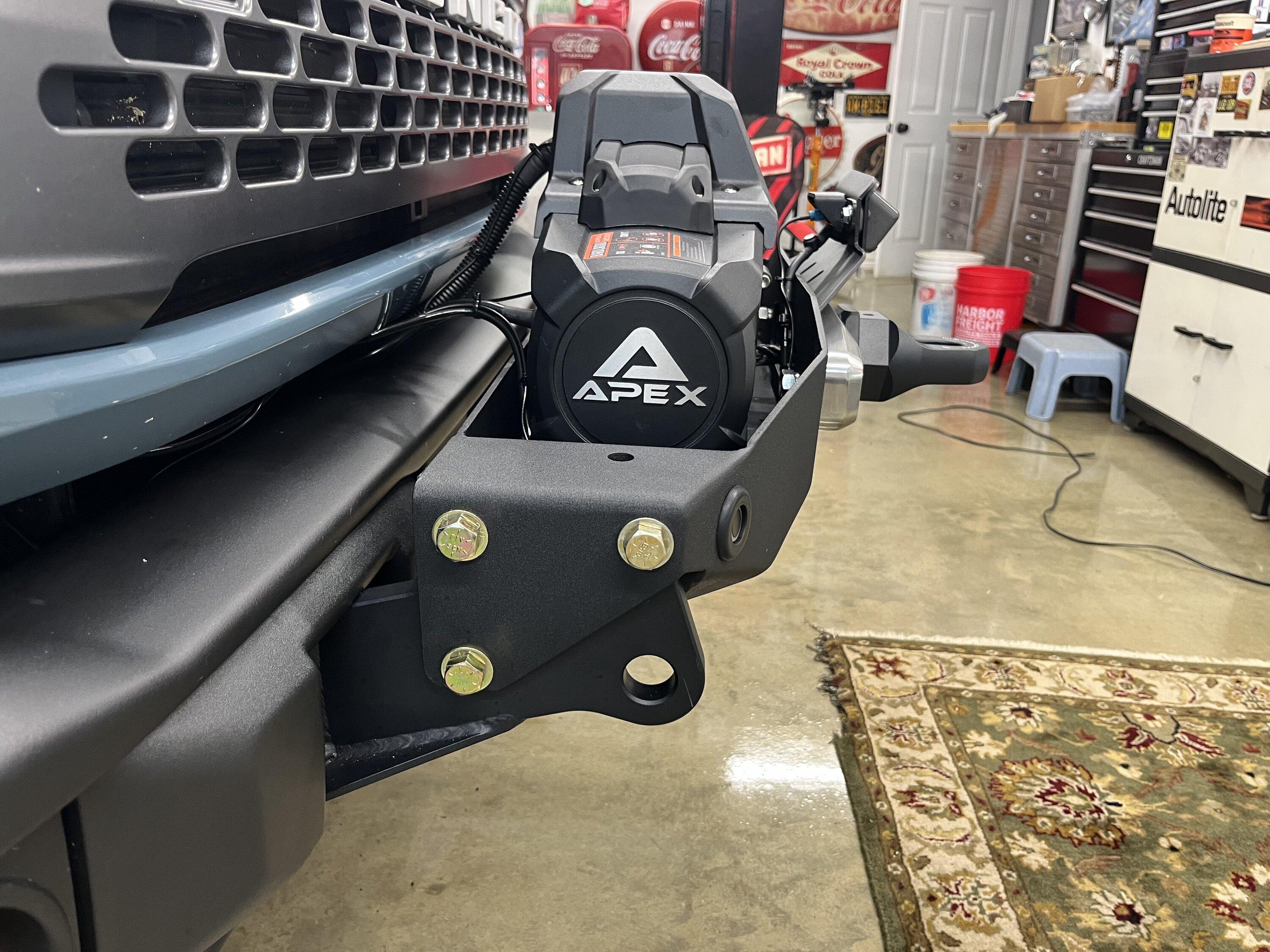

Got a hidden stuffed away on mine!
Ford Bronco Winch on a Capable Bumper:  Possible? IMG_2322
Good looking rig and nice pic overall.
When I zoomed in to look at your winch mount it looks like there may be rust developing. Is that the case, or rust colored mud?
