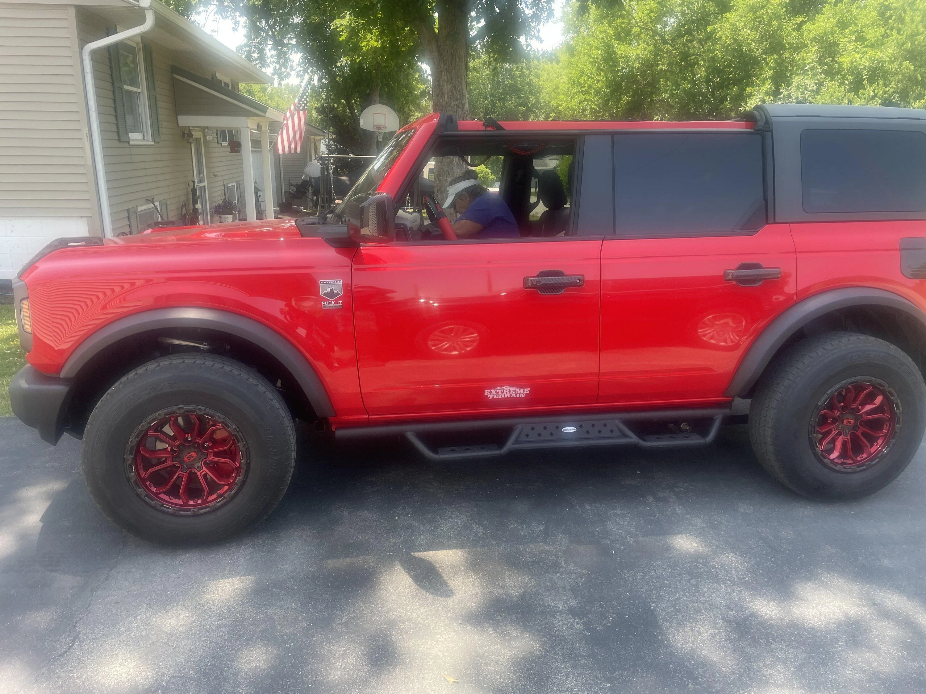

I Seen A Video of A bronco with A winch bumper installed using the winch and I seen the bumper get ripped right off the front end of the bronco frame and all.. That changed my mind on one of those fast. Cheap frame comes to mind. Notice the special edition (blow up)

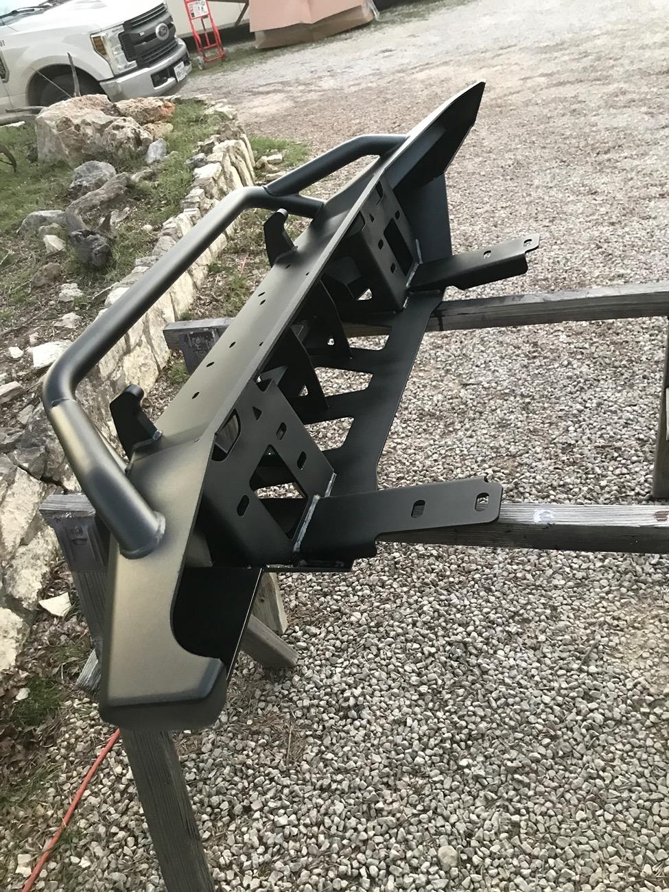

I have the LOD frame horn strengthening brackets and a Fab Fours bumper that has an extra plate that goes under the frame that adds 4 extra attachment bolts.
