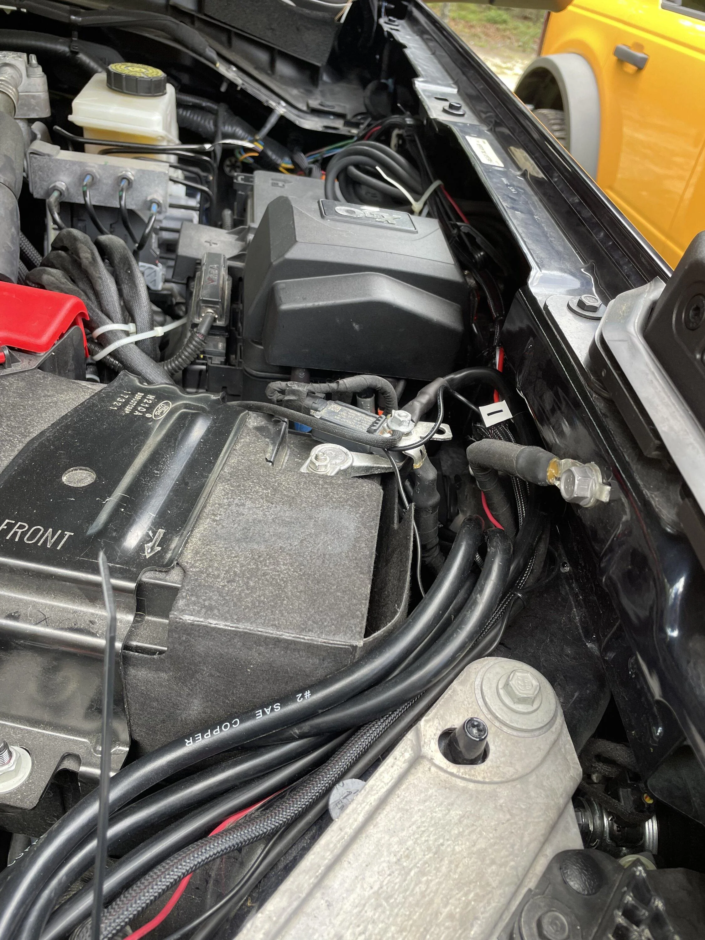

Anybody with a 2.7 do a winch control relocation under the hood somewhere? If so, where?? I have the Warn Evo 10 and a BAMF bumper and was gonna relocate the winch controls under the hood but its stuffed with so much BS Im struggling to find a spot.

Also on the KR Off-road mount you can drill some holes on the support bracket coming off the coil bucket and mount the controller on it between the fender liner and the bracket if you want to be able to have the top available for an air compressor.
