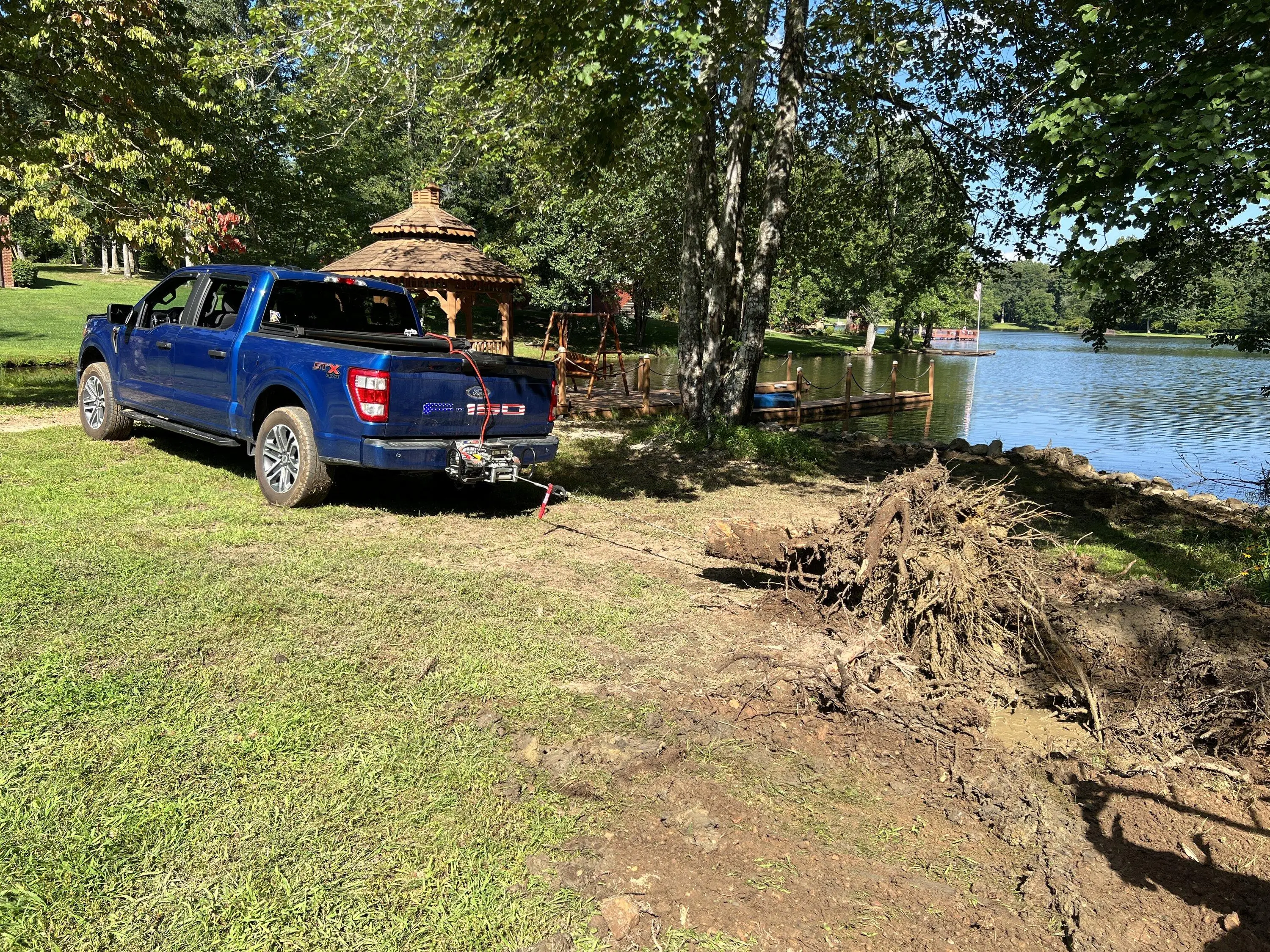

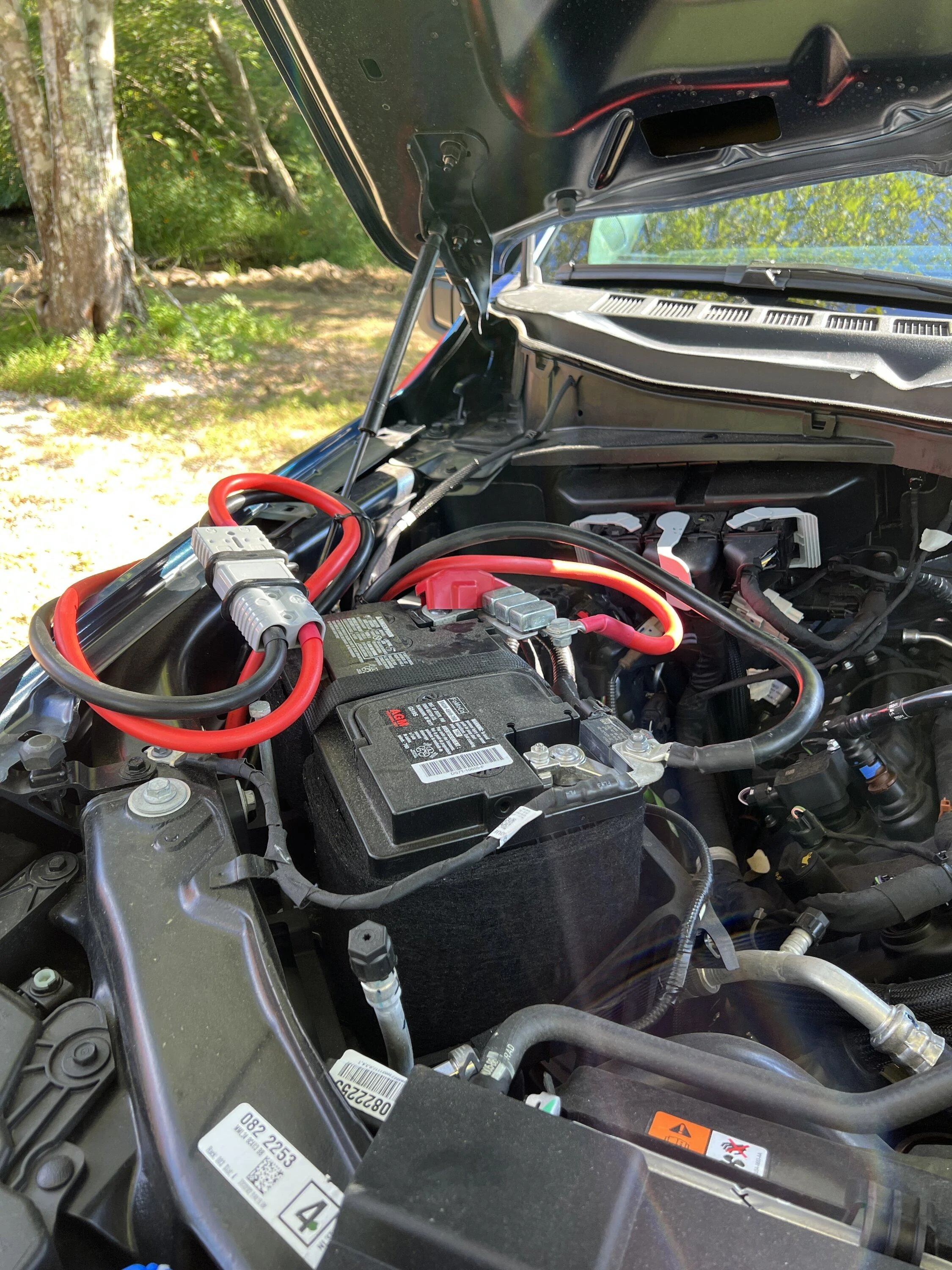

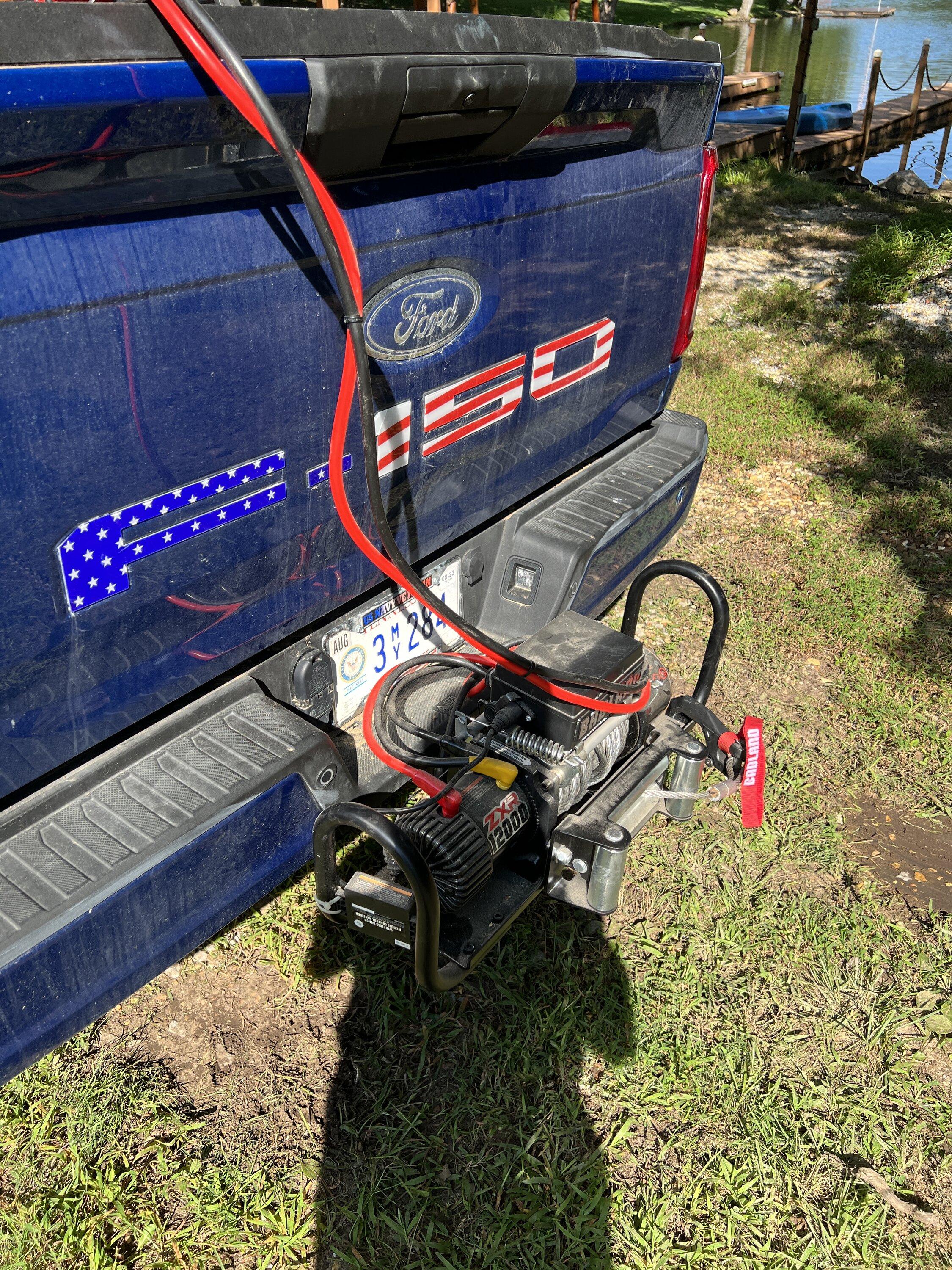

Here is the install on my F150. On the Bronco I plan on doing the same thing. That way I can use the jumper cables on either one with out swapping things around. I also have the stuff to put a 50 amp Anderson connector under the hood to run an air compressor. Stay tuned

Great, thanks. I want the Andersen connector outside for external jumping the Bronco if I can't get into it to open the hood (I'm assuming that you can't open the doors if the windows don't move even if you use the key).
I don't have a winch but I do have a Viair compressor that needs 30 amps that I plan to use this connection for. I'm planning to put a cutoff switch in the positive line. Makes it a little safer to jump another battery, turn the cutoff switch off for hookup, on to jump, off to disconnect. Same with turning anything else on or off. I've also been wondering if there should be a breaker in-line with Anderson connector and if so, what amperage to allow you to jump a car but protect in case of a short.
I do like your winch mount. Do you have a receiver on the front for it as well?
