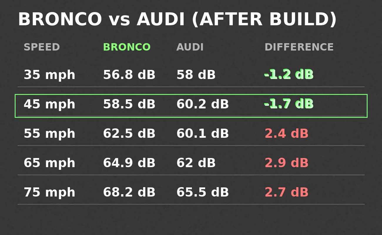

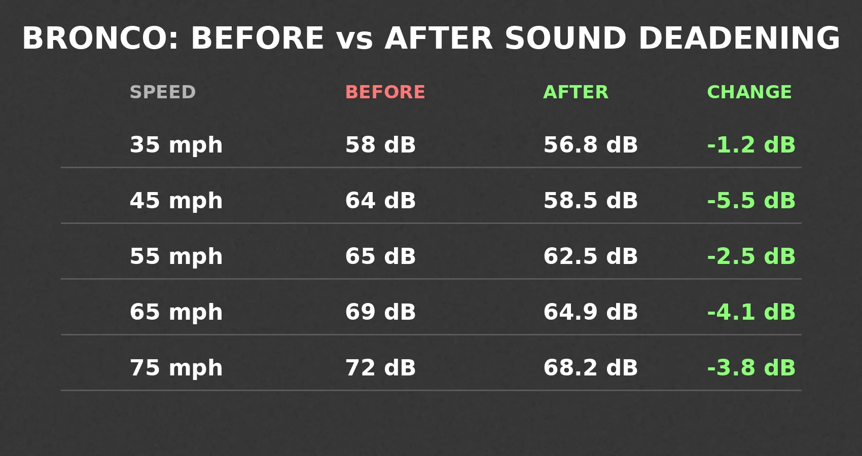

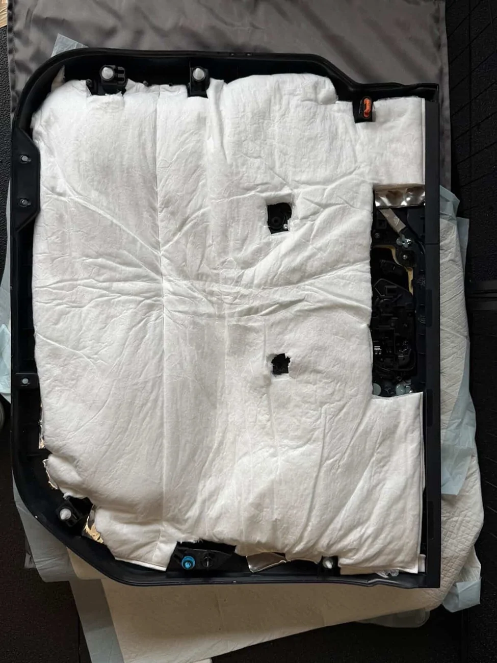

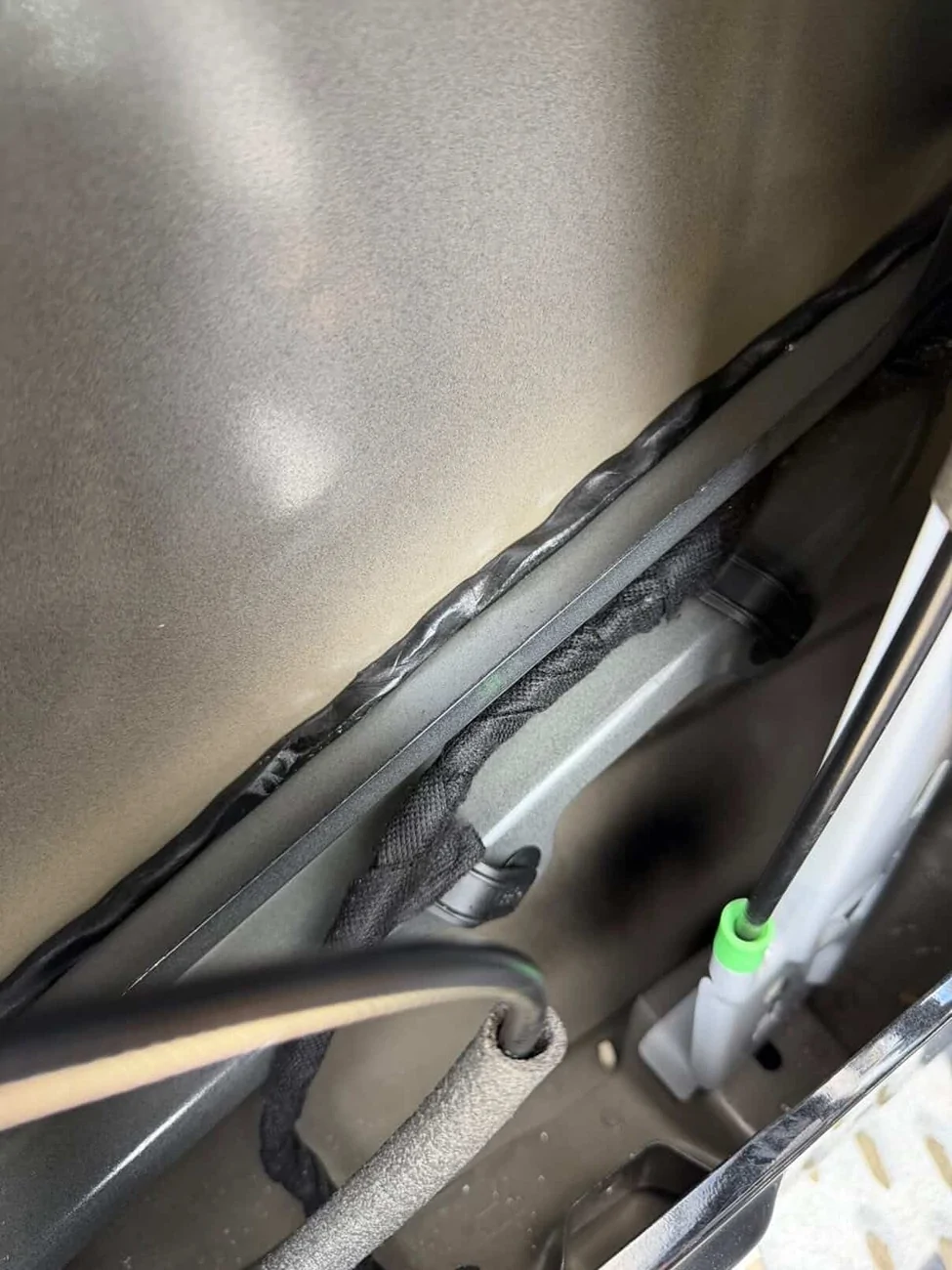

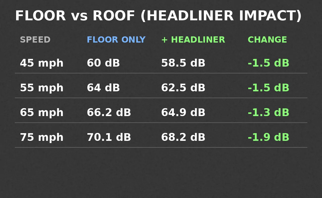

I’ve done extensive db testing and deadening. Through out my bronco. The sound in the bronco is actually coming from the floor and bounces off the plastic, windows, and fiberglass. I added kilomat, second skin closed cell foam, turn off-road liner and carpet. All that work lowered if 1.5-2 db. The carpet or deadening even oem works to capture the noise in the cabin. The factory hardtop is not super noisy actually well made.
Perhaps the reverb is what you’re actually hearing.
I will attach some before and after deadening along with the headliner difference. Your results should be less than mine. I have loud upper control arms that really pump noise. The doors need sound proofing too. They are thin to win …. I have a video I’m finishing up the edit to show what $500 -$1000 worth of sound deadening does.
Also for fun compared to an Audi q7

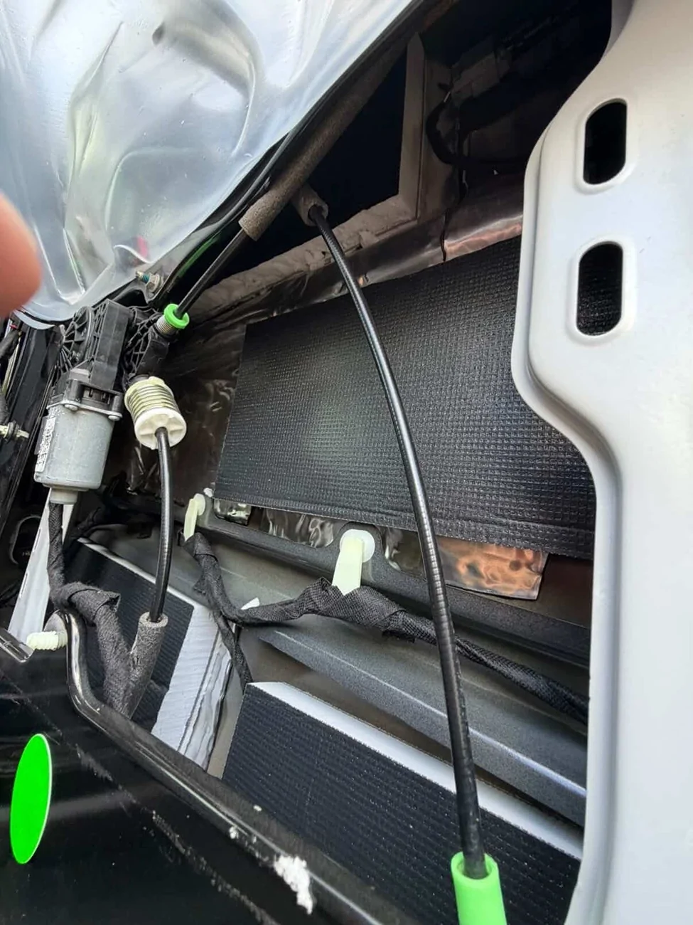

I didn't touch my hardtop but I did multiple stages of Resonix in the rest of my Bronco Raptor. All doors done, all door panels; full cargo area, cargo panels, and firewall
Full resonix treatment- butyl rope to tie the door bars to the outer skin, mega cld tiles, guardian - Hydrophobic Melamine & MLV Automotive & Marine Sound Absorbing Pad and Fiber Mat - Self Adhering Automotive Sound Absorber & Decoupler
