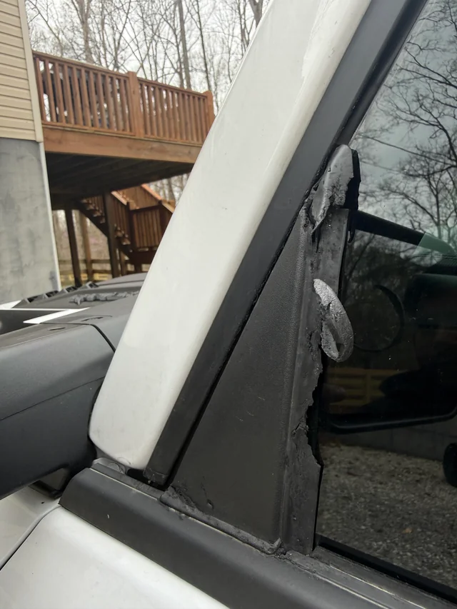

Not my bronco just a picture I found online but is this the piece you are referring to?

Yes that’s piece Brian B is referring to. Look on the inside of window, the edge should be flat, mine had a high spot(crease) that made it not sit flush against window. Had it replaced and fixed the problem. If you have that crease on inside, push on it with fingers next time you’re on the road see if the whistle goes away.

I have a 2022 that does this and I've kind of gotten used to it. But it this fixes it I'm going to be very happy!
