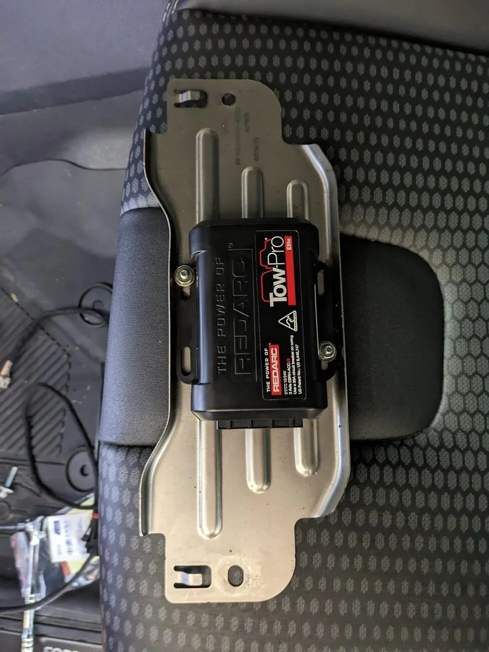

The Ford kit is Redarc based, but I would use the kit from Ford its custom. I have the Ford kit on mine and it works well. I put the dial in my light control panel.
Ford Bronco Which Trailer Brake Controller for Braptor? 1722604868005-ds
Ford Bronco Which Trailer Brake Controller for Braptor? 1722604879206-wj

Thanks all, I'm going to order the Ford kit and mount as vrtica did
