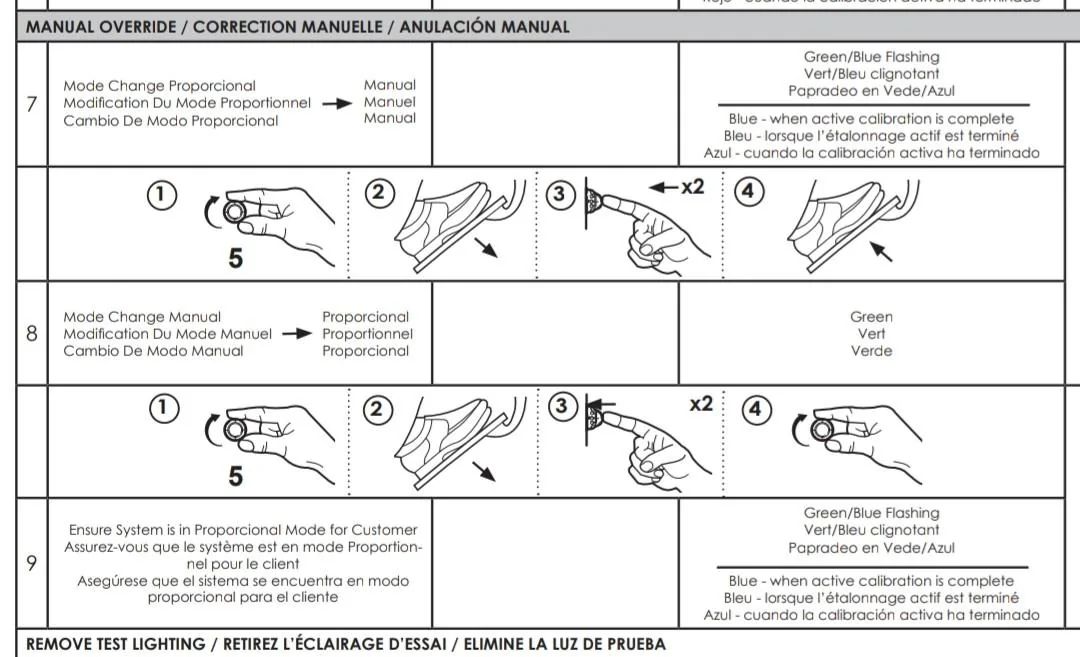

Does anyone know how to change between manual and proportional mode? I seem to be stuck in manual mode, and no matter how many times I follow the instructions to switch to proportional nothing seems to change.
Ford Bronco Factory Trailer Brake Controller installation feedback Screenshot_2024-05-21-07-12-38-90_e2d5b3f32b79de1d45acd1fad96fbb0f~2
bump, anyone?

bump, anyone?
Probably related to the miswiring of Ford. Once someone actually provides details on how to correct it, I’m just fine with how it works right now, which is probably manual mode. I set it at “2” and make micro adjustments when needed. Going to a 3 is too aggressive.
