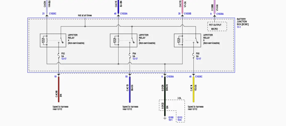

For future reference for anyone also looking, this is the current chart for a 2023 Badlands Sasquatch.
Bschurr, thanks for the heads-up!
But the wiring diagram still shows 4/5/6 as 5amp so I guess the vehicle will tell us looking at the fuse box..........
Those have been the aux amp ratings since the first Broncos rolled off the production line at MAP in May/June of 2021. The numbers from your first post (circa March ‘21) were pre-production estimates.

To start off, I'm not an electrician: I know enough to be dangerous. To that end, I'm looking to I stall a pair of ditch lights, each one has a 48 watt draw (according to it's website). Based on that and the 12v from the battery, it would be pulling 8 Amps. Based on the attached picture from a March 2021 post, that leads me to believe that the only switch capable of handling this is Aux 1-3 (unless I were to pull some solenoid/relay shenanigans).
Is this true, or am I missing something?
