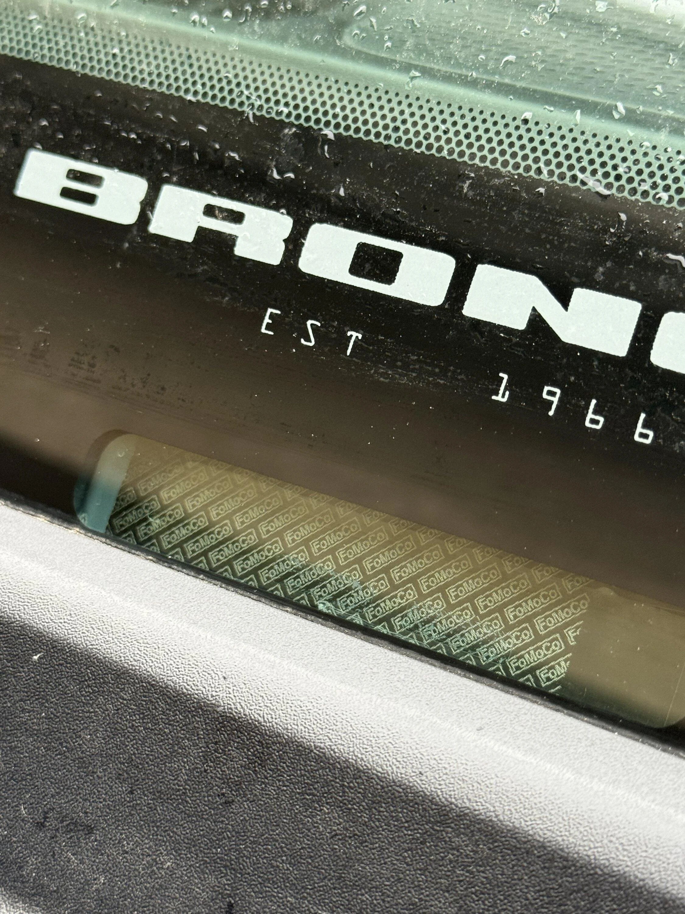

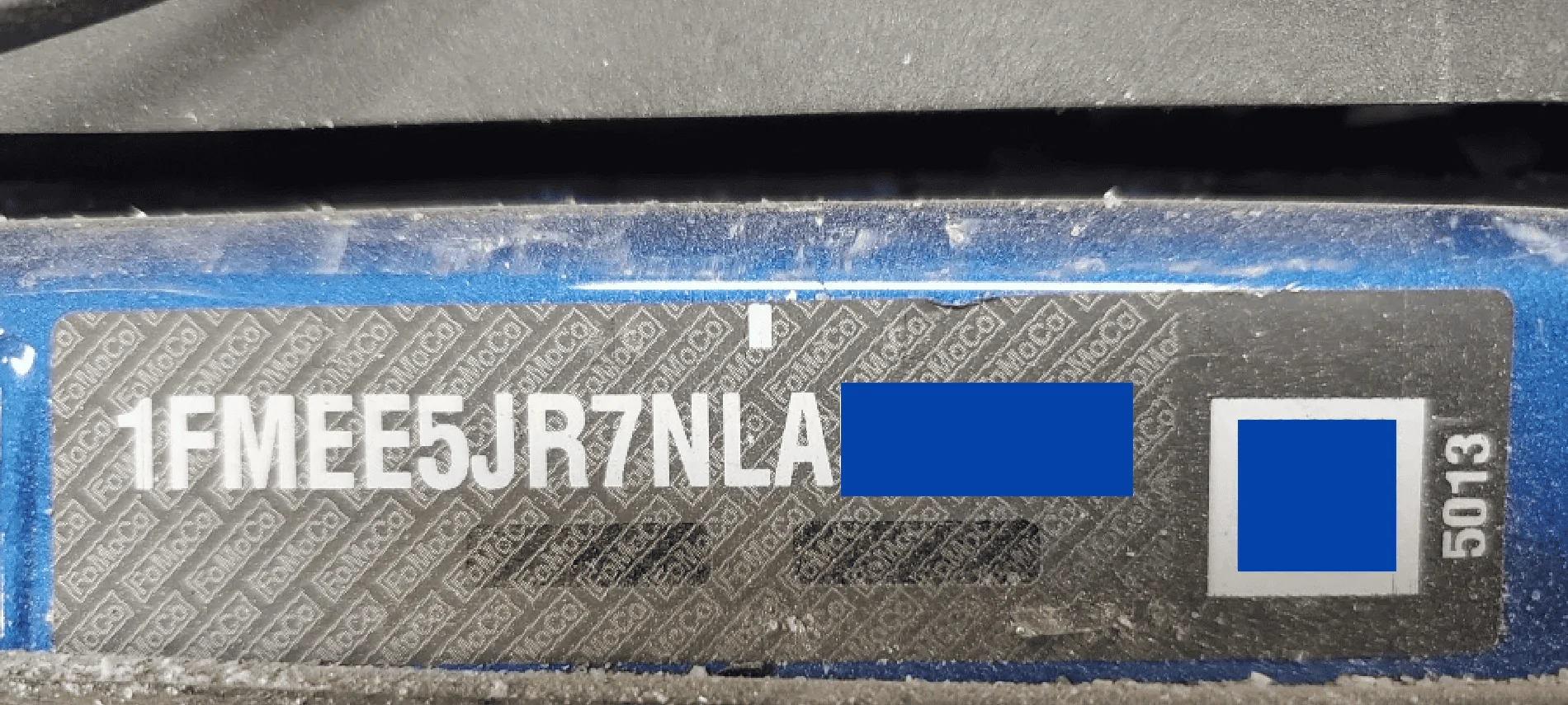

Take a look at the two rectangular spots below where the VIN text should be on the background sticker. They appear to be cutouts in the transparent VIN overlay sticker. Both the OP and JR's have those cutouts visible, OP's to a somewhat lesser degree but I can just make out a transparent edge in spots, which makes me think either a) the sticker is there and lacks VIN text or b) OP's sticker was removed chemically or with heat to avoid removing the tamper-evident surface, and the cutouts were exposed to more of the chemical/heat and were partially damaged on the exposed surface. Whatever the case, it does appear that the transparent overlay sticker is there right now or was there at some point in the past, and the underlying fomoco sticker underneath in those spots looks to be in worse condition there than on the rest of it.
There is or was something there at one point. Those stickers don't simply "fall" off, and they certainly aren't going to be inadvertently removed without leaving a lot of obvious evidence that they were. You have to be fairly skilled and knowledgeable to remove a tamper-evident sticker, but it is possible if you know what you're doing and have the equipment (you can re-install the removed sticker without leaving evidence as well).
Now, as for the VIN text on the transparent sticker, well that might be a different story if it was simply printed onto the sticker. I don't know how Ford makes them, but with some stickers it's possible to chemically remove the print off a sticker, leaving only the vinyl backing. Mayyyybe the windshield tech accidentally wiped the text off with a harsh cleaner and didn't realize what he did. That would explain why the cutouts have a whitish residue there and nowhere else, as that may be what's left of your VIN text ink. Thought I'd throw that out there as a possibility. I bet @StickerFab would likely know a lot more about this subject than I would so I'll tag him.
IDK man...if it was an accident I think at least SOME of the text would have survived. That sucker is wiped clean! Leme propose an alternate scenario...glass tech pulls vehicle into shop, removes windshield, then breaks for lunch...mischevious dealership employee(s) x, or x(s) tries xyz bodyshop chemical to see if it will remove printing on the label...employee(s) x's experiment works SO WELL he's gotta wipe the whole label completely clean before glass tech comes back to reinstall...label is wiped SO clean that when glass tech comes back he never notices (as apparently previous owner didn't either). Employee x is now "in the clear", as there is no evidence he was ever involved. Only reason I propose this theory is that I worked for several years w/just such a devious individual, and the only reason I can't pin this on him is I know he has never been in SC (which now I wonder if this vehicle has ever been serviced in WI?)
