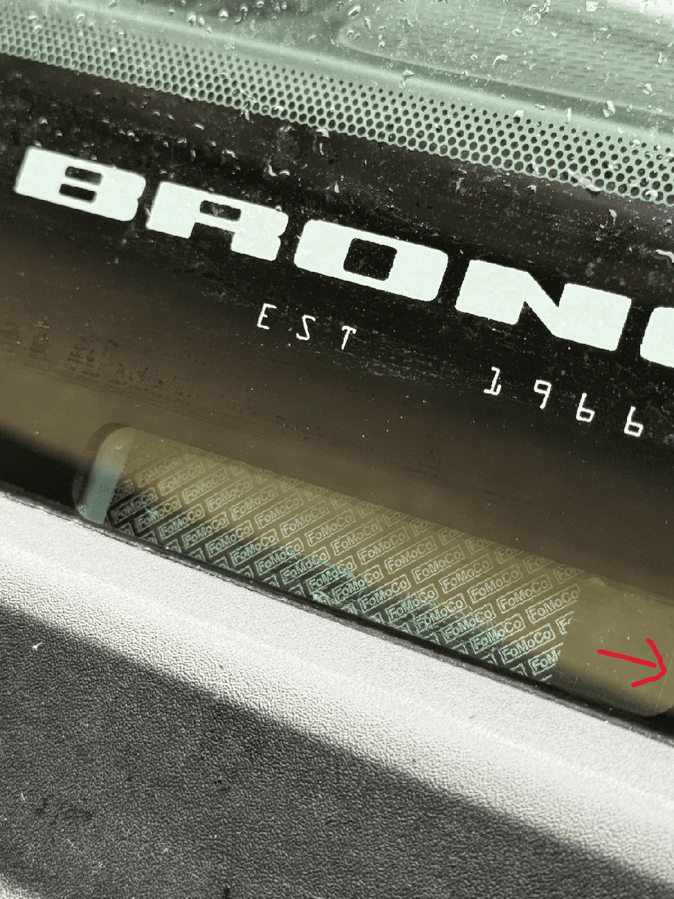

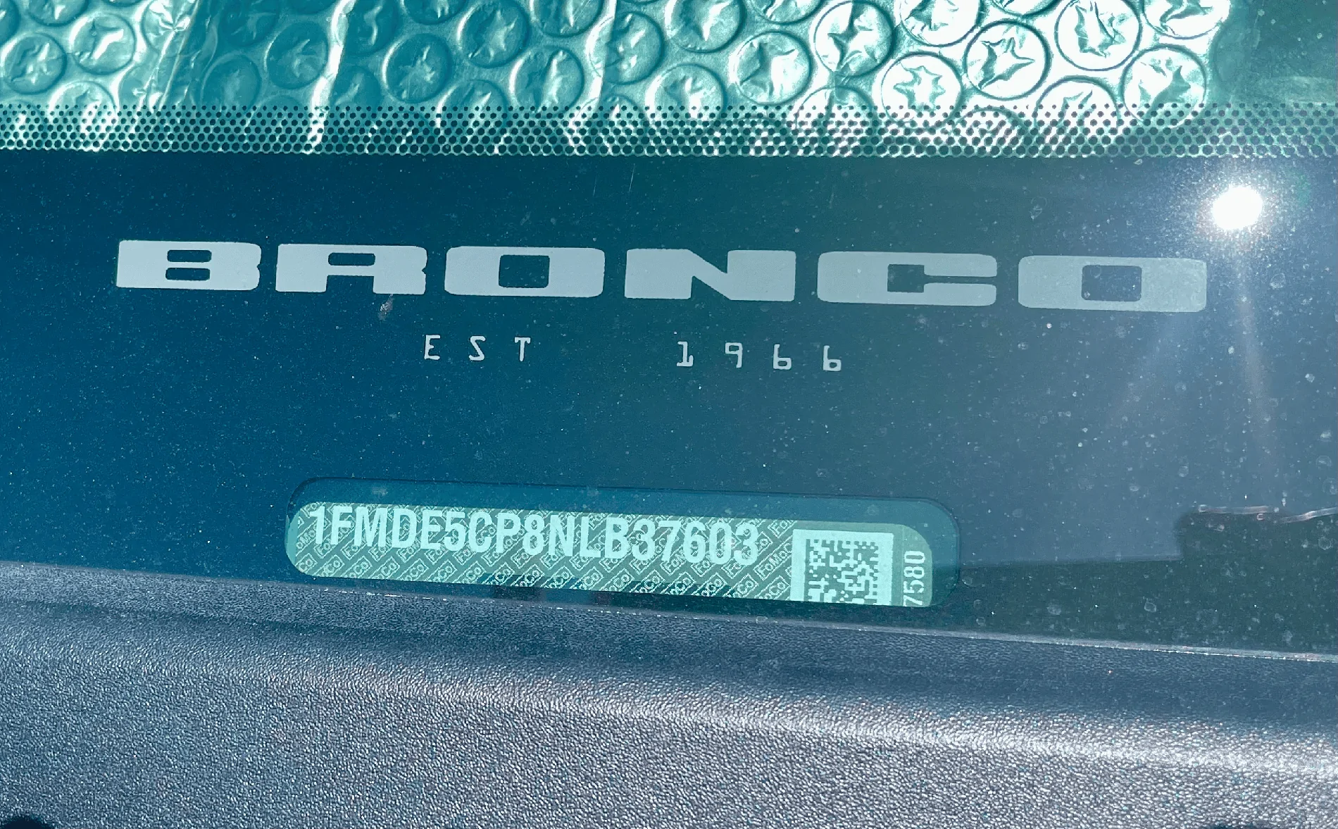

Doing some detective work by zooming in on your photo, there is a faint line (see my red arrow) of where the QR code on the VIN tag/label seems to line up.

next available appoint
Ya I saw that as well. So not sure if that is where the QR should have been or where it was and now its gone.

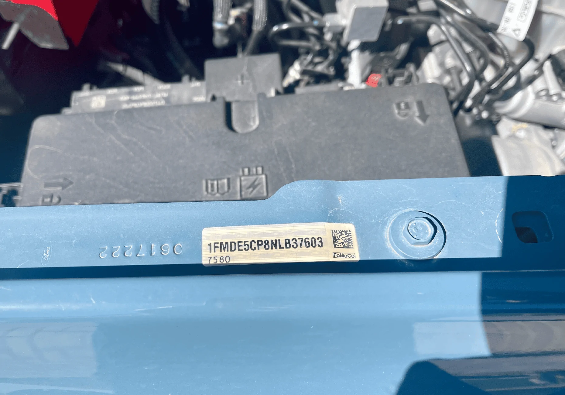

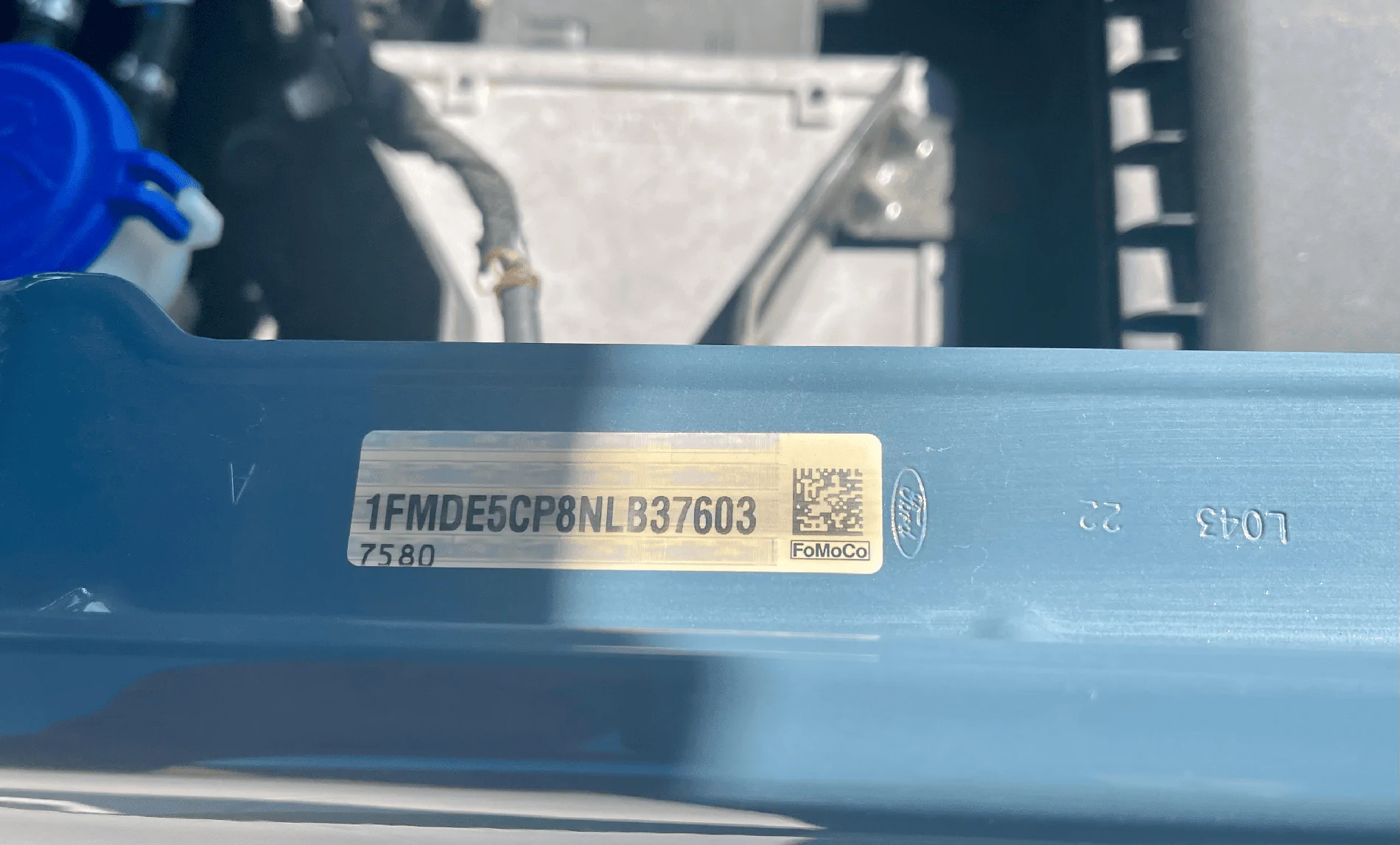

BigJim1957
Oct 19, 2021
71
101
Las Vegas
2007 Mustang GT/CS, 2022 Bronco Badlands
Check for VIN tags along the top of your Driver and Passenger fenders. If they are not there, contact your nearest Ford Dealer for advice on correcting the issue. I hope everything works out.

FatsWaller
FatsWaller
Feb 17, 2024
60
199
So.California
2022 Ford Bronco
From what I can tell from your window VIN, it looks to be actually printed onto the FoMoCo label? So that means mine couldn't have simply 'fell off' or been ripped away? Mine looks as if it was never printed onto to the FoMoCo sticker.
