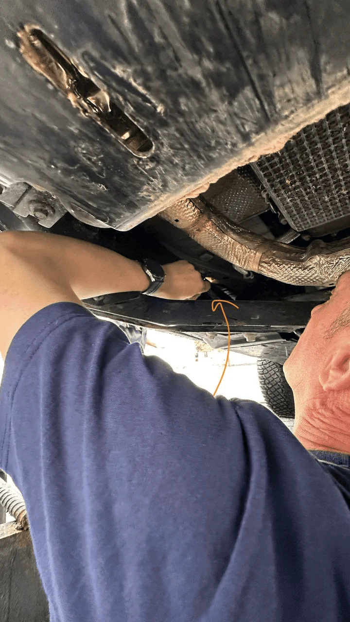

I would consult a Ford dealer first. They can identify the vehicle by comparing the VIN from the ECU and other modules to the VIN that is engraved on the body and frame.
The VIN on the frame is located on the passenger side. It's not easy to see it – you're going to need a flashlight and an inspection mirror.
The number of the engine block should match the last 7 digits of the VIN.

Gotcha, ok Ill see about that tomorrow. @RagnarKon helped me find that, and it matches my VIN on other parts of the truck.
