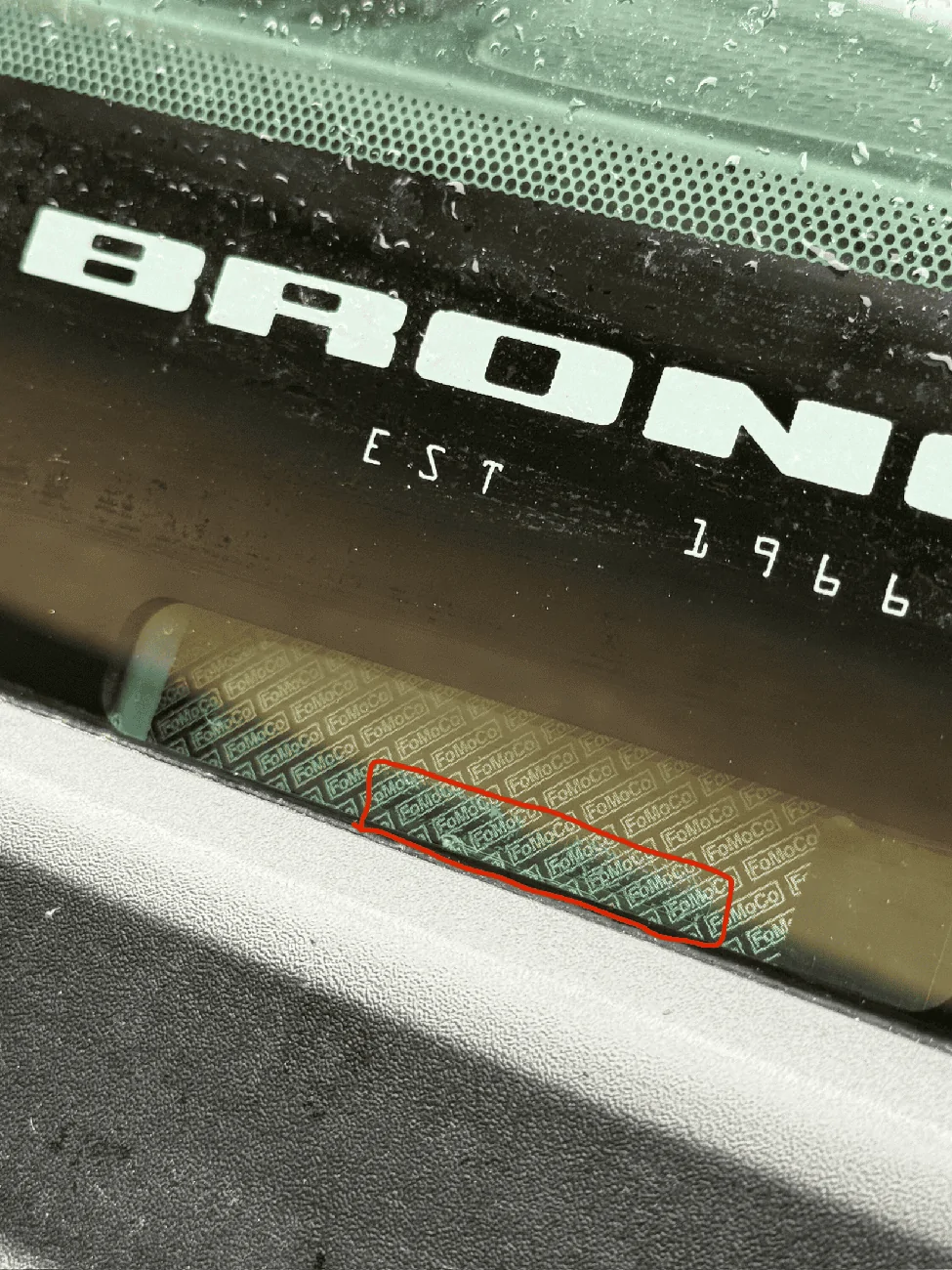

This may have been posted already, but it appears that there is a sticker with the “FoMoCo” repeat logo over the VIN plate. Seems like it was pasted over the existing logo. I’ve tried to outline it in your original photo.
I saw this as well, but noticed the two others that posted images of their VINs on this thread also have what appears to be these 'adhesive marks'.
