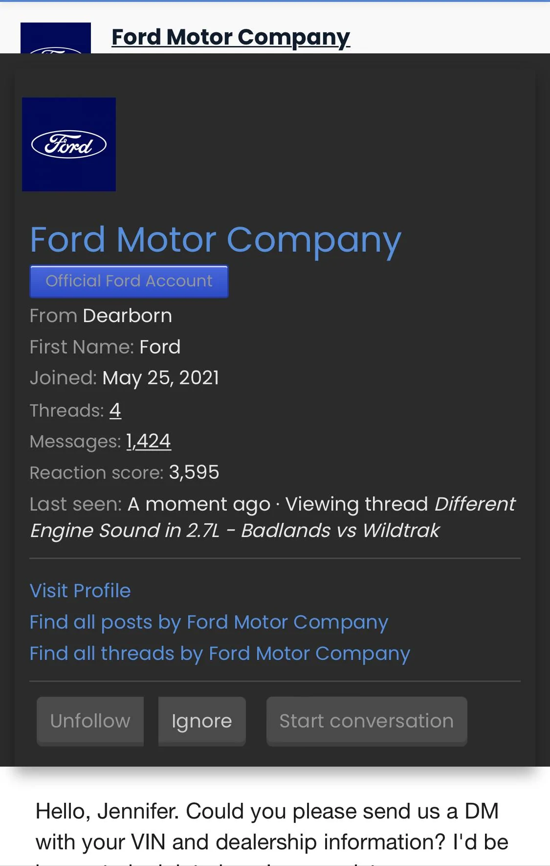

Hello, Jennifer. Could you please send us a DM with your VIN and dealership information? I'd be happy to look into how I can assist you on my end.

I don’t know how to DM on here.
