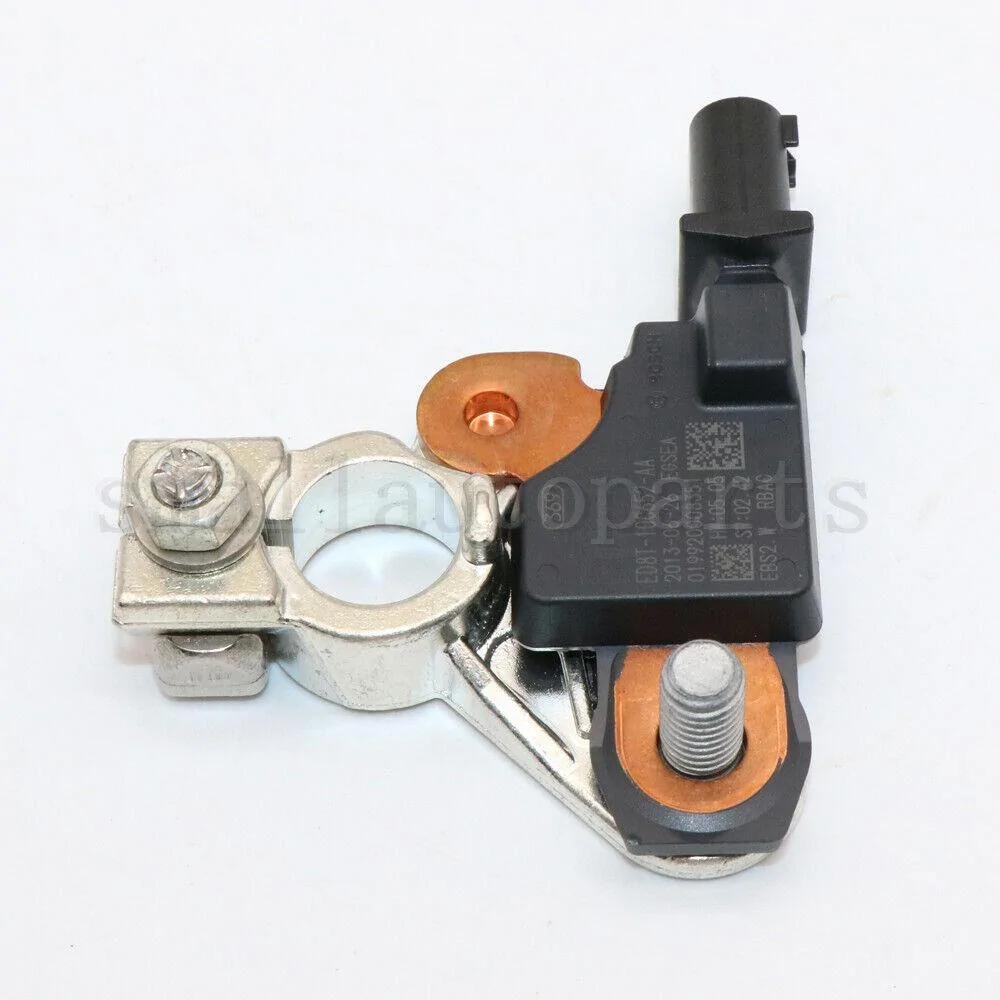

You'll want to use a third party device hooked to the battery past the battery sensor device.
Ford Bronco What is this on screen Notice? 1705193570447
Link
You'll want to do due diligence before ordering, but you're looking for a device like this that can report voltage in real time and allow you to set alarms.

Other options could, yes. Not the implementation I have as FordPass does not operate in real time - it gets triggered by certain events such as engine on, engine off, doors opening etc. I use an automation to trigger fresh statistics once a day since I drive it so rarely and it'll go into deep sleep mode and stop reporting.
Link
