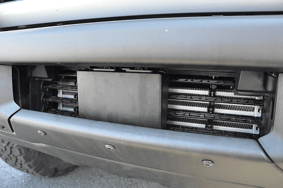

There will be no room as the louvers and inter-cooler is right behind it
Ford Bronco What is the damn box? 1620157095800
Wonder how much of a PITA it will be to relocate the ACC box to install a hidden winch bumper...maybe Lux package isn’t worth it if I have to deal with that headache
I know, off topic. But, it wouldn't be a B6g thread if it didn't go off topic. :) Now that we know what the "BOX" is for, can anyone tell me exactly what the louvers/shutters are for? I have an idea, but my ideas are usually wrong. Just ask the wife. lol

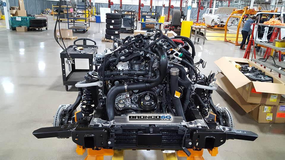

Here is a closeup of the box, it houses the radar sensor for adaptive cruise control and emergency braking.

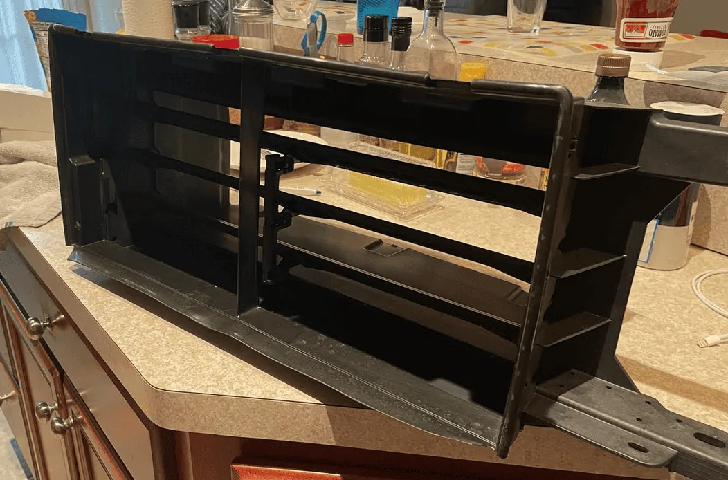

The louvers/shutters in my pic in the open position. So it opens and close to regulate airflow to the Inter-cooler
BTW .. on my Raptor it is huge and you can remove it if you wish. It does not affect the trucks operation. There is 1 small item to account for is that there is a motor that you have to keep plugged in or you will get a warning.
I don't know how it is setup on the Bronco BUT it looks very shallow and I think most guys will remove it so you can run a bigger inter cooler.
My raptor shutter is below for reference.
