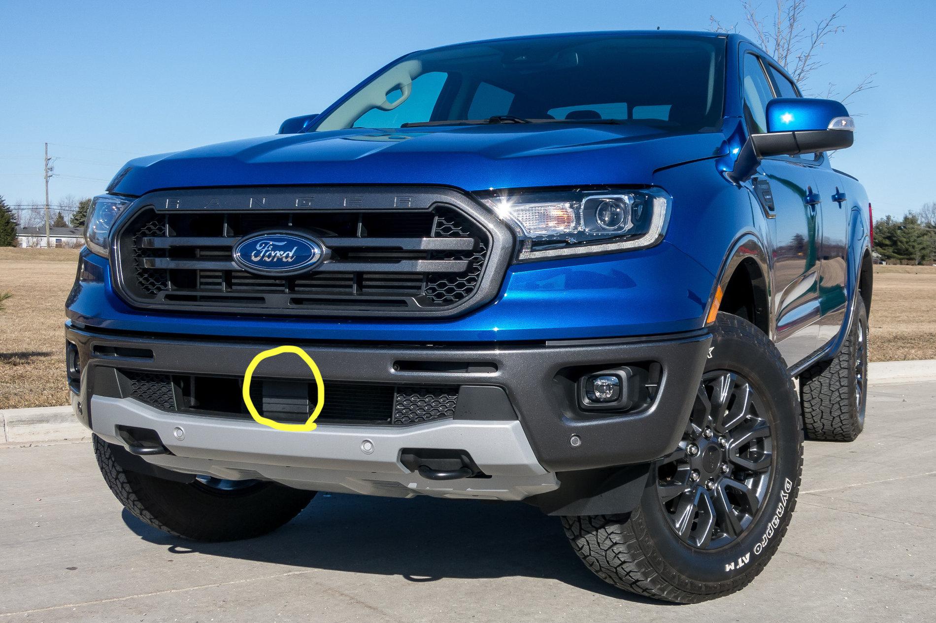

Here’s the Adaptive Cruise Control radar sensor unit on the Ranger:
Ford Bronco What is the damn box? 1615676011790
The pre-collision camera-based sensors are what are up by the rear view mirror.
Two different technologies which work together for these systems to operate.

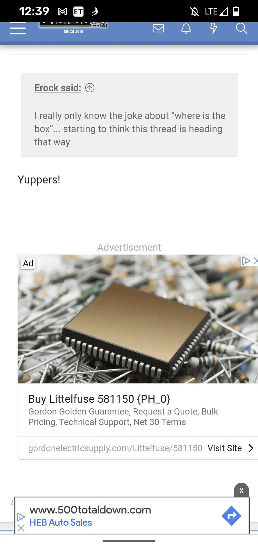

Ford Bronco What is the damn box? Screenshot_20210504-123941
How ironic that I click on this forum where were talking about what's in the box and this is the first ad that pops up! Found the computer chips boys!
