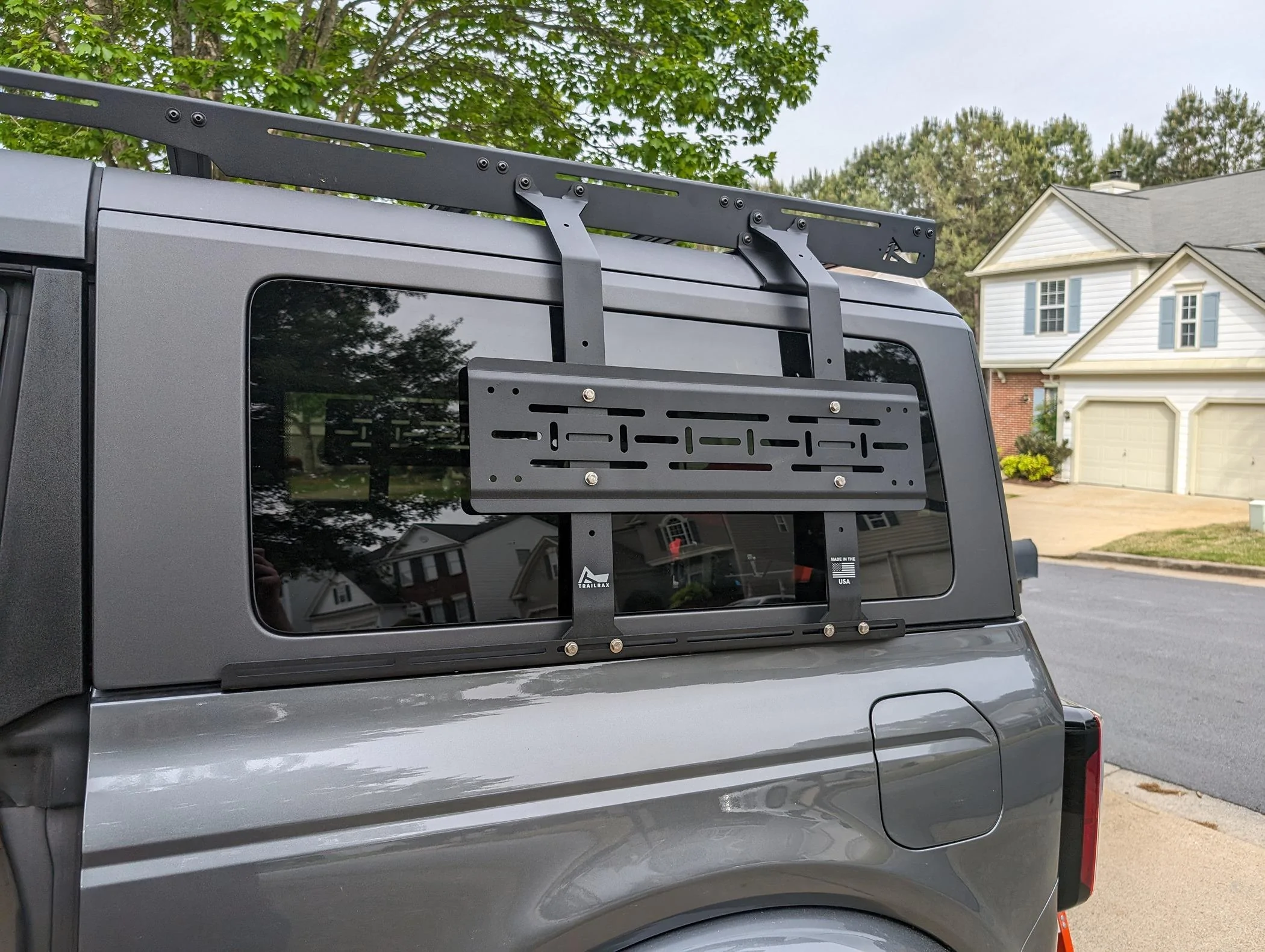

Put together the TrailRax rack. I did overhead press today at the gym so will wait till tomorrow or Friday to take the roof off to install the Pax Rack.

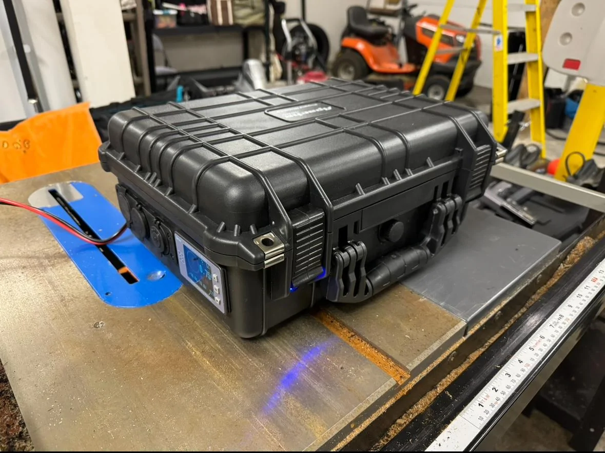

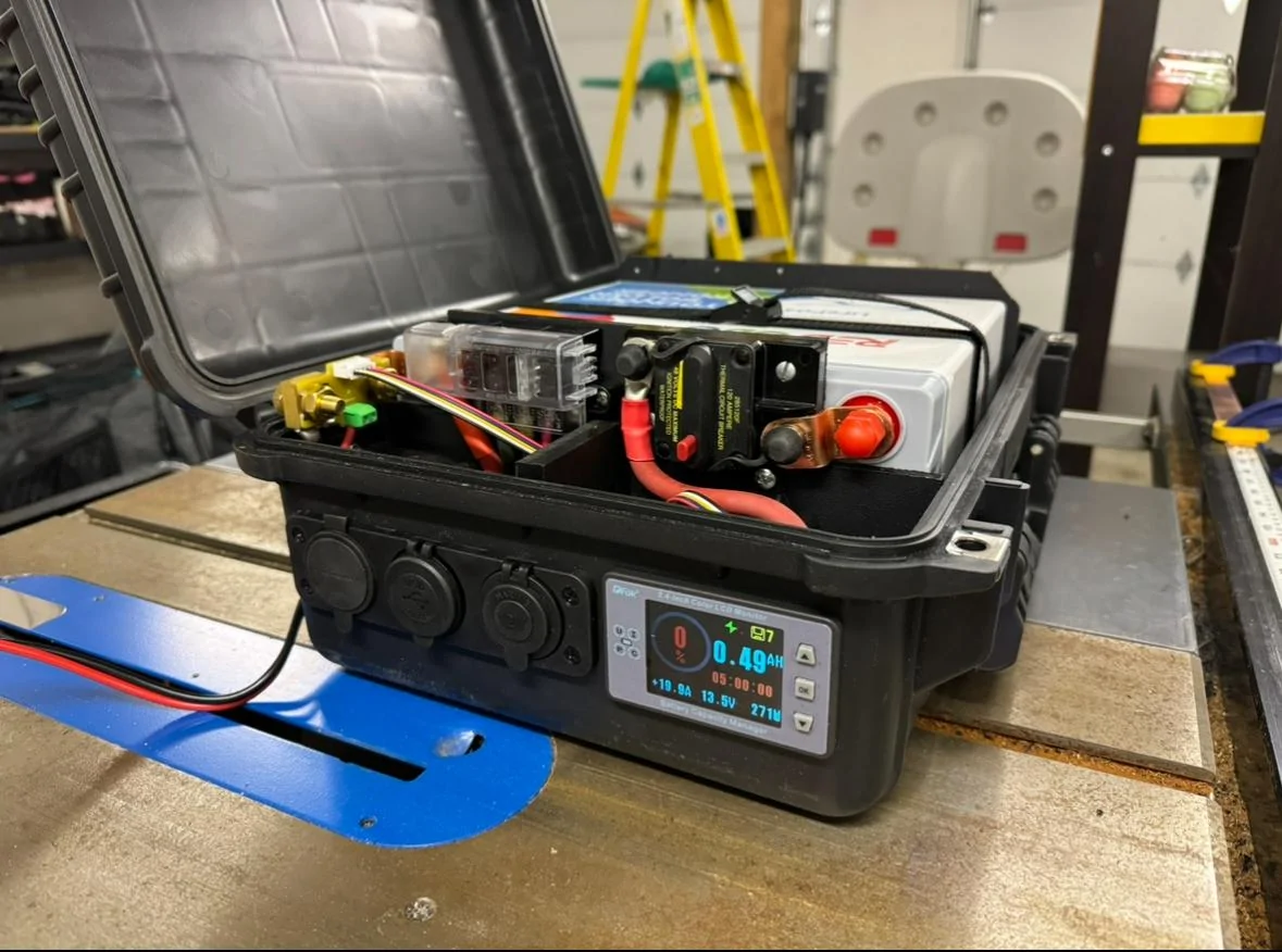

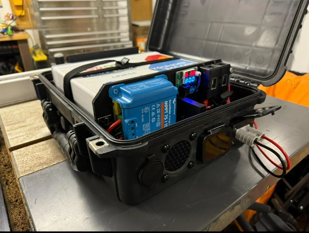

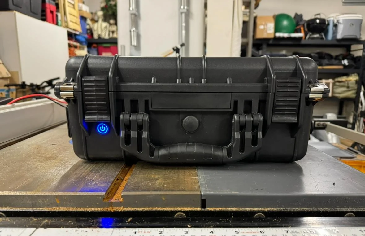

It's not in the Bronco (yet), but I finished up my portable power station build last night. Still need to do some calibration, then I'll put it through it's paces. It's been a fun little project and it turned out much better than I expected. Planning on using this for camping and eventually running a fridge in the back of the Bronco.
Full build details here: https://www.bronco6g.com/forum/threads/portable-power-station-diy-build.92428/
Some quick specs:
  • 12V 100Ah LiFePO4 battery
  • 15A solar MPPT charger
  • Battery monitor with color LCD screen
  • Temperature-controlled cooling fan
  • Single power button battery disconnect
  • 2x 20W USB-C ports
  • 1x 18W USB-A port
  • 1x 300W 12V cigarette lighter port
  • 2x 30A Anderson Powerpole ports (input/output)
  • 2x 50A Anderson plug ports (input/output)
  • 1x 30A Anderson Powerpole solar input
It may be a little overkill for my current needs, but this should last me a long time with everything in it completely serviceable & replaceable.

Not seeing any thermal problems, that exhaustfan should be enough. Really like the packaging you did, bet it'll stand up to some good bouncing around πŸ‘Œ
For sure, that battery isn't going anywhere. The frame I designed is custom fit to the battery's dimensions. Once it's in, it's in.

Curiosity in total cost of DIY build? Unless cost savings wasn't the goal and serviceability/fun project was?
Total cost of components ended up being $630 (not including wires, terminals, screws, etc.). I'm sure there are better deals on out of the box solutions, but I did want something serviceable and designed for my needs. I wasn't a fan of the dimensions of most of the solar generators on the market, too cube-like. I wanted something a little slimmer that I could orient flat or up on it's side and still have access to all the ports and allow for air flow. I also went a tad overkill with the wire thickness and number of ports, but I figured it'd be better in the long run. Experimenting with new components, tools, and materials during the course of the project was also a plus.
Looks like a πŸ’£ from here. 🀣
Yes, my code name for this project was "battery bomb".

That is one nifty little unit, great job !
