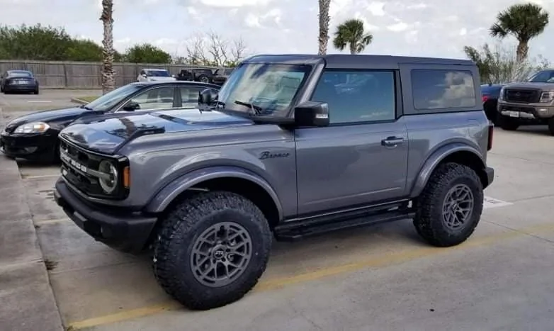

New OBX owner, love my bronco but kicking myself for not getting SAS. Can you upgrade specs from non-sas to sas? Sorry if that is a stupid question. Like the lifted look, suspension and bigger tires. I suppose live and learn <.>
17x9 +30 offset RTR tech 6 rims
Get 33.5" tires (295/70R17)
Look cool
Ford Bronco (Weird question) Non-Sas to Sas? received_1670734536661668
Ford Bronco (Weird question) Non-Sas to Sas? IMG_20220910_181155 (1)
Same vehicle 24 hours later, no lift
