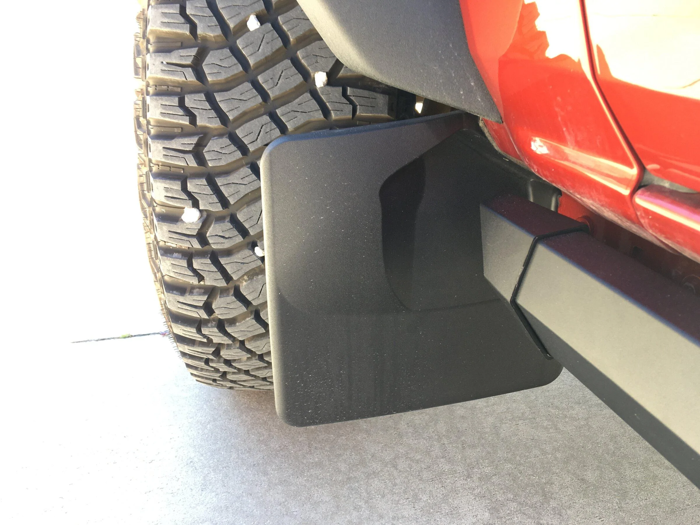

I Got sick of waiting for other options, so I installed Weathertech front flaps today.
Couple FYI's: The instructions are wrong as it states to only remove 4 plastic screws out of the well. You need to remove 5 for the additional push pin.
The plastic screws in the well are a bitch to get out! When it says apply light pressure to unscrew, they mean it. You basically get one shot to have it spin out of the sleeve or you'll be ripping it out with a pliers \ side cutters. I had 3 that would not come out, so they had to be cut.
All in all, they are fine. Definitely better in person than I was expecting.
