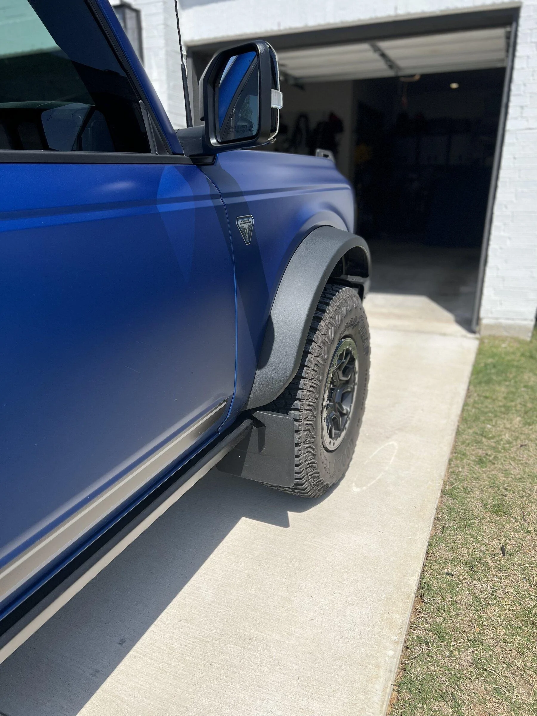

[First 3 pics, below]
Vehicle protection was considered with the gap created. The centerline of the tire in relation to the gap would be below. Debris would be unlikely to travel through the trajectory and reach the door panels. Nylon u-clips versus steel u-clips were also supplied to avoid galvanic corrosion.

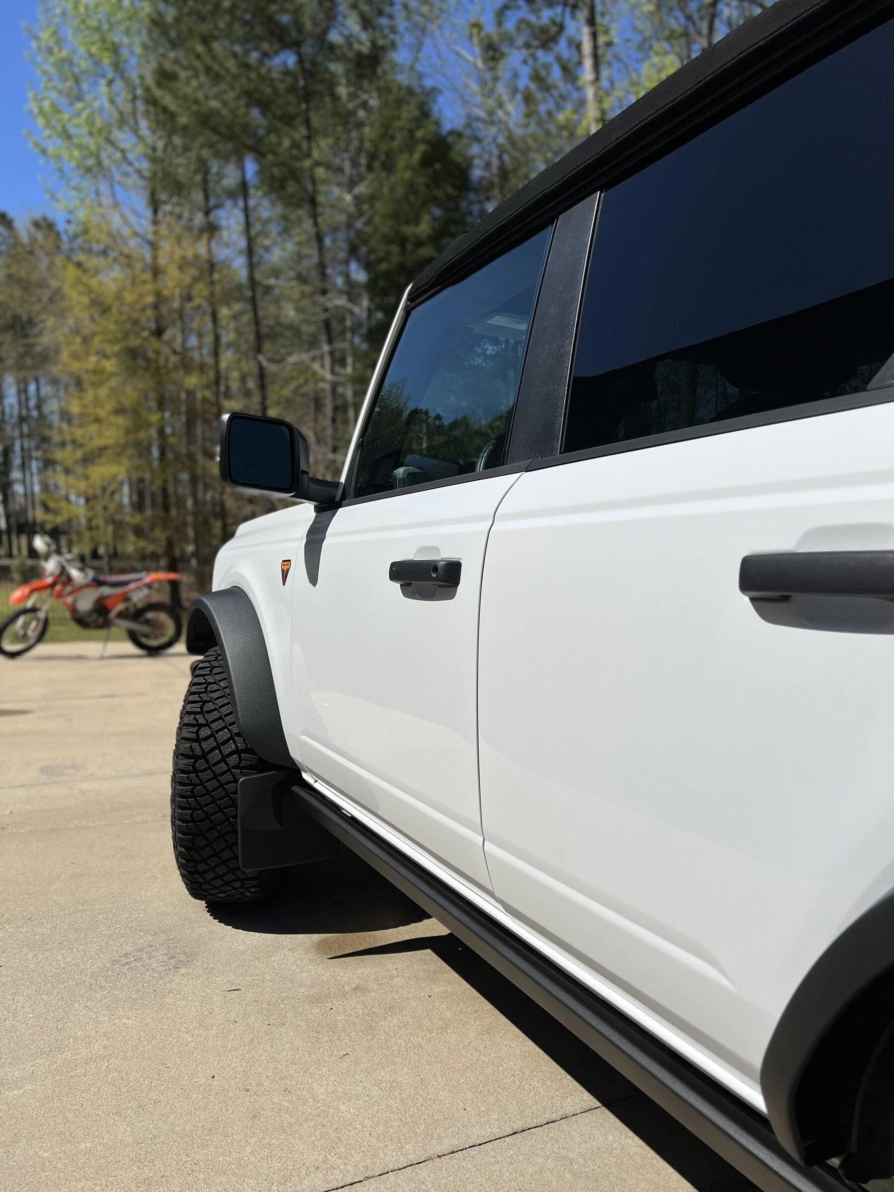

[Second set of 3 pics]
Aesthetics were considered with our traditional bulbous MudFlap design. However, with requirements to avoid the rock rails, tube step, and large 35” wheels, design
modifications to the traditional MudFlap needed to be implemented. The bulbous design on the outer half was left, to create strength on the extension outer part.

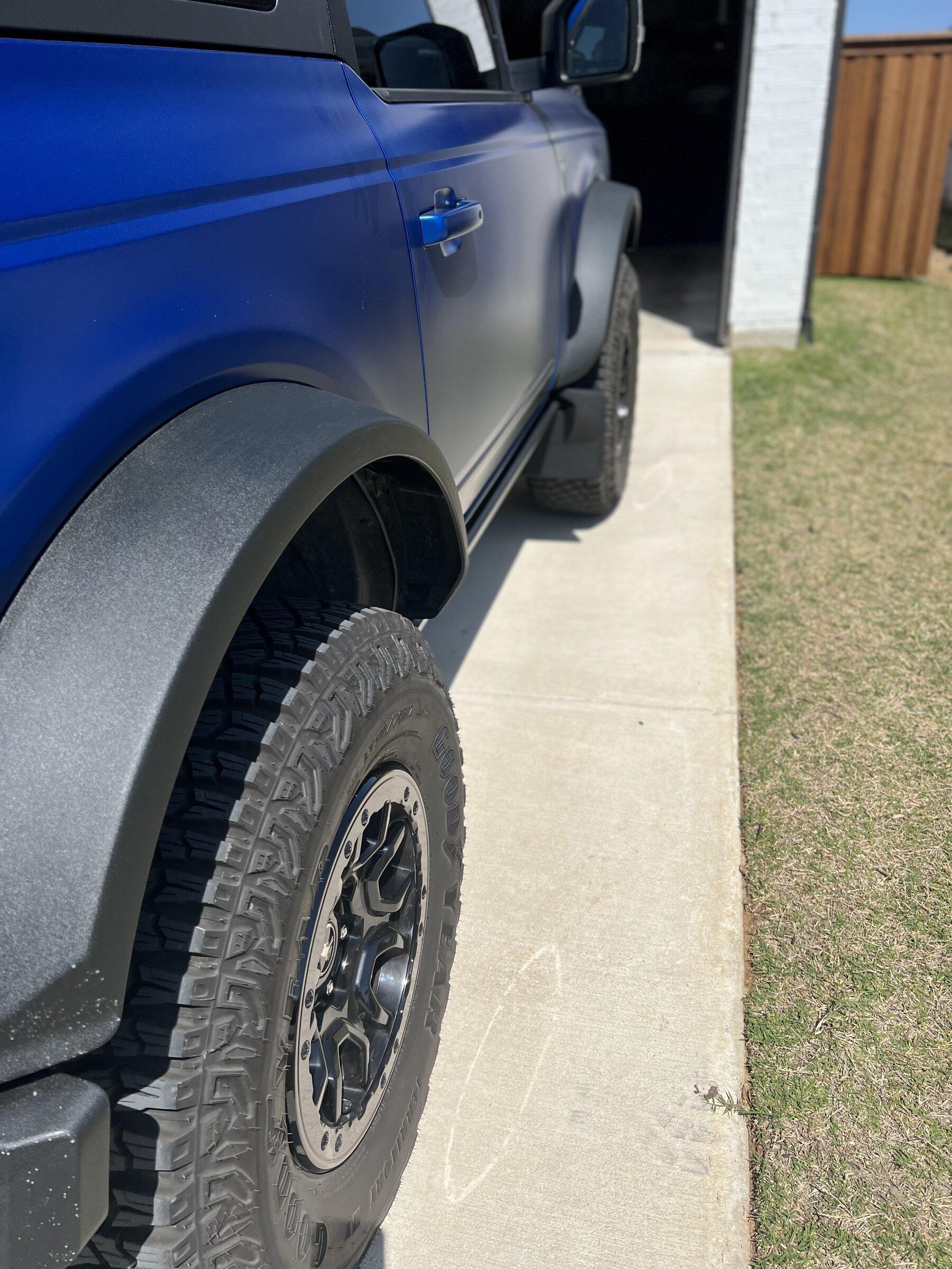

[Last 3 pics]

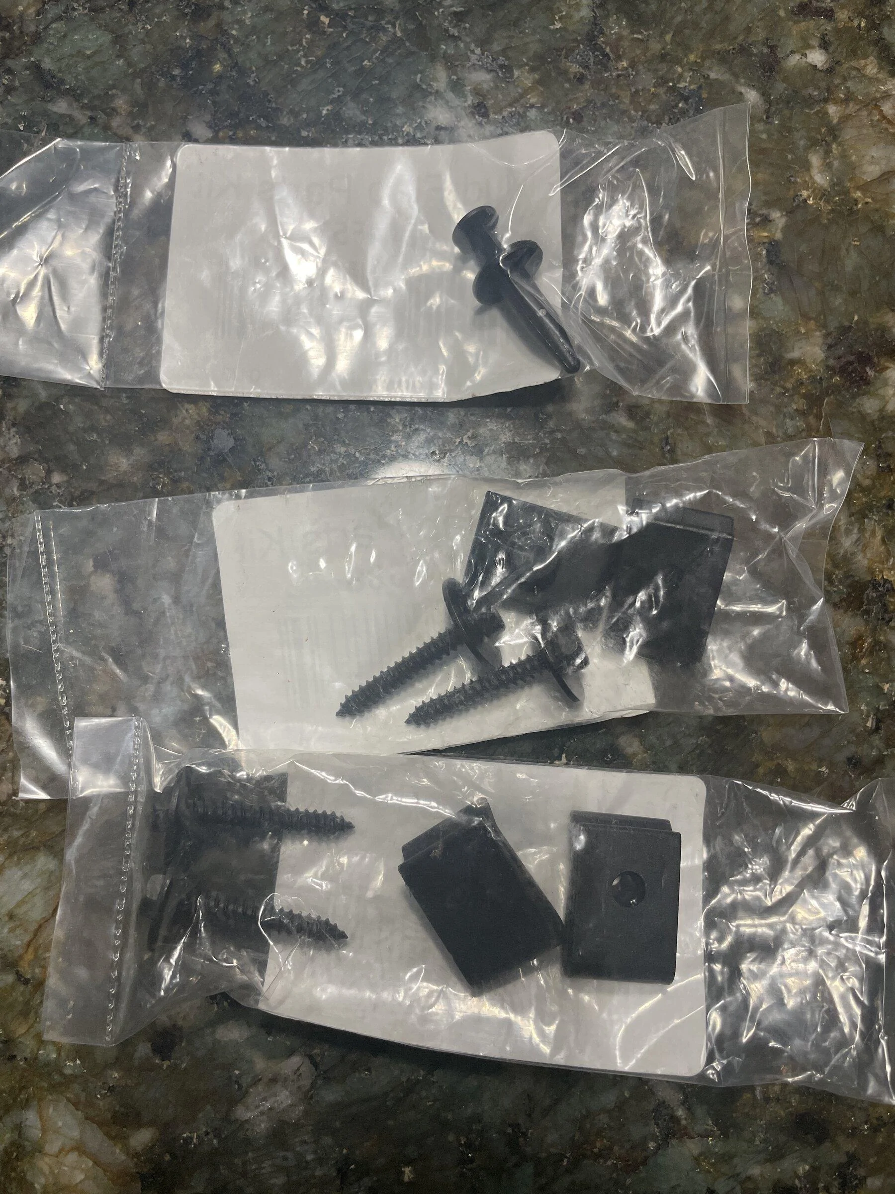

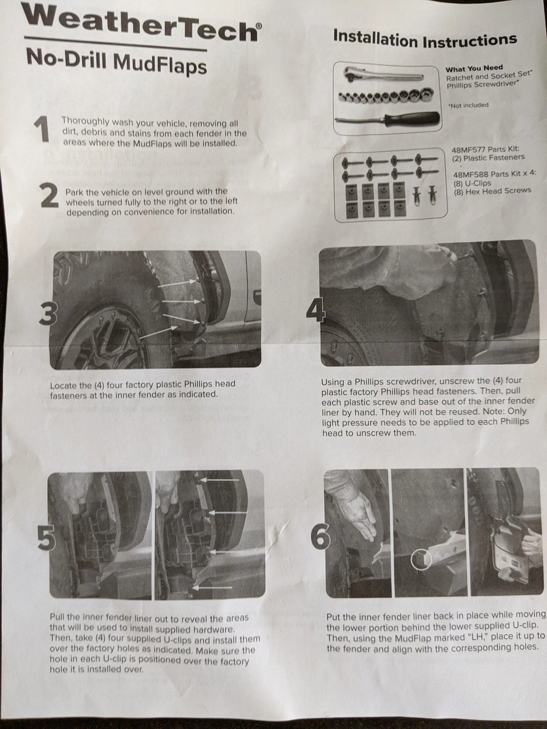

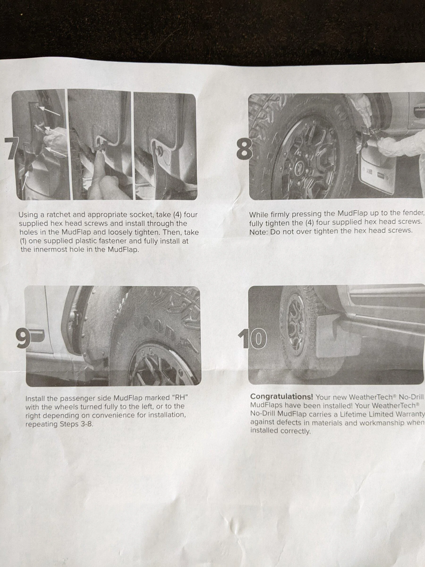

Anyone happen to have the install instructions handy and wouldn’t mind posting a pic or dm’n them to me? Mine shipped as what appears to have been a return less the instructions and hardware. They sent me out what they believe is the hardware but can’t seem to get me a copy of the instructions. Given what the sent me as hardware is a total of 4 screws, 4 clips and 1 pushpin, I’m thinking I’m missing stuff since I’ve got 5 holes per flaps to fill.
4 screws and clips per side, and 1 push pin per side that goes into the inner most hole(i believe). Someone post a photo of it that i am trying to find.
You are awesome, thank you! I guess I have enough hardware for one flap today!
