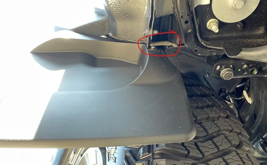

My original rears required drilling through the plastic inner fender liner, even though it stated 'no drilling'. And the fronts that I returned would have needed a hole drilled/punched through the inner felt liner.
I believe the felt you're referring to on the front just needs to be tucked behind the bolt hole. There's no need to drill or punch through it. Simply tuck it behind the hole so that you can access it and put the supplied bolt through the hole and mud flap.
You can see here the felt tucked behind the hole.
