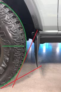

[First 3 pics, below]
Vehicle protection was considered with the gap created. The centerline of the tire in relation to the gap would be below. Debris would be unlikely to travel through the trajectory and reach the door panels. Nylon u-clips versus steel u-clips were also supplied to avoid galvanic corrosion.

Thank you Cat for posting all of the detailed info provided by Weathertech. The price went up a little but I found some on sale for the holiday so ordered a set. I too was thinking the front flaps were a little strange looking but once reading the design issues, it all made sense. Especially like that they even considered the galvanic corrosion issue which a lot of us in northern climates would have to deal with. The only other one that offers anything similar was the RekGen but they don't offer a rear flap if you have a metal bumper. Just look at the threads on here about their hardware rusting., even the $1000 gold plated flaps. Then think about what that is doing to your aluminum fender.
