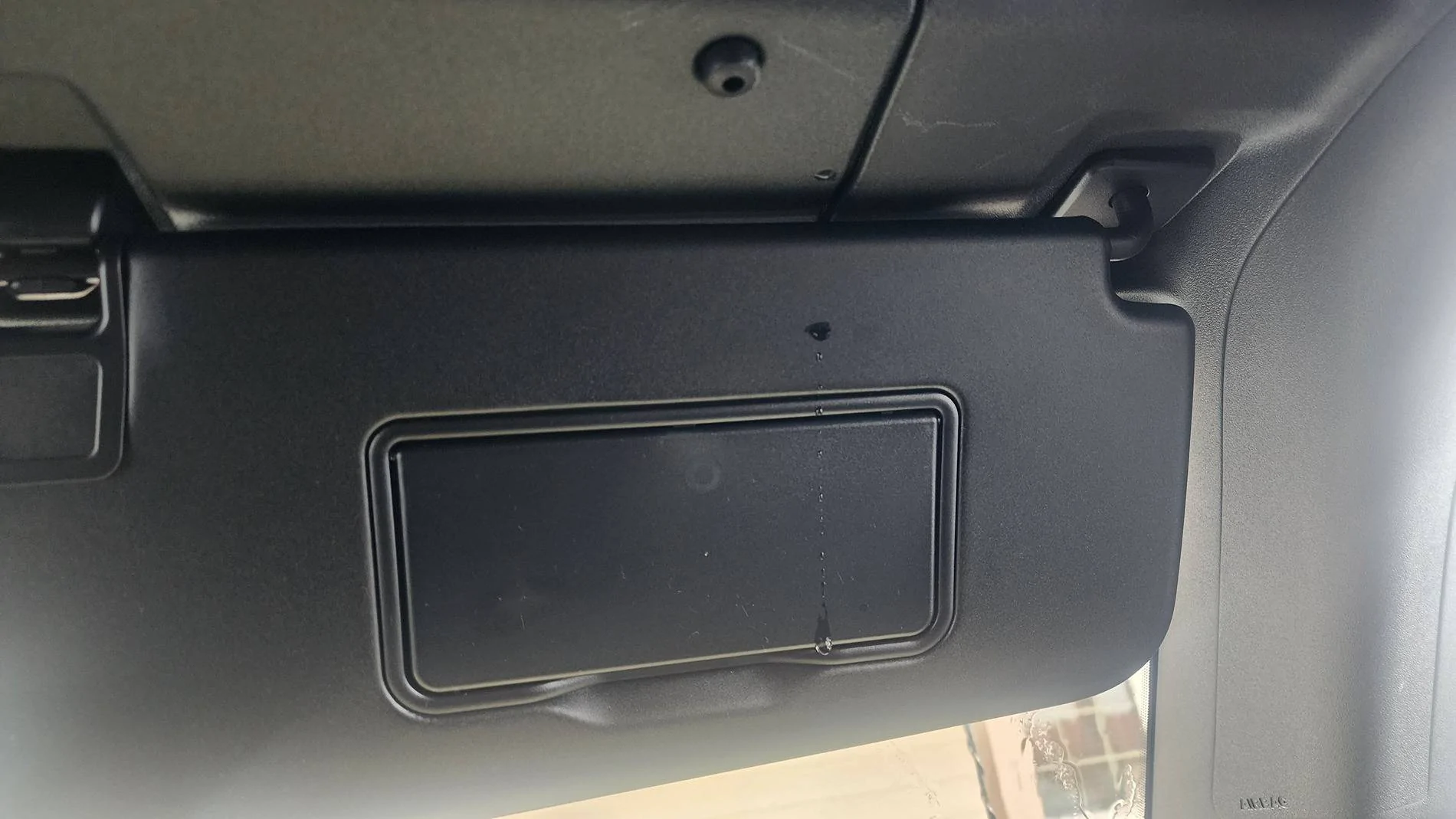

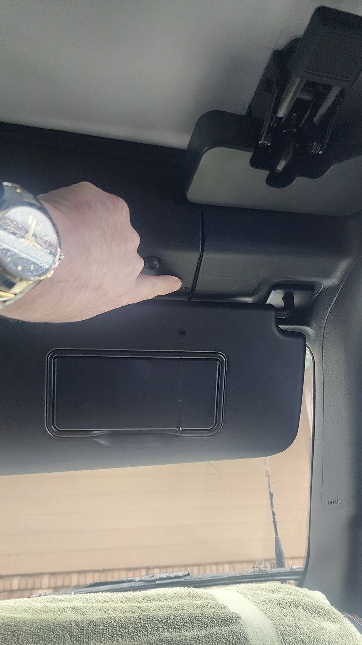

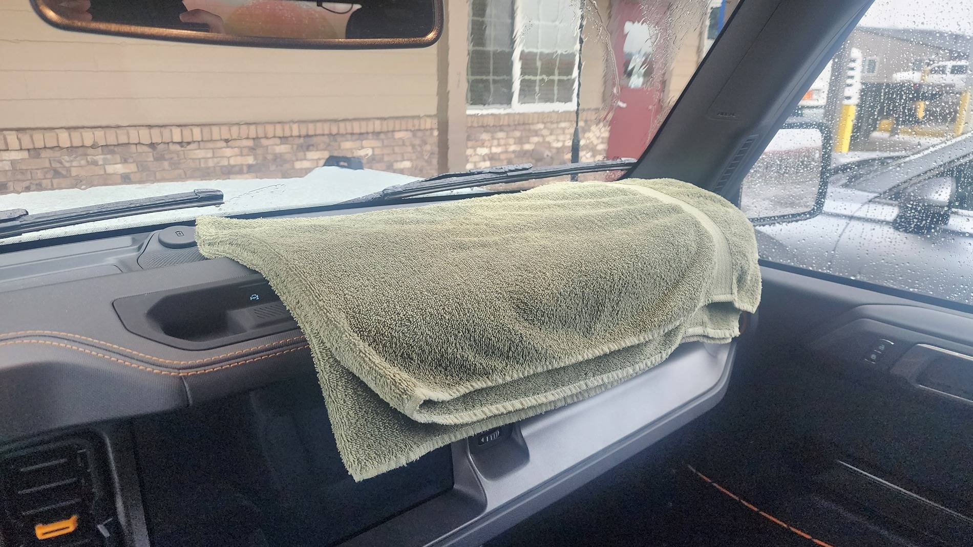

I've talked about this in another thread, but I don't want to hijack his thread..... Been going on for a while. I have to drive with a bath towel folded up sitting on the dash to catch the water that runs down the passenger side visor whenever I make a hard right hand turn. It's been in several times and they say they've fixed it. I took the front part of the hardtop off the other day and saw that they just applied silicone around the screws that hold the seal that runs on the top of the windshield frame. I just got this on November 14th and for a 70k vehicle I'm not pleased with this solution(?). If applying silicone stopped the leak, should I be happy? Or should I not accept that as a fix? I'm worried about down the road after warranty, it getting worse and now it's 100% my problem....

I had a leak the first week and it turned out it was a seal along the top. Ford replaced it under warranty, as well as the rear window seal. Take it to your dealer service.
I guess there's a little more to it. When I took delivery I immediately noticed the pool of water on the dash that somehow (I have no idea how), they weren't able to see during the PDI. They took the top off and told me that 2 screws are completely loose and are not tightening, like whatever they thread into is stripped. Then after 2 visits, miraculously it's fixed.... And all I see is silicone.
