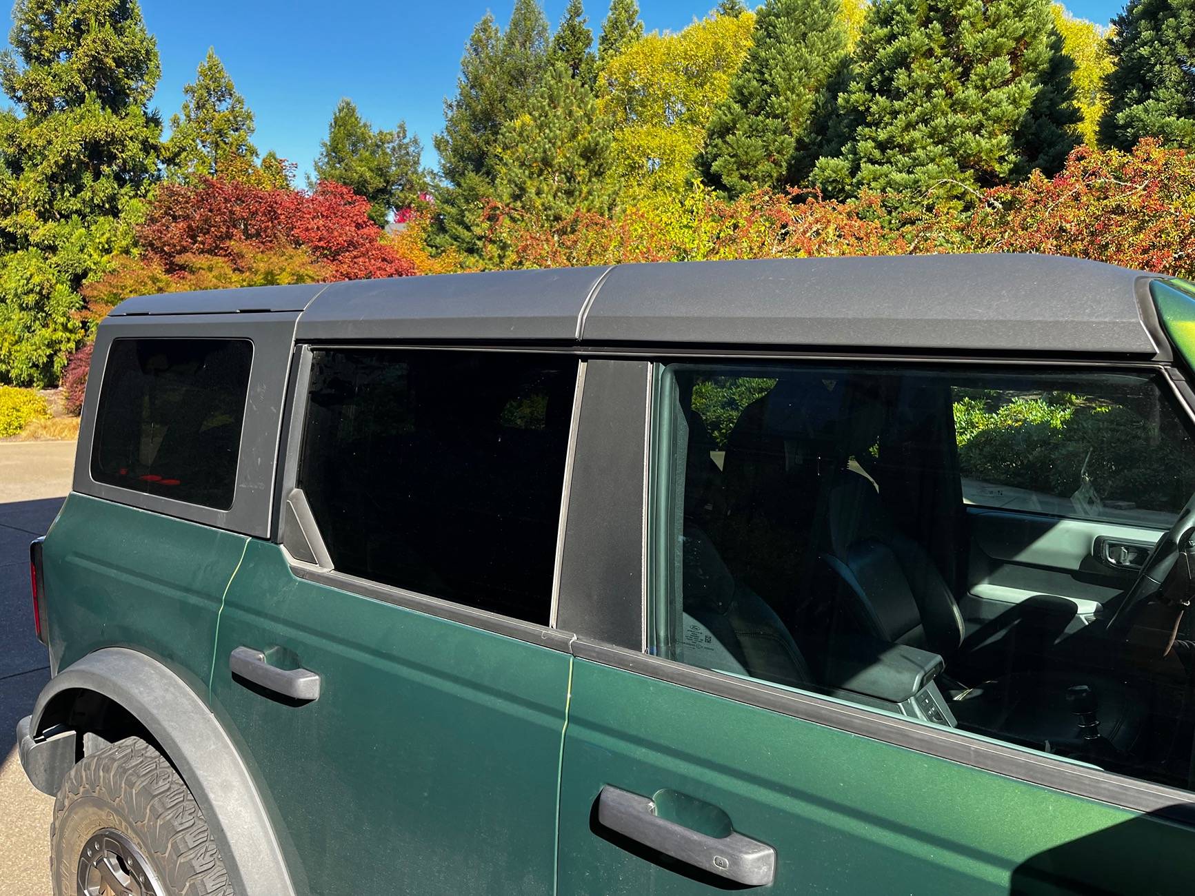

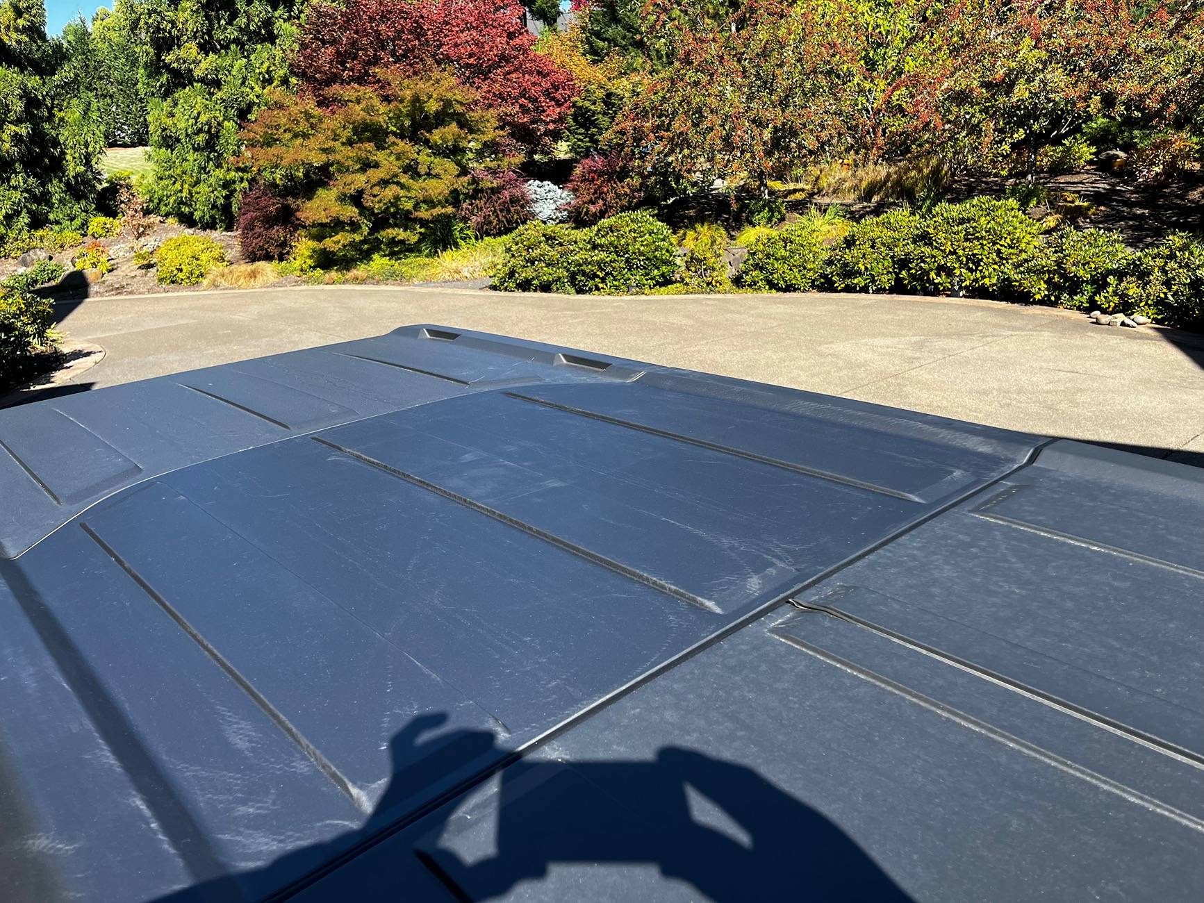

Sorry for the delay on my end. Got the Bronco back and promptly went an a 500 mile RT journey to go crabbing on Whidbey Island.
So in the end, the center panel was replaced under warranty due to "warping". The wind noise issue was due to a "bad contact pattern" between the passenger side of the panel and the body (as I determined on my own, but thought new rubber gaskets would have solved it).
My Bronco is now very quiet again (as quiet as a removable top vehicle can be). Absolutely zero wind whistling up to 80 mph.
As for coloration, from the sides, the center panel matches, but from overhead, the center panel is significantly less "faded" than the original panels (front and rear), but I don't see it unless I am washing the Bronco, so I don't care.
Very happy I don't have to go the route of adding all the foam strips to my roofline to quiet the interior noise as others have had to do.
The text on my invoice/receipt was "Another new top under SPW". No part number associated with the text. I assume "SPW" stands for "warranty" in some Ford parlance.
