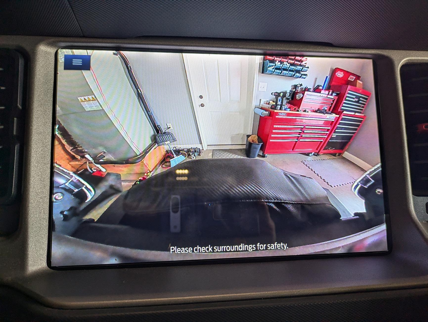

How is the front camera view?

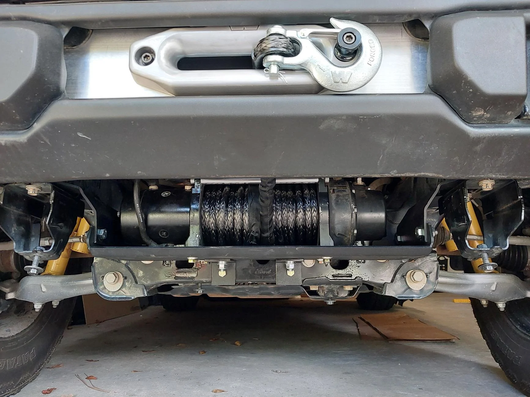

That is without the kit installed?
Yup its not a high mount winch plate. The M2M bracket goes on the fairlead bolt location.

TOR is running a sale this weekend and thinking about picking up that winch mount - I've heard mixed reviews, how did you like it and the install?
Modifying the OEM bumper wiring harness is a PITA, but just takes patience, most of these plates move the inner sensors. I wish they would provide a pigtail extension kit, would make it much easier. The rest is top notch fitment and quality IMO. I picked this one because of my current mod RTR brackets.

Yes but the only other two solutions is run a high mount (which is bad) and a complete new bumper system. I like the OEM bumper so went this route, doesnt look as bad with my Project X lights on there.
True. I decided to make my own solution. But it has it's drawbacks as well. Along with being a pain to install.

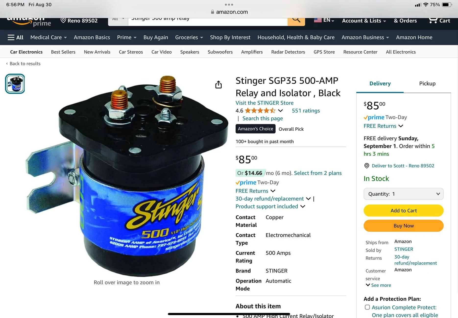

3) Installed and wired up Stinger 500amp relay which is triggered from uppfiter switch.
Very Nice! Is this the exact relay you used?
Yes it's widely been used on a lot of bronco projects on here. It's a little pricey but it's one area you don't really want to cheap out on.

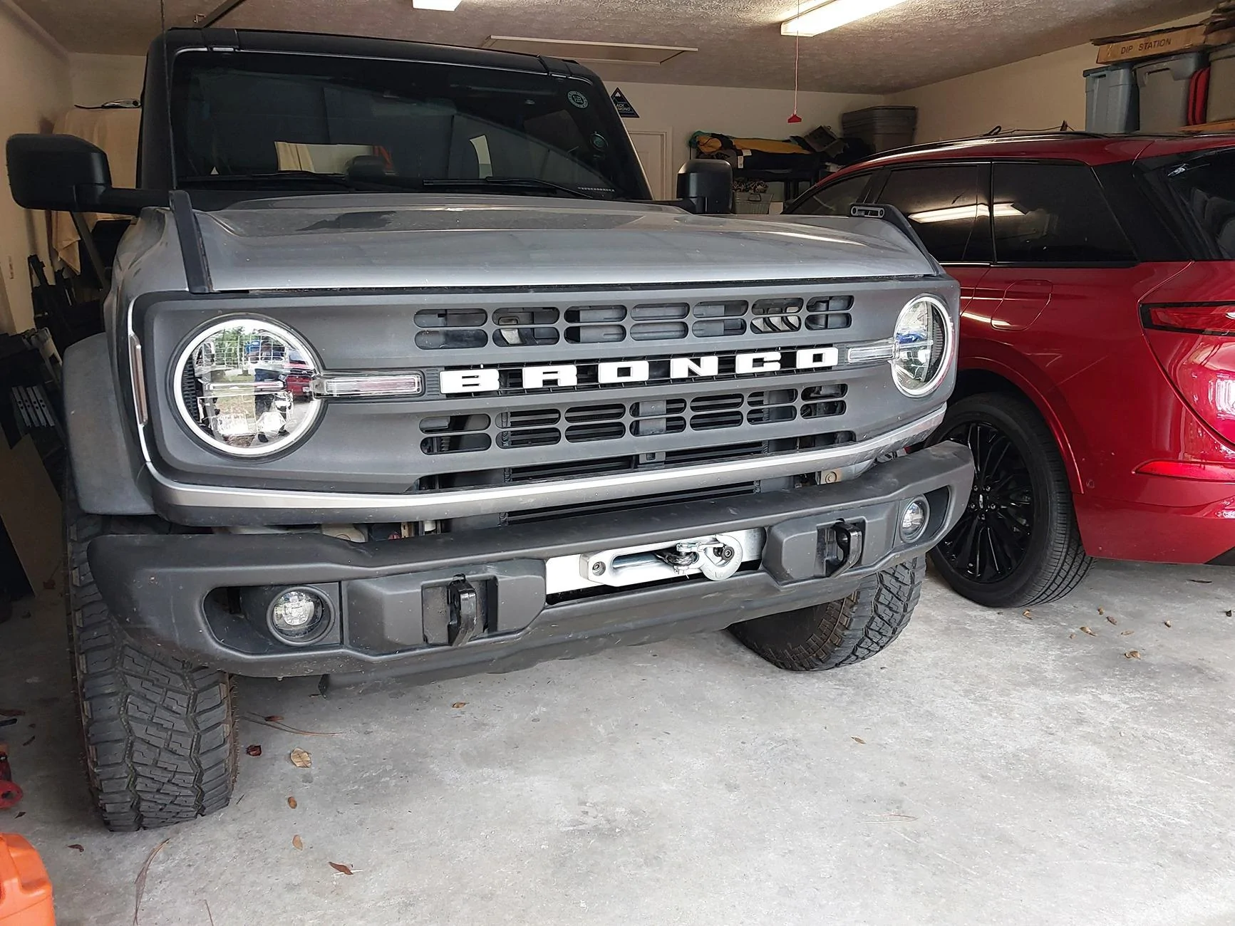

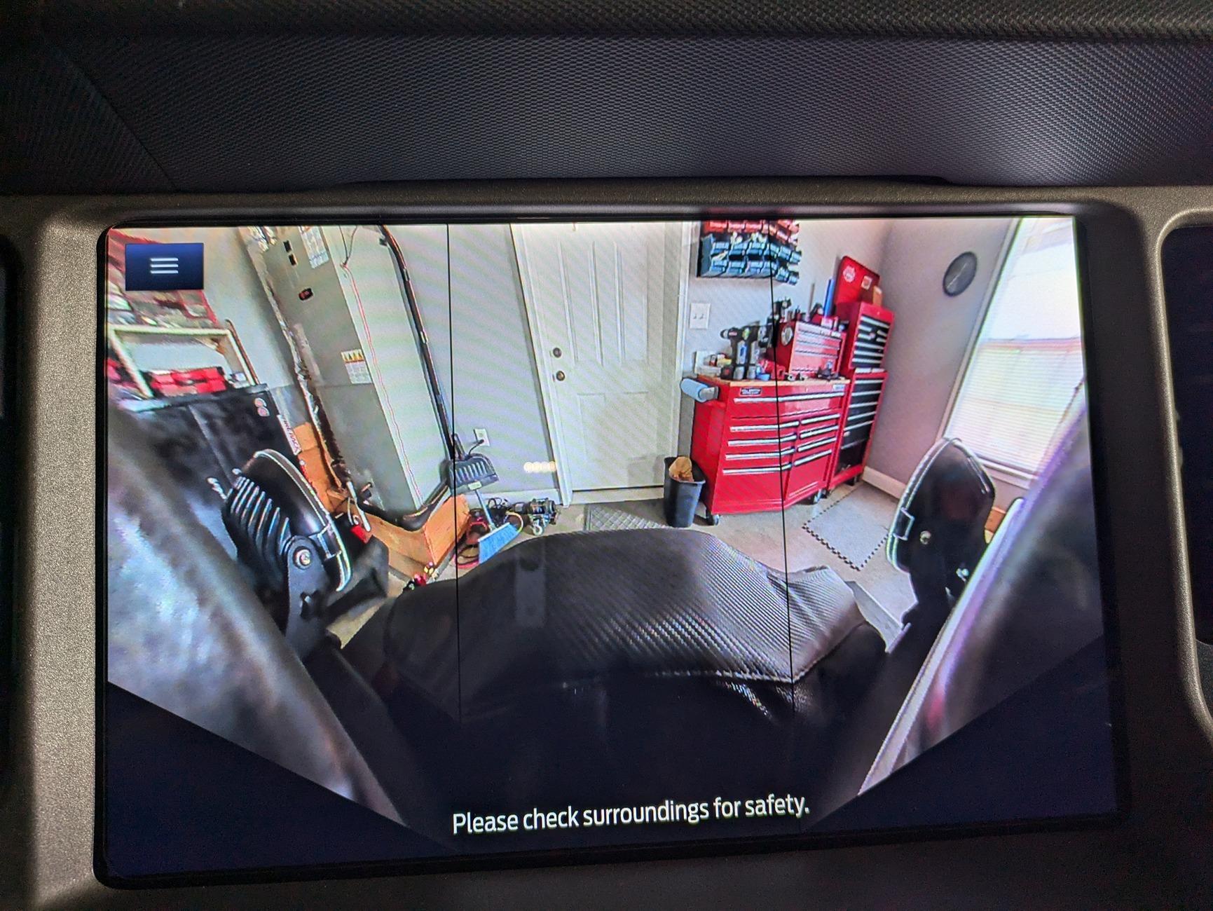

Not bad but like I said I have a relocation kit.
Not a bad view at all, even before the relo.
