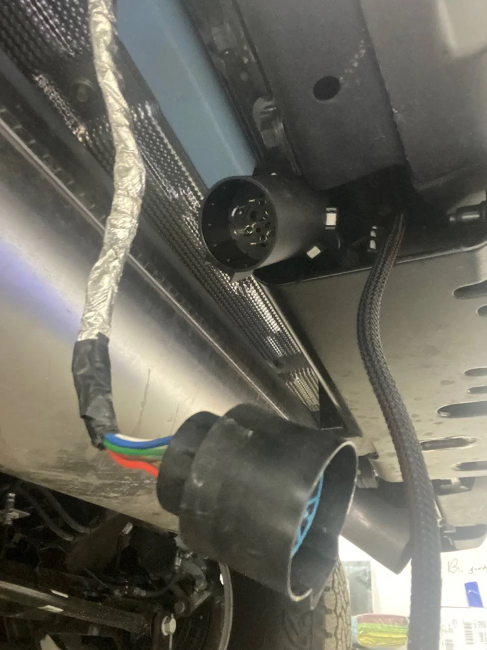

You are correct. The LEDs are integrated and not serviceable/replaceable. So if you want more brightness, then you need to add extra lights.
If you have the trailer tow option, then a hitch light would be the easiest solution. I don’t have this so I can’t speak to how much light it adds.
https://www.diodedynamics.com/hitchmount-led-pod-reverse-kit-for-2021-2025-ford-bronco.html
Yeah you don’t want that with a capable rear bumper. I tried it and the wire harness and extension plugs end up hanging exposed right in front of the muffler. No room to stow them inside the receiver mount and it will either be visible from behind or rub a bumper nut if you try and tie it up high.
