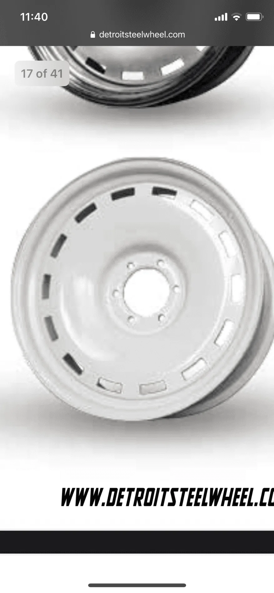

Not sure, probably arctic white. I need to look at his swatches. I think I Decided in these wheels so I’ll probably try to match the power coat.

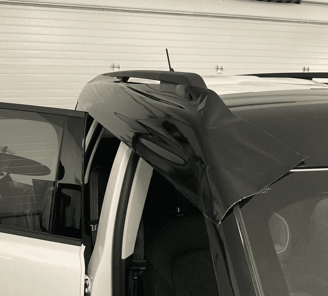

Early on i had a talk with my wrap guy the hinges and some of the other design features could be an issue .
I could plastidip small areas like hinges, i could also cut seperate pieces to create the design im going for as well we will see im def doing it though ,even with my late avail options.

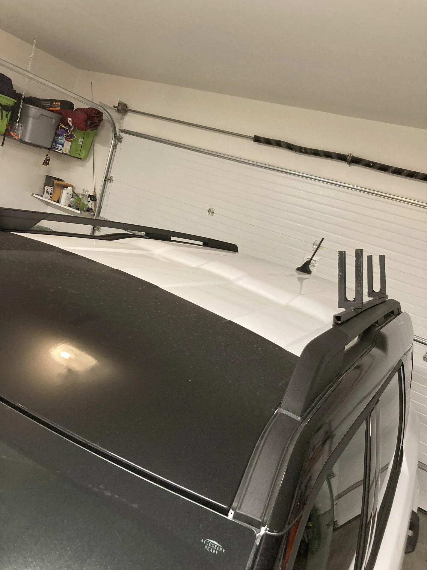

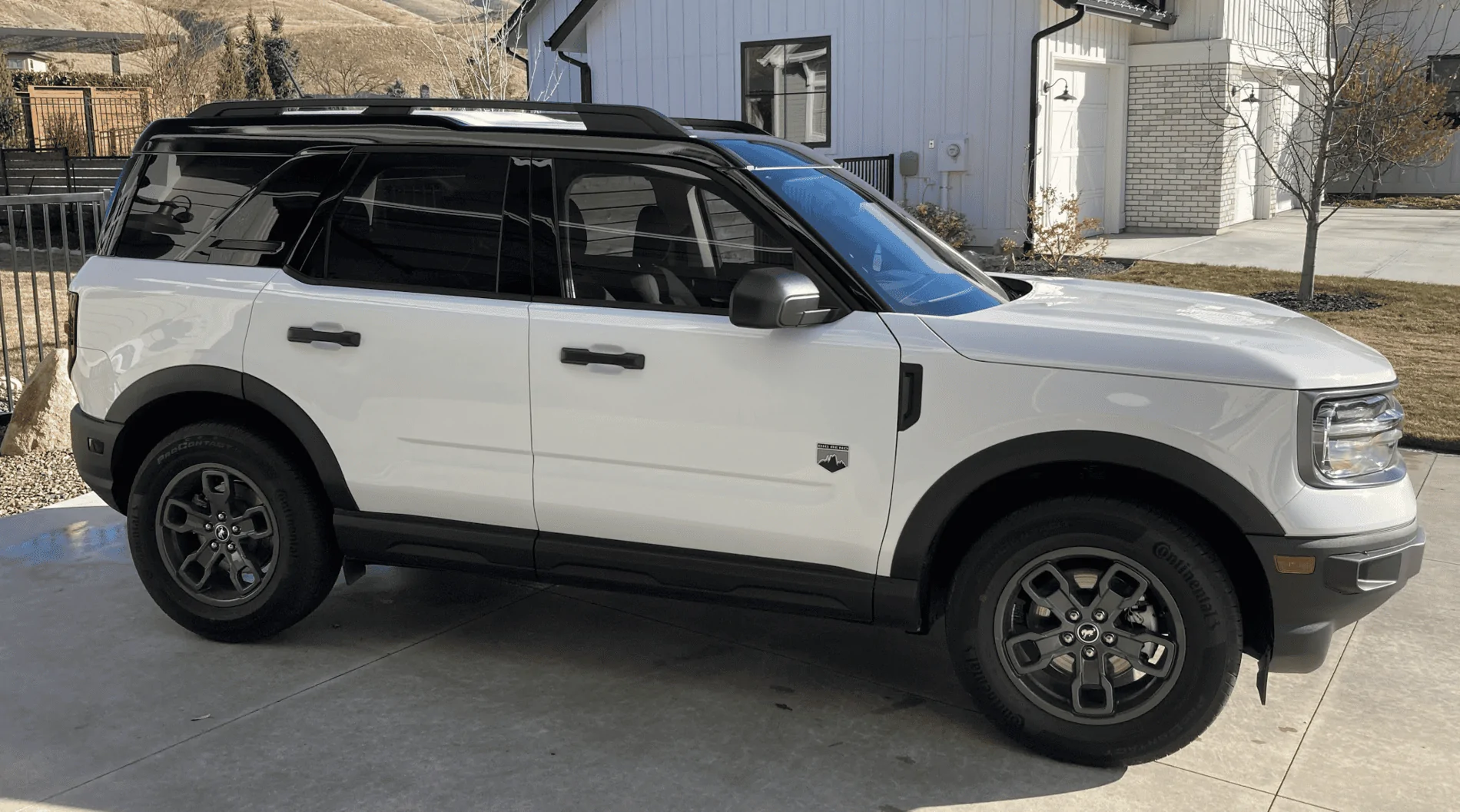

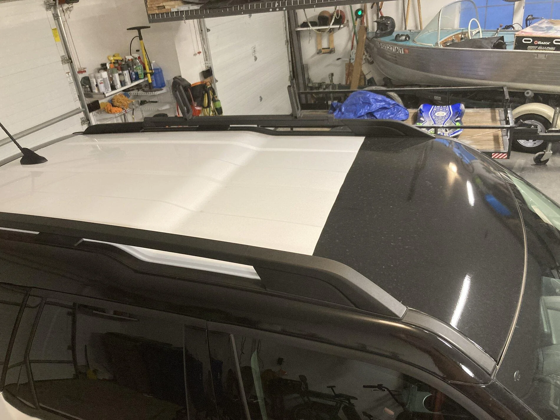

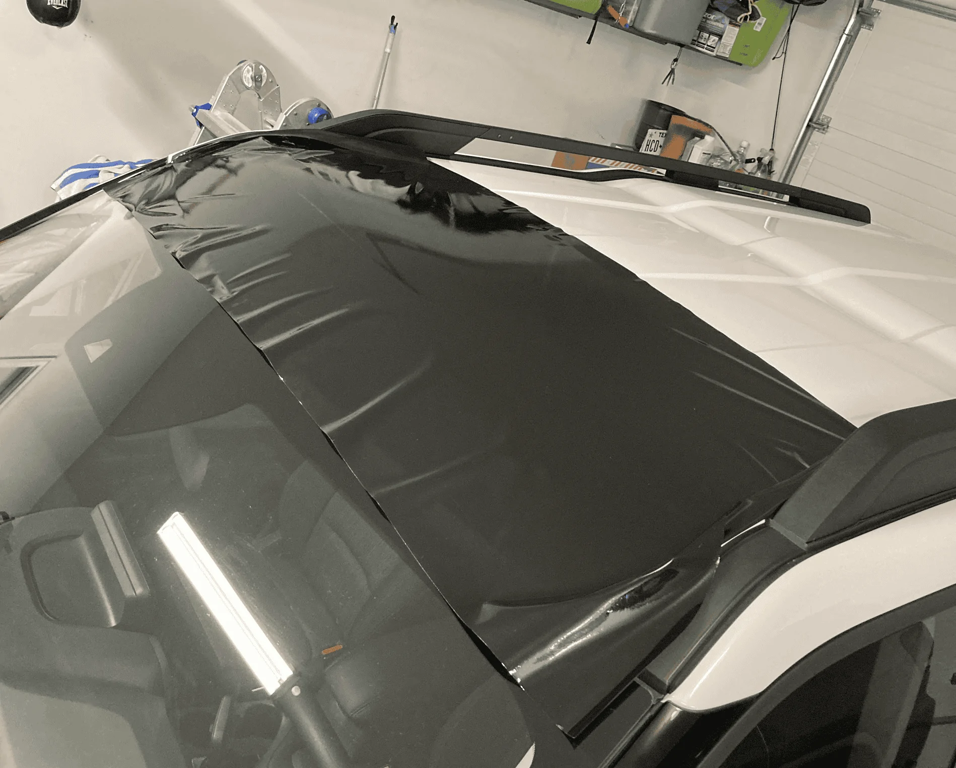

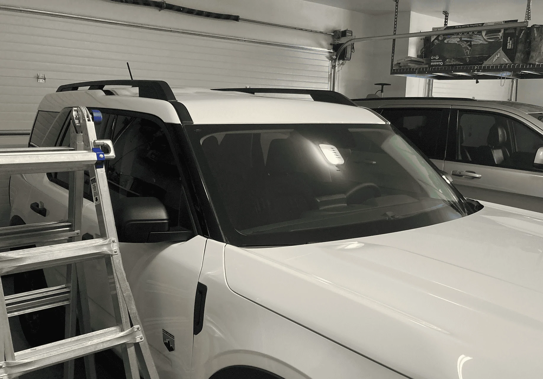

I'm considering a wrap (self wrap) as I did my wife's bronco sport upper. Wrap similar to my profile photo here, but i'd consider plasti-dip spray on the hinges. Something that if it looks bad i can just peel off and do a wrap instead. I think the hinges in a flat black would work as a nice contrast color. I'll probably post a video of how to wrap and what it takes. I havent done the full calculations yet as I have not seen, nor measured a full sized bronco but thinking about $500 in materials to do the work(vinyl).
The best part is, you can remove basically every panel, so i can toss on the dining room table and wrap in the comfort of the house once piece at a time .
PS...i've only ever wrapped once (on baby bronco) and surprised how easy it was
(note this is not a badlands that has the painted top, it's wrapped from windows up... you can see i didn't do the top of the roof, just about 24" past the windshield
(not pad for $117 vinyl and about 3 hours of work)
Basically what i'm saying is do it yourself, tons of you tube videos out there, and take your time.
Spend $50 on some vinyl and just do one door or one fender and see how it comes out. If you are terrible at it and have no patience then pay someone else to do it for ~$3000...if not, do the rest and save yourself some $$$. Plus at anytime you can decide to just "change the color" or do a repair if you get a gnarly scratch when on the trails.

Looks great!
Can you show us a topdown view of the finished product?
