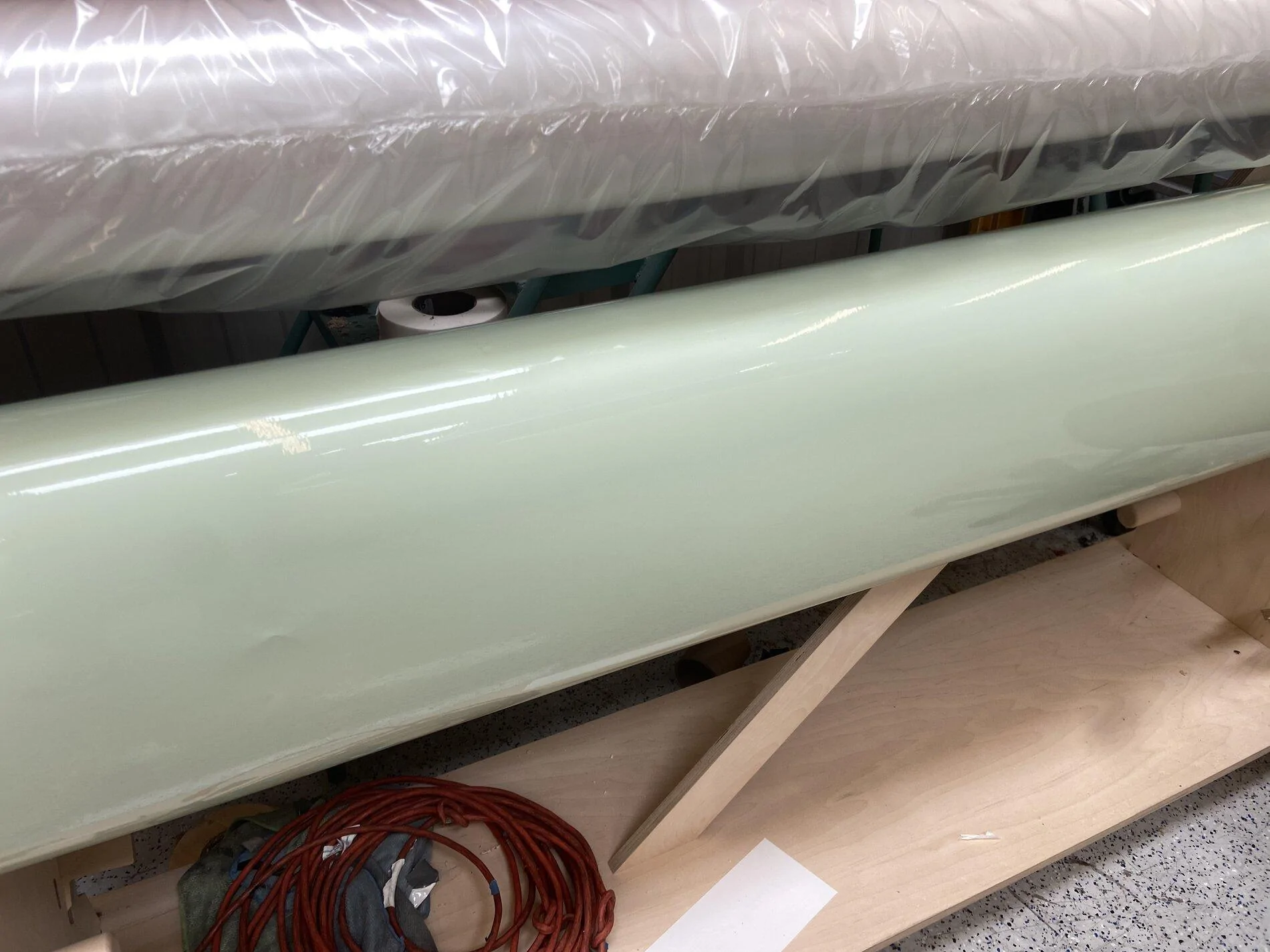

We’re wrapping our Bronco the first day we get it. (4dr Badlands SAS Lux) Infact, the vinyl came in today. (See attached pic). We’re wrapping it in Avery Gloss Light Pistachio. It’s very close to the original 1960’s light/pastel green.
We chose to order ours in Onyx Black. Strictly because Black is the easiest color to wrap. And we didn’t want any of the factory colors. Black plays a trick on your eyes and you don’t see it. Think black molding. It’s just not something you notice.
I’ll be doing the jams because of how easy the doors come off. Door handle removal is the same as the new F150, easy. Fenders flares obviously remove easily as well. So does the grill. It’ll be an easy install. I am planning on doing clear bra to the door jam area so it’s protected when you get in and out. (Yes, clear bra can go over vinyl wrap)
As for the rear hinge. I’m going to leave it black. You’ll never notice it, especially with black handles and black mirrors, black roof and that big black 35” rim & tire on the back. No one will be behind me at a light and say “Look, the hinge isn’t in the same body color.” No one. Now, if you have any color but black paint and you wrap your Bronco, then yes, absolutely you’ll see the contrast and it’ll look like dig meat. For example, your wrapping your rig in Satin White and the paint is blue and you leave the hinge, then yep, it’ll look like junk.
If you plan on wrapping. Order Onyx Black. The rear hinge can absolutely be wrapped. It’s no biggie. What you can’t wrap is inside the star head bolt. The quick way around that is to wrap it all. Then mask off the bolt and spray black plastic dip inside the star. It’s how it’s done on Jeeps. Again, black hides everything.
If you guys have any questions, ask away and I’ll answer them.

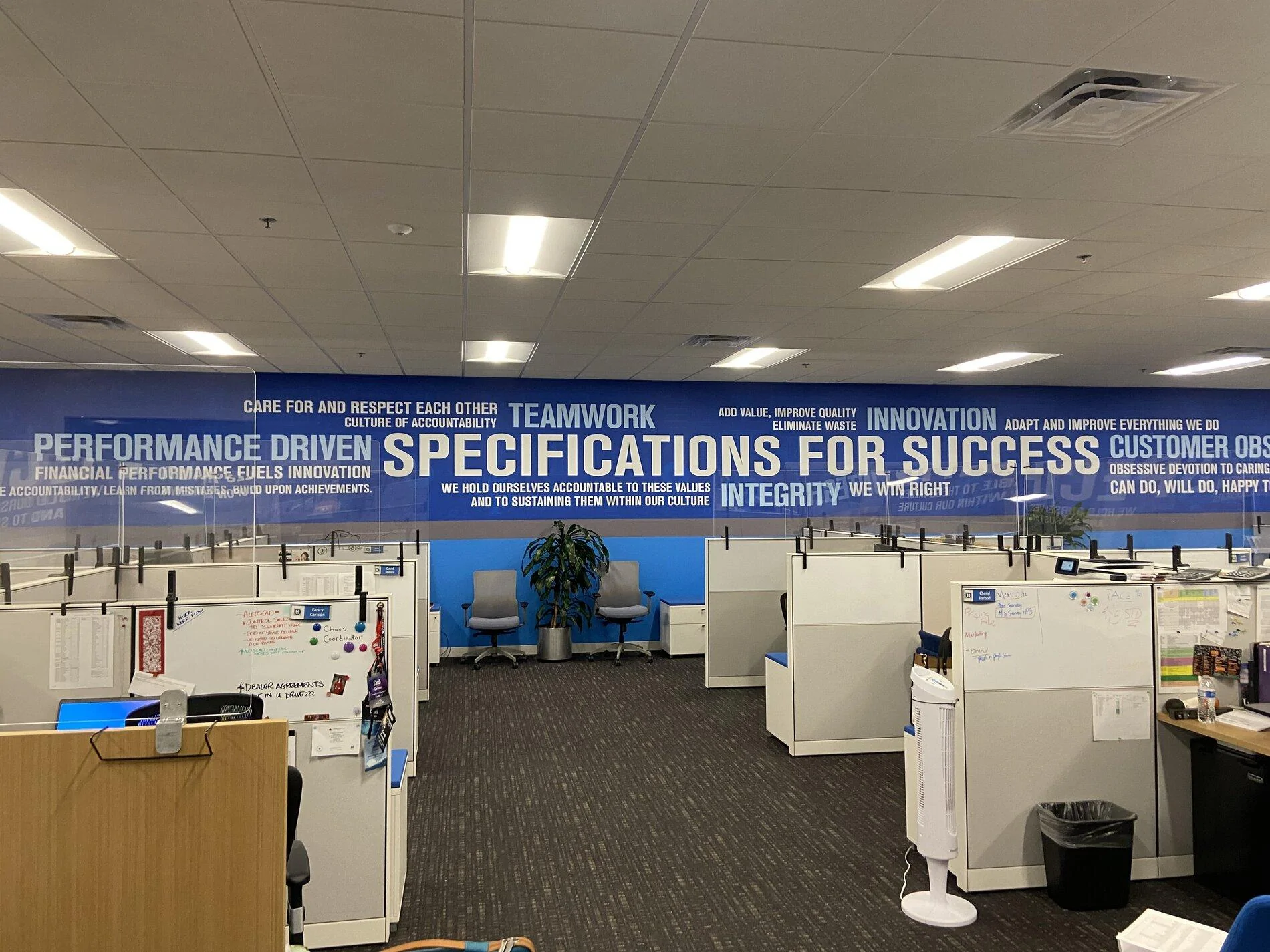

Yes. Walls. Big and flat. Get paid by the square foot. Giant 12” squeegee and it goes down easy and fast. Office walls, barricades, etc. I’m part of a national team that is rebranding Walmart stores. So I fly all over the country and install. Believe it or not, some stores we wrap the exterior of the building in vinyl. 4,000-5,000af at a time. I also install wall wraps at resorts here in Phoenix for trade shows and events. They’ll decorate the whole place with graphics all I over the walls, have the show and then we remove a few days later. Money is incredible. Or I can wrap a car that takes 2-3 days. Requires me to bend over and get in weird positions. Be intricate with a knife and trimming and get paid a fraction of the price.after 2 back surgeries, I’m getting to old to wrap cars every day. LOL Plus the big money is in the flat stuff.
I’m 100% a mobile installer. I don’t have a shop. I drive around in my Transit Connect and install vinyl. All day. Every day. Super low overhead and don’t have to deal with retail customers. All my stuff is commercial installs. In fact, I don’t even have a website because I don’t deal with retail.
Heres a basic 300sf wall wrap for Hayward Pools headquarters here in Phoenix.
