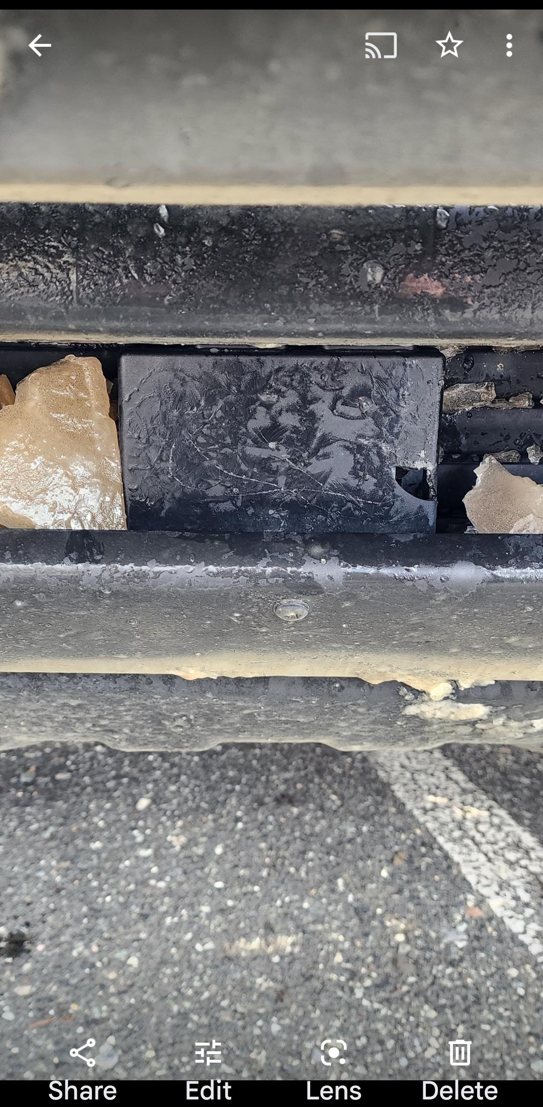

This place has been so helpful, appreciate all the threads. The plastic cover for my variable cruise control is cracked. 2 questions for the experts: 1) I can't locate the part for just the plastic cover. Anyone know if this can be ordered without the whole unit? 2) I can't seem to pop it off, perhaps I need to remove my modular bumper to release it? Can someone confirm this for me before I take the whole bumper off unnecessarily.
Thank you.

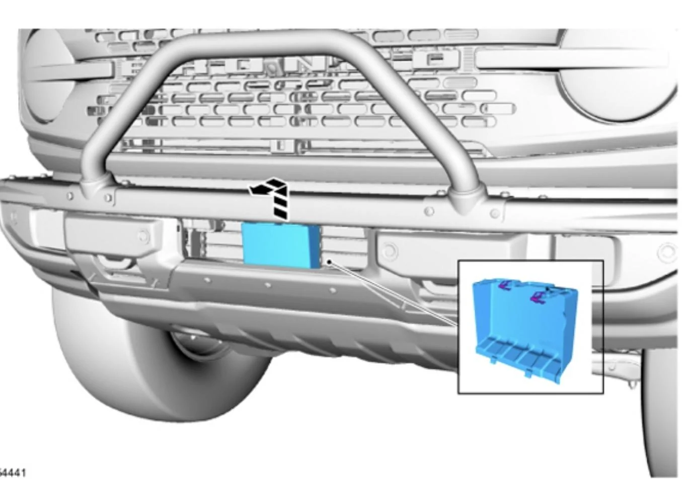

M2DZ-17E811-AB
There are clips on the top side, then it looks like you can remove it. So you probably just have to pull near the top of it decently hard to release them.

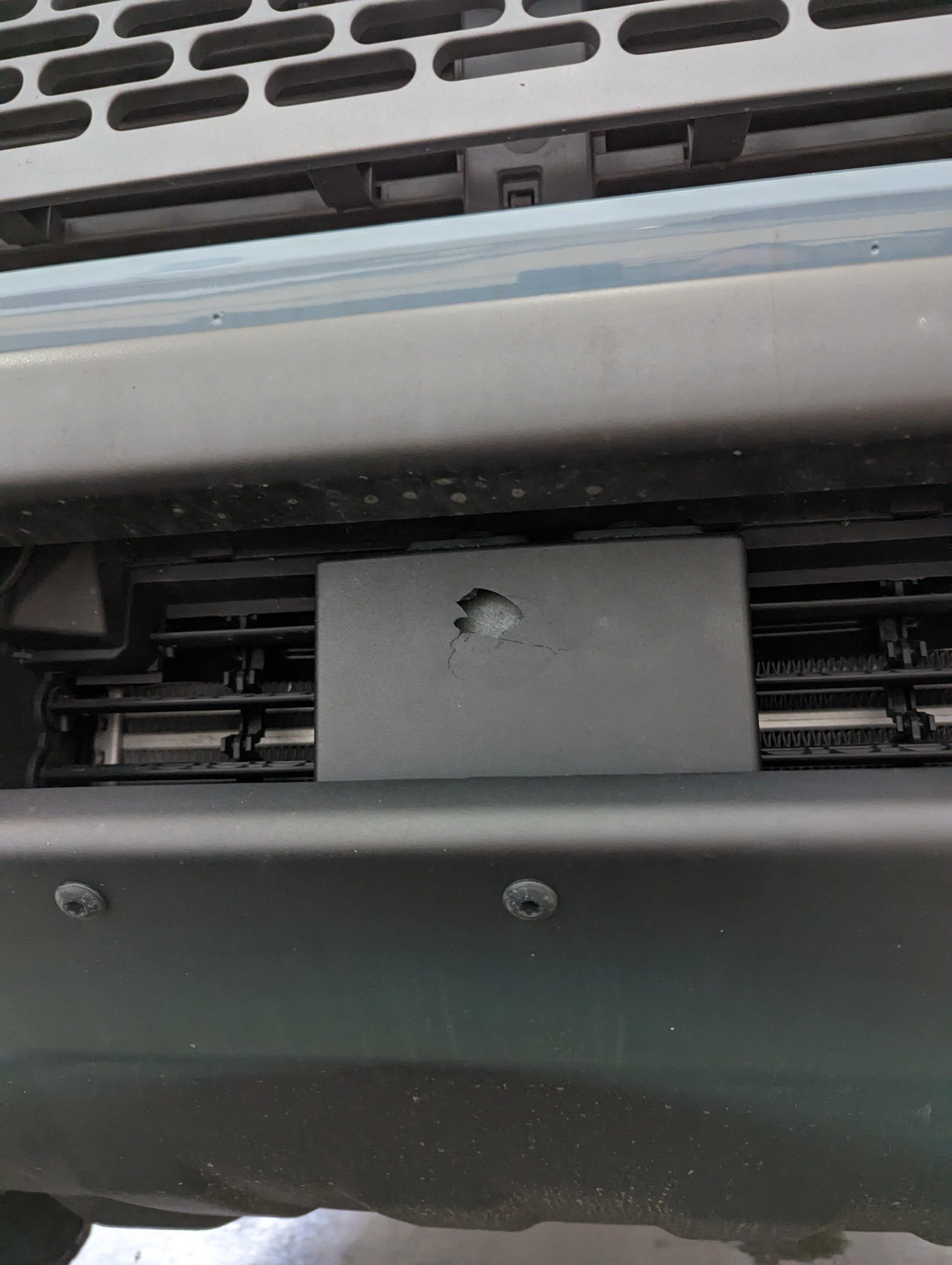

I forgot i broke mine during Christmas!!

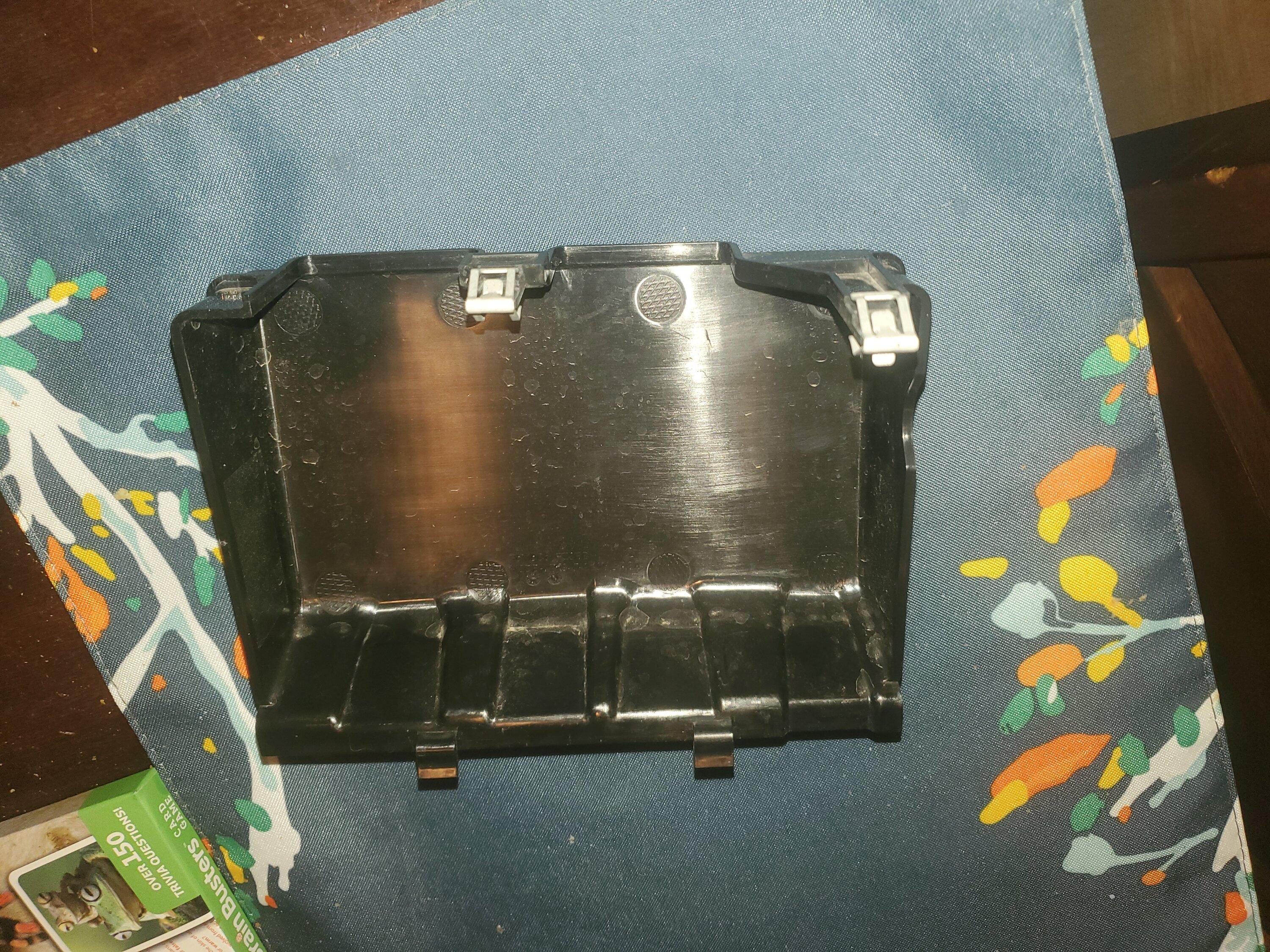

This is what we are talking about right?
