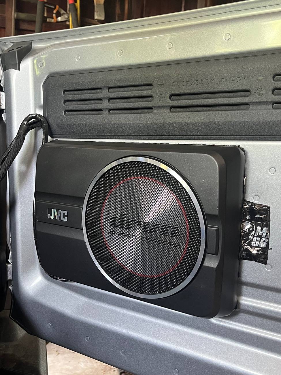

I replaced all my speakers with focal fronts and kicker rears and lower fronts.
for a sub I mounted this little JVC unit. Not gonna be thumping bolts loose but it definitely rounds out the sound nicely.

What about an amp? Stick with stock?
I kept it stock. I’m sure it would give me more power but I haven’t felt the need for it. Top off at highway speeds and I’m rarely over 14-15 on volume. If you like it real loud with big bass I could see maybe adding an amp. For me this is perfect.
