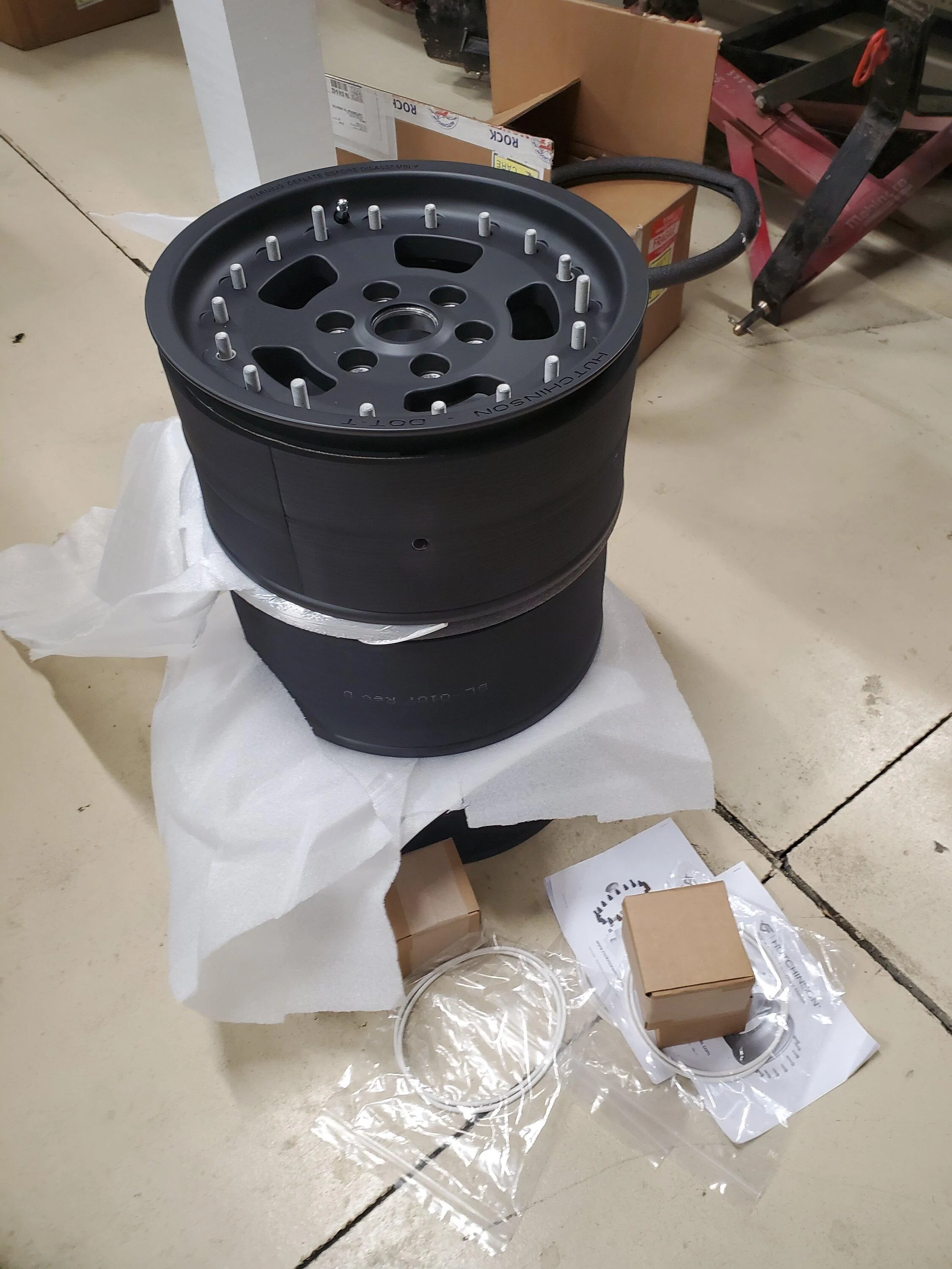

Swampers being as thick as they are this turned into a real job!!
Ford Bronco Valhalla's Long term build thread 20230405_232910
Ford Bronco Valhalla's Long term build thread 20230405_233818

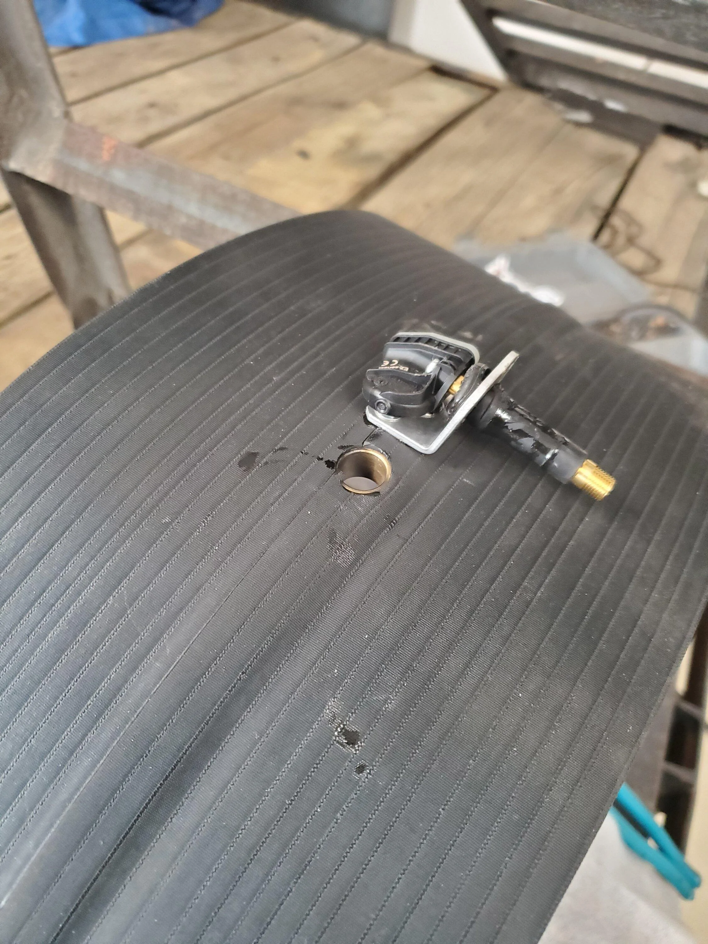

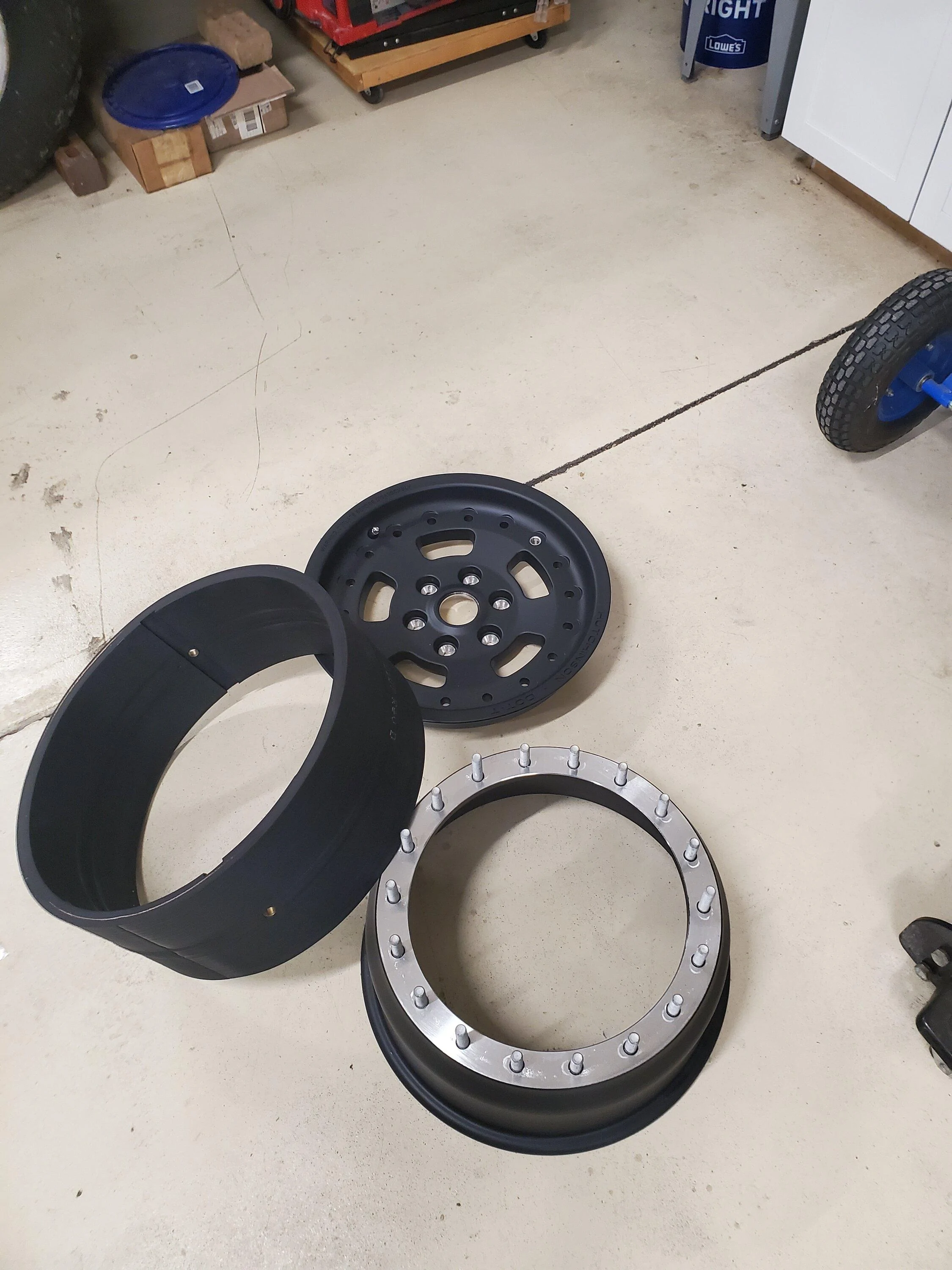

You separate the pieces and attach a bracket for the TPMS to the beadlock center section.
Ford Bronco Valhalla's Long term build thread 20230411_103846

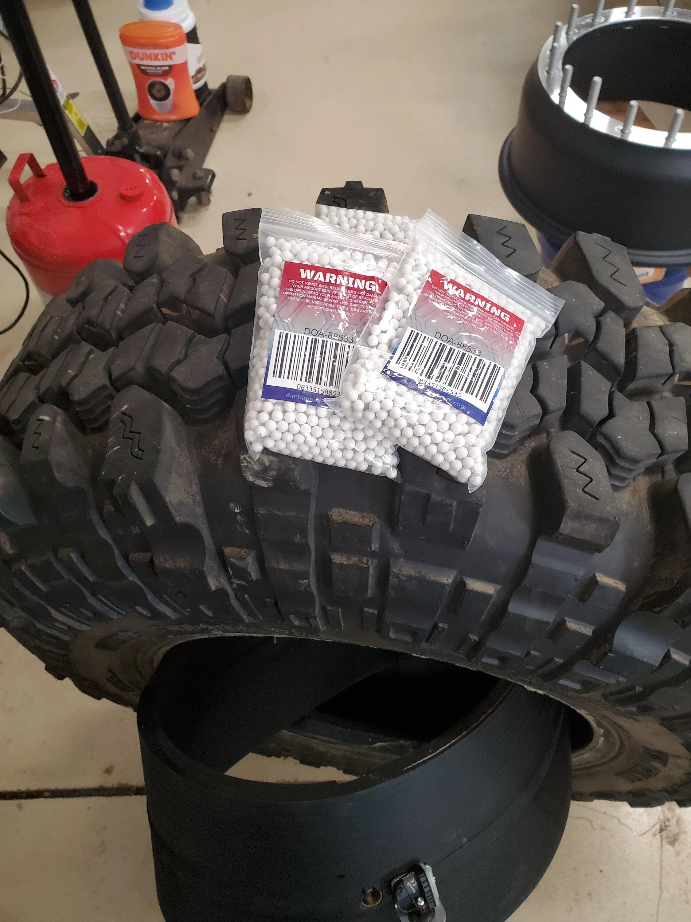

I then put in polybeads to balance the tire. I'm using just under 2lbs of airsoft bbs.
Ford Bronco Valhalla's Long term build thread 20230411_104423
At this point you stuff the beadlock inner in the tire.
Ford Bronco Valhalla's Long term build thread 20230413_121253

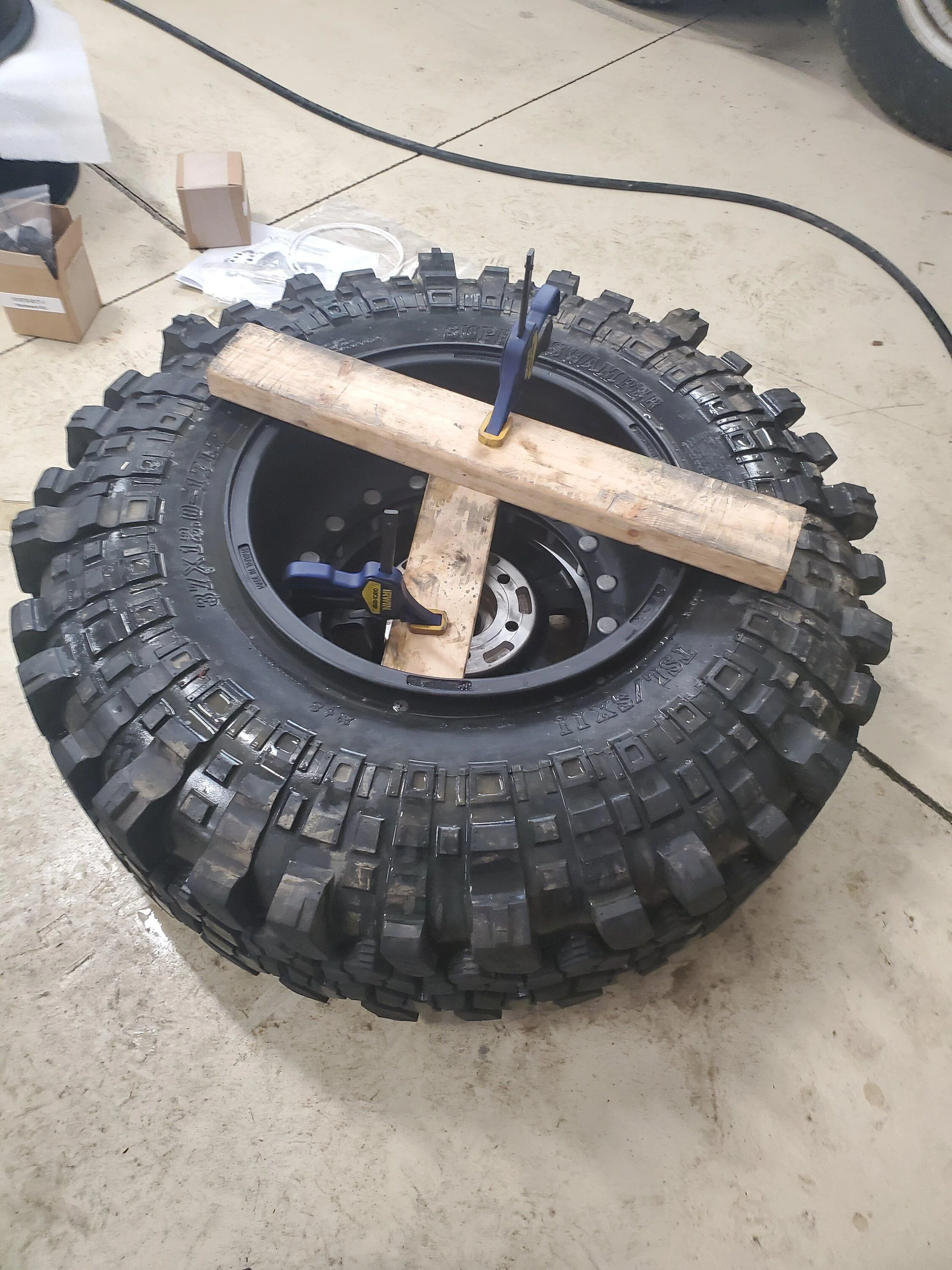

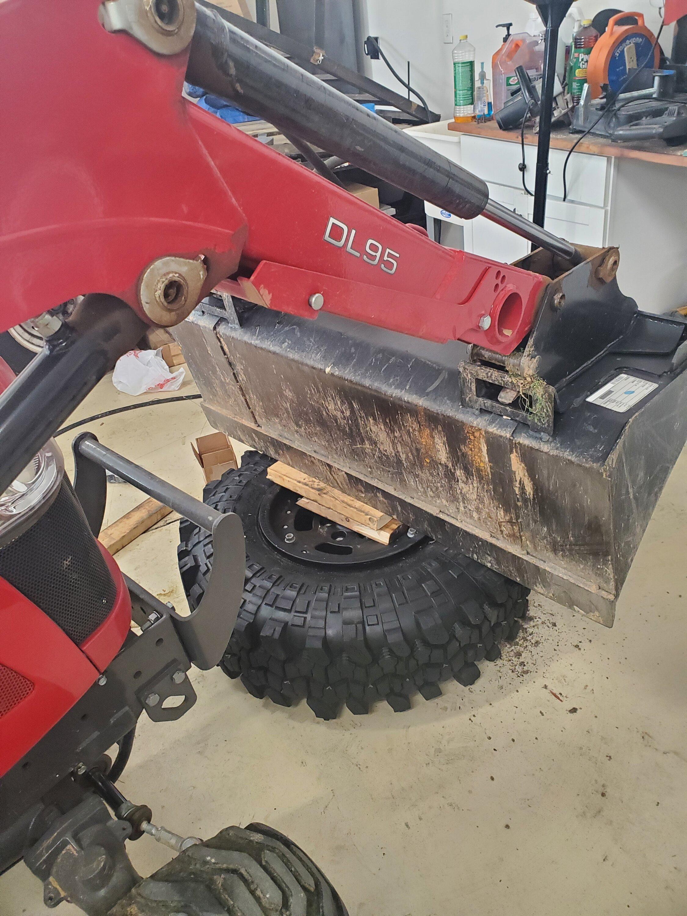

Now the real challenge begins if you are seating swampers. They are very thick stiff tires. I tried rocking them in with tire soap, clamping them in etc...
Ford Bronco Valhalla's Long term build thread 20230418_103142
In the end I had to use my subcompact tractor as my 190 lbs. Was not enough to push the outer into the beadlock inner.
Ford Bronco Valhalla's Long term build thread 20230419_103806

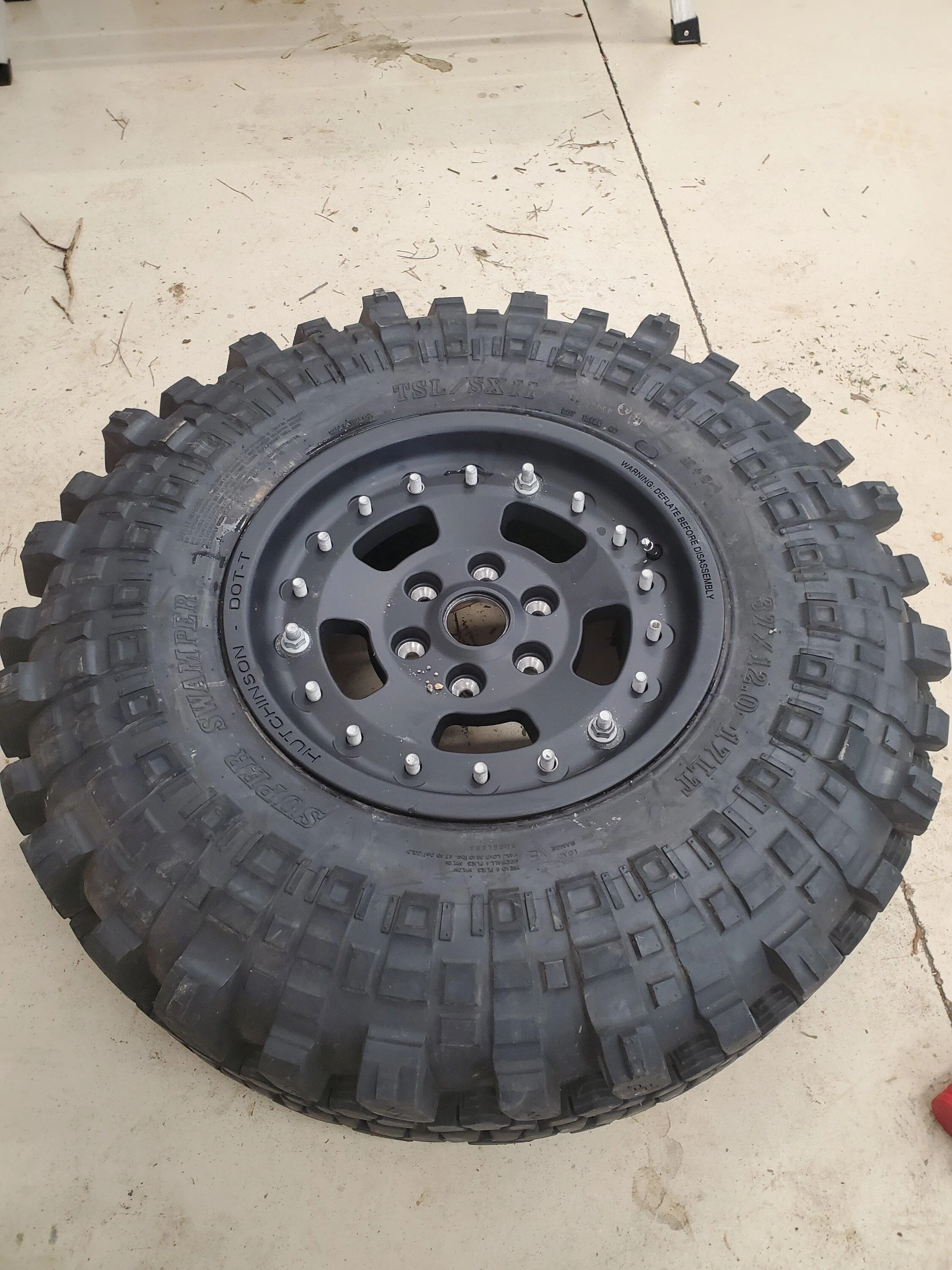

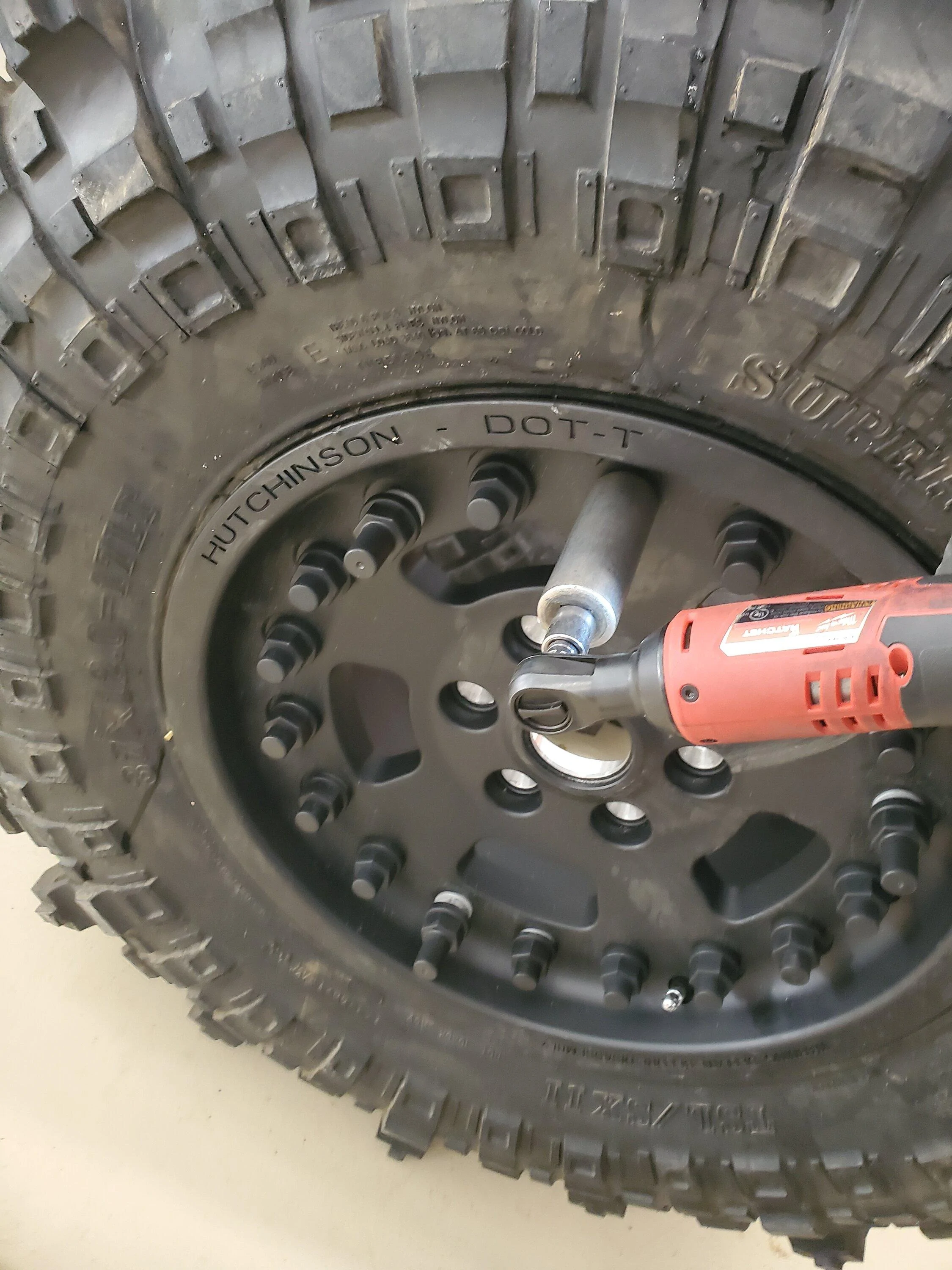

Once the 3 starter lugs are on you are ready to put on the other 15 and torque all down to 100ftlb .
Ford Bronco Valhalla's Long term build thread 20230420_122113
Put the covers on and you are ready to go.

These are a 3 piece with inners and outers I don't think you could use the lighter fluid technique since it would launch the wheel portion! At the point they are down to the 3 longer screws you can start working them into their pattern. I didn't weigh enough to get them that far. The tractor weighs 1500 lbs. but I figure only 500 lbs. is on the wheel.

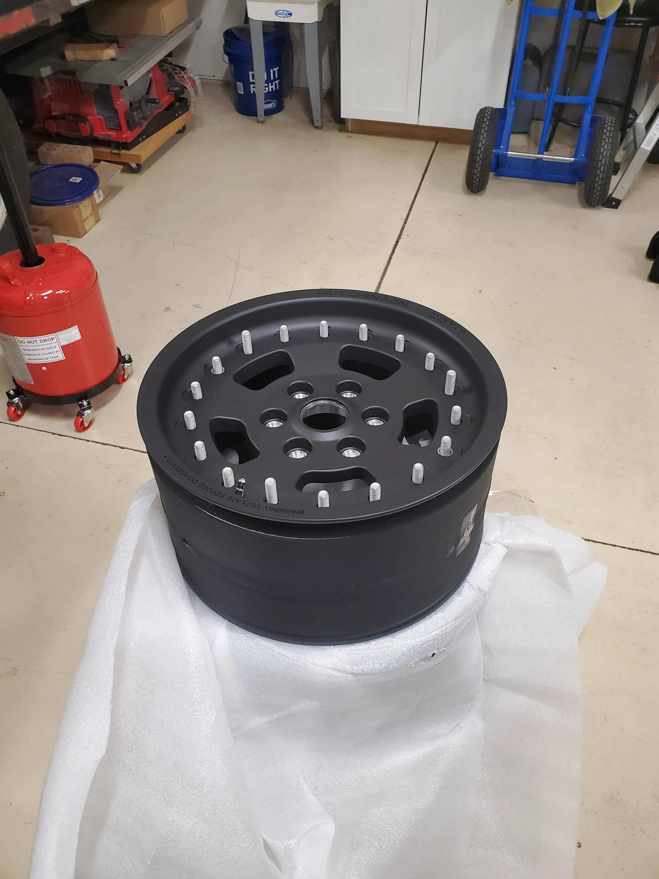

Here are a few more pictures of the wheels and tires, I forgot to mention, the wheel inner seal should be held in place by petroleum jelly so it doesn't drop out. This is not in the Bronco instructions bu is in the ones for Toyota. I used a moly wheel grease.
I also included a picture of soon to come mods.
Ford Bronco Valhalla's Long term build thread 20230425_123812
Ford Bronco Valhalla's Long term build thread 20230425_123831
Ford Bronco Valhalla's Long term build thread 20230425_123853
Ford Bronco Valhalla's Long term build thread 20230425_124042
