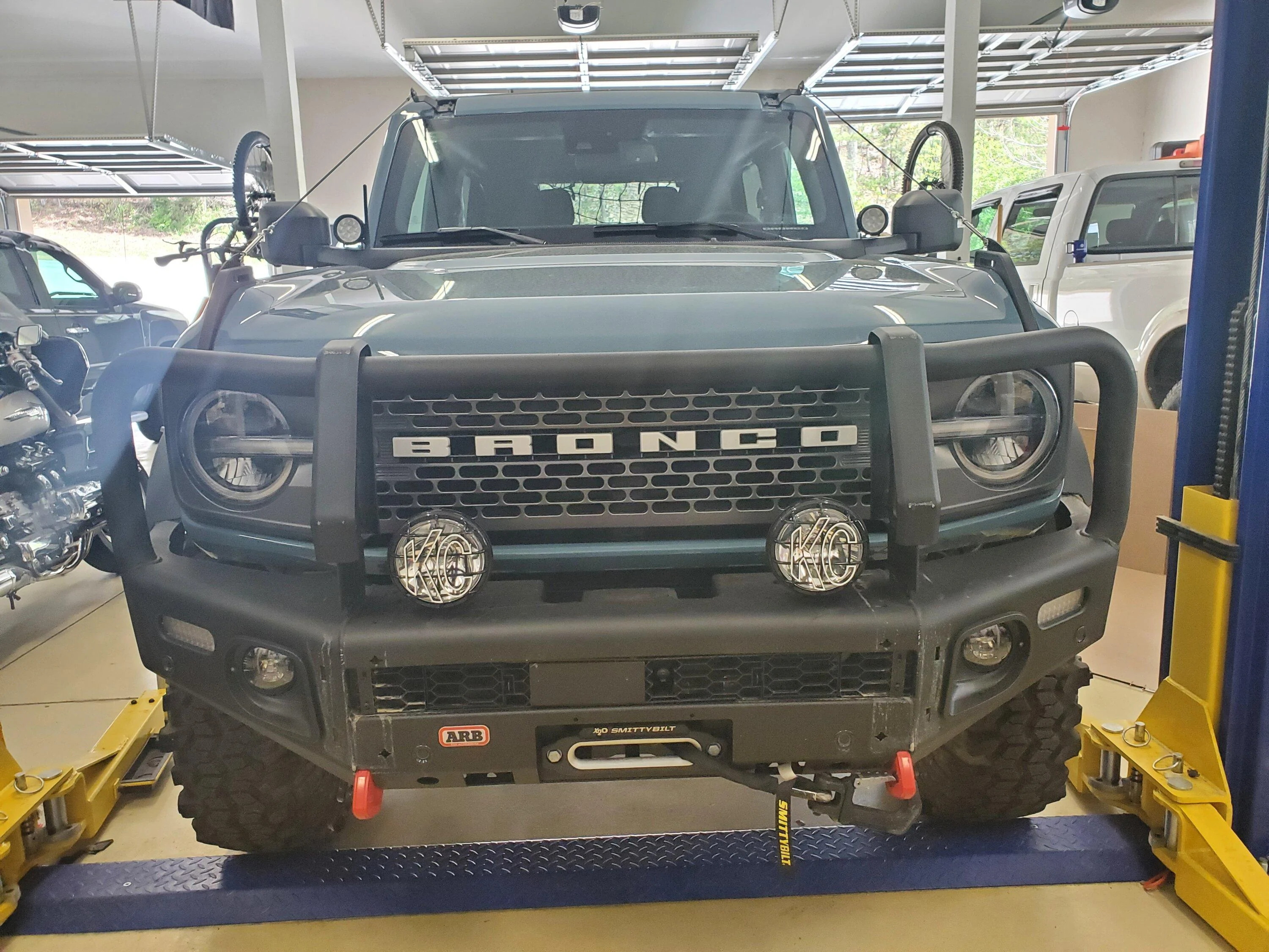

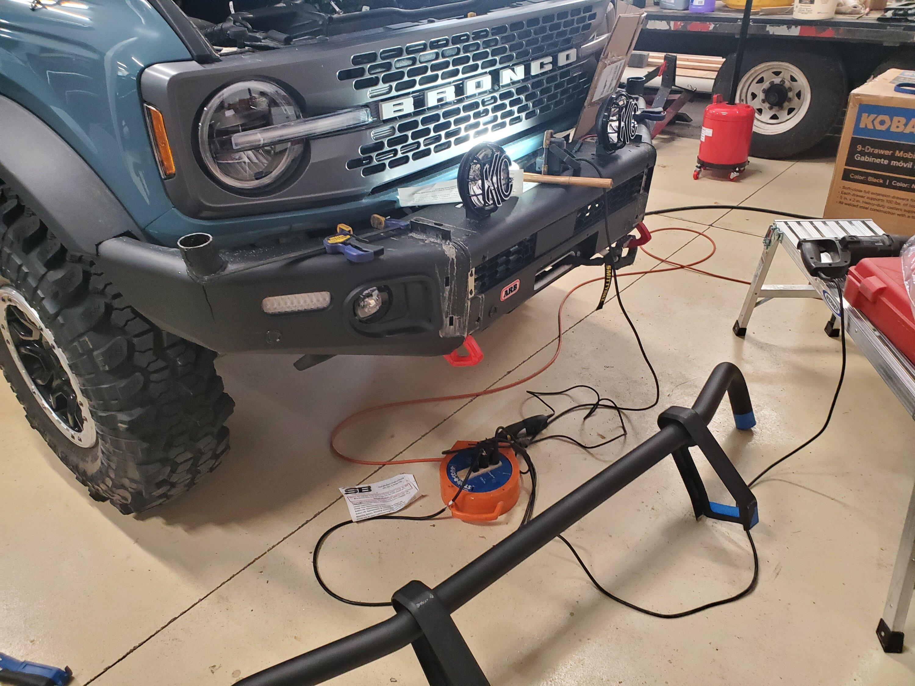

Bumper looks nice. But it seems that the headlights sit right behind the bar after the body lift. You might need to do some fab work and modify the bumper bar to clear the headlights.

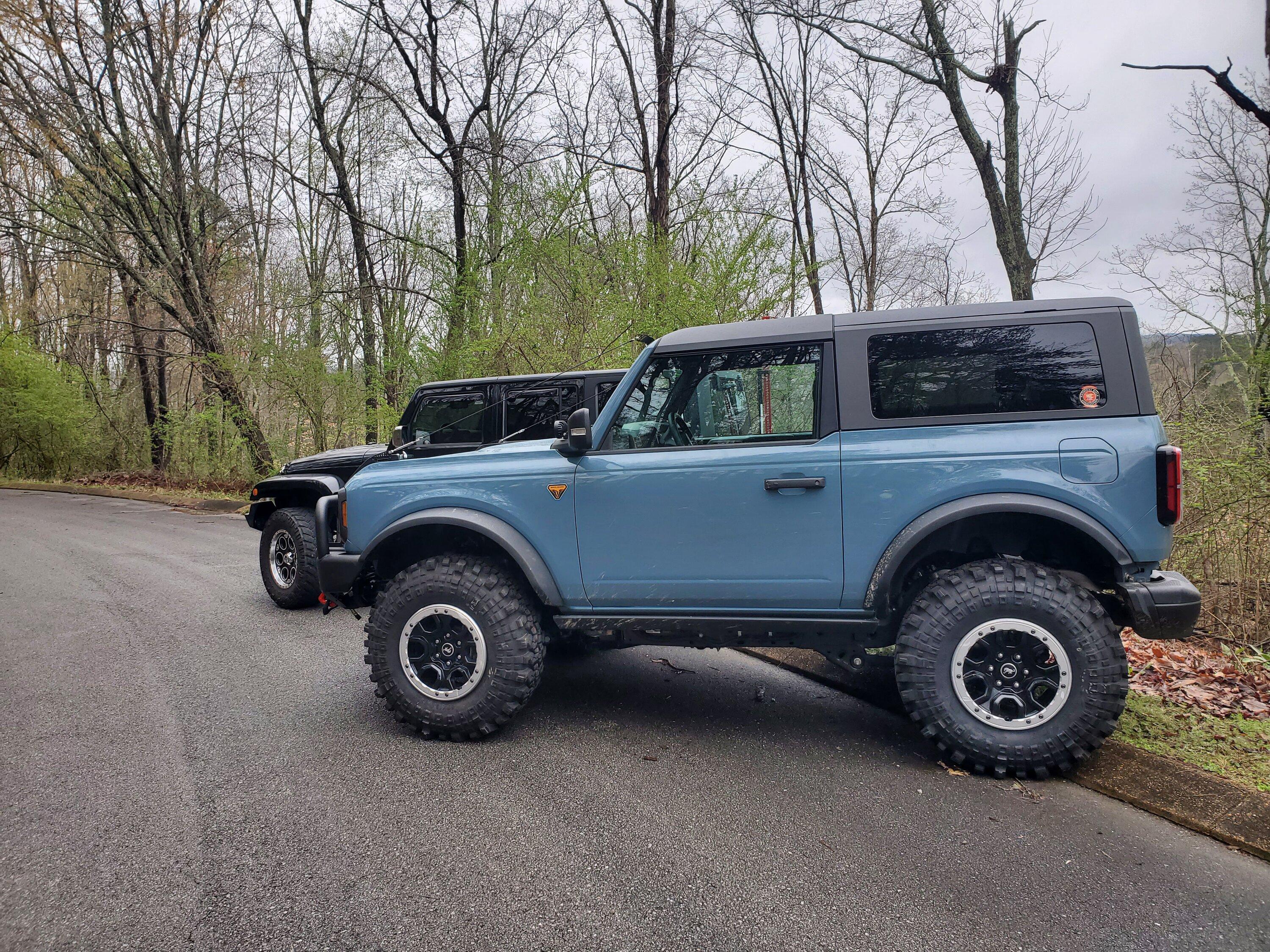

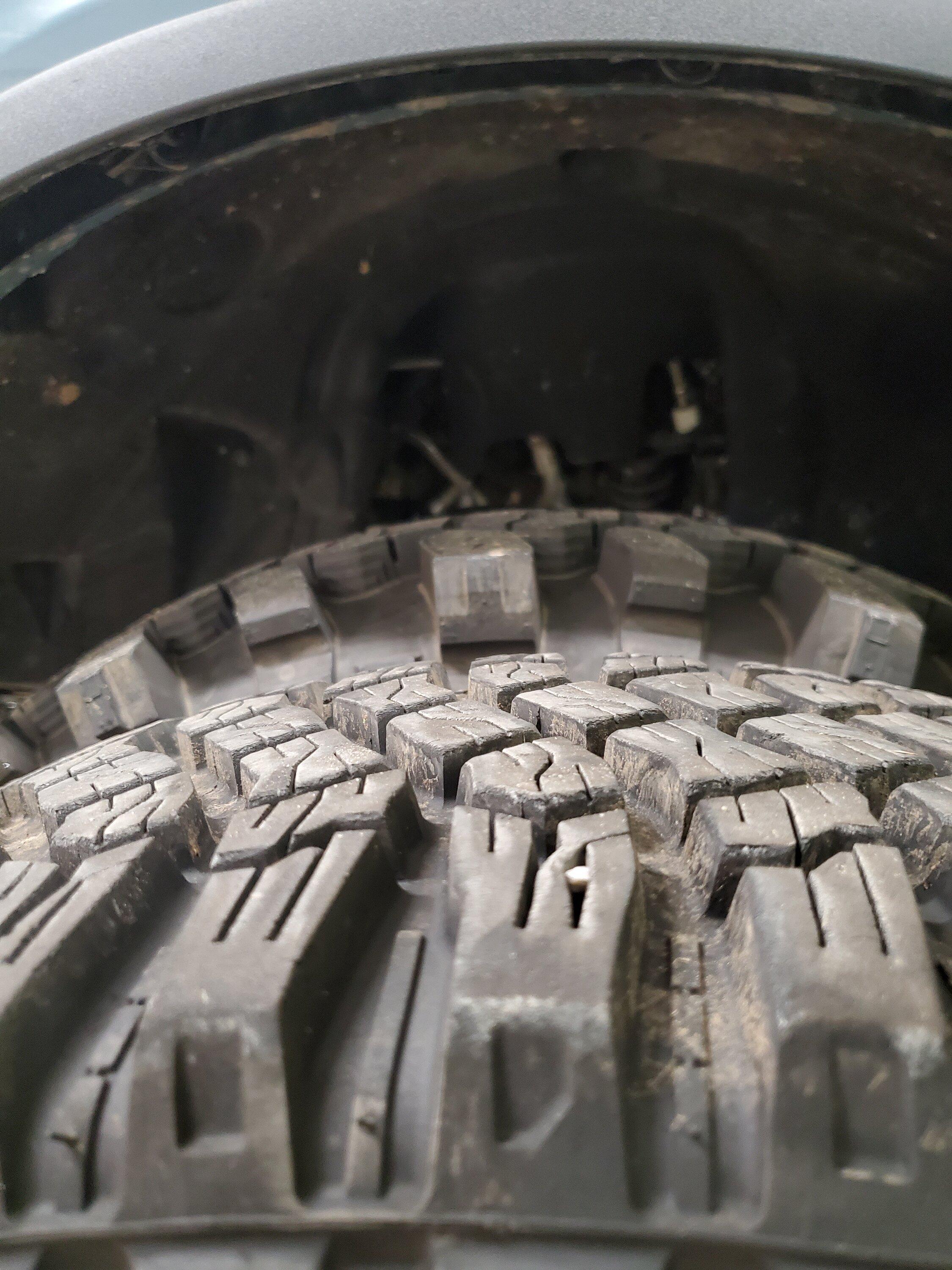

So this is where we are at with my 37 pizza cutters (12 wide) swampers, I'll measure height in a few
Yes sir the plan is to add 3" to the bull bar after the next windrock run, till then I'll survive, wish the rock monster wheels were here, oh well next month then I can run 2 psi....

So at the end of the day I got .5" clearance height for my 4k investment. We'll see how it does off highway later. It is now 3.5" taller.

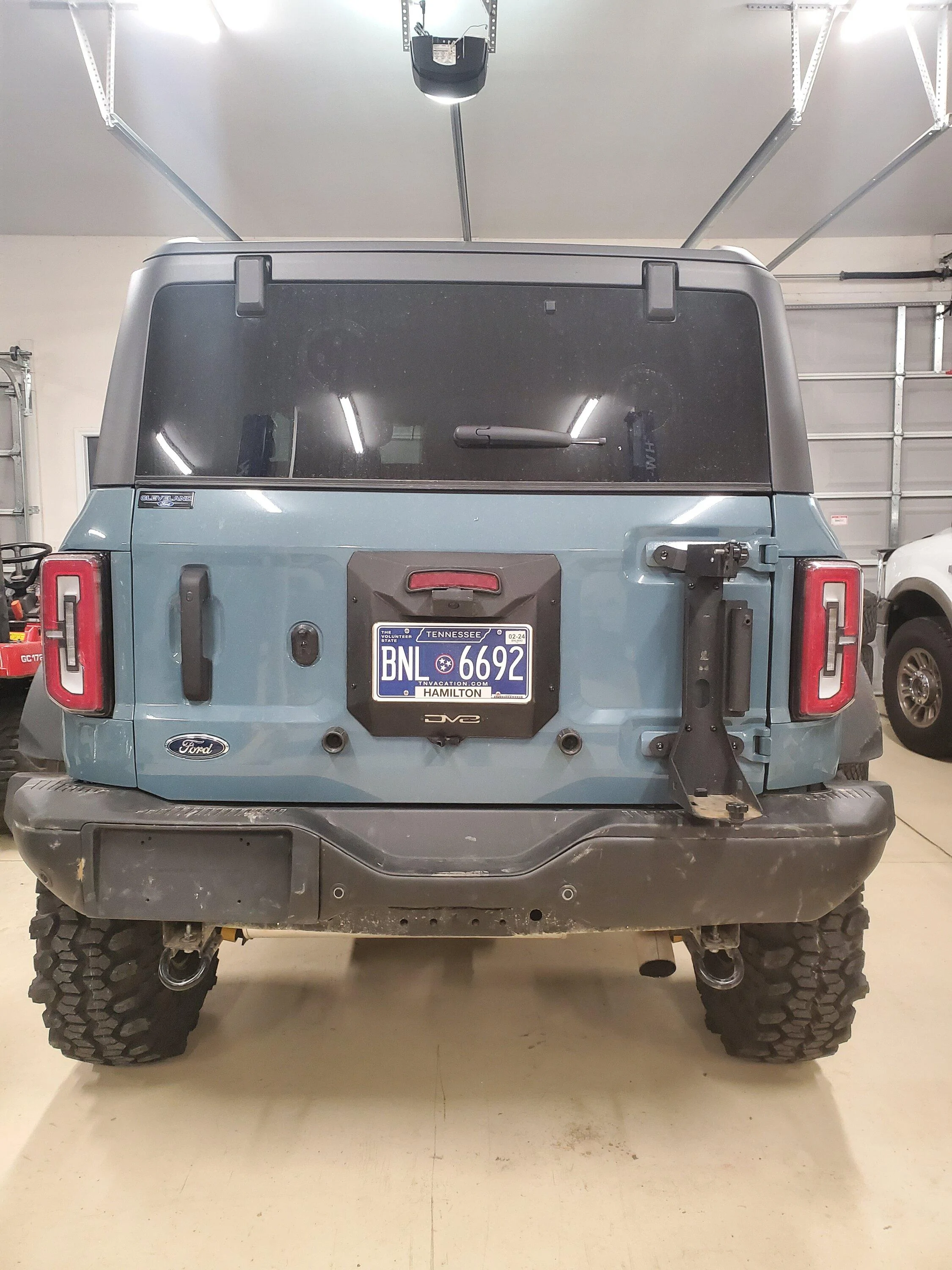

They had only put 34 psi in the tires, I got another full inch of height by putting them at 40 psi, of course I plan on running 15 psi till my wheels get here off highway and then 2 psi. I temporarily fabed up the stock rear bumper until I build one.

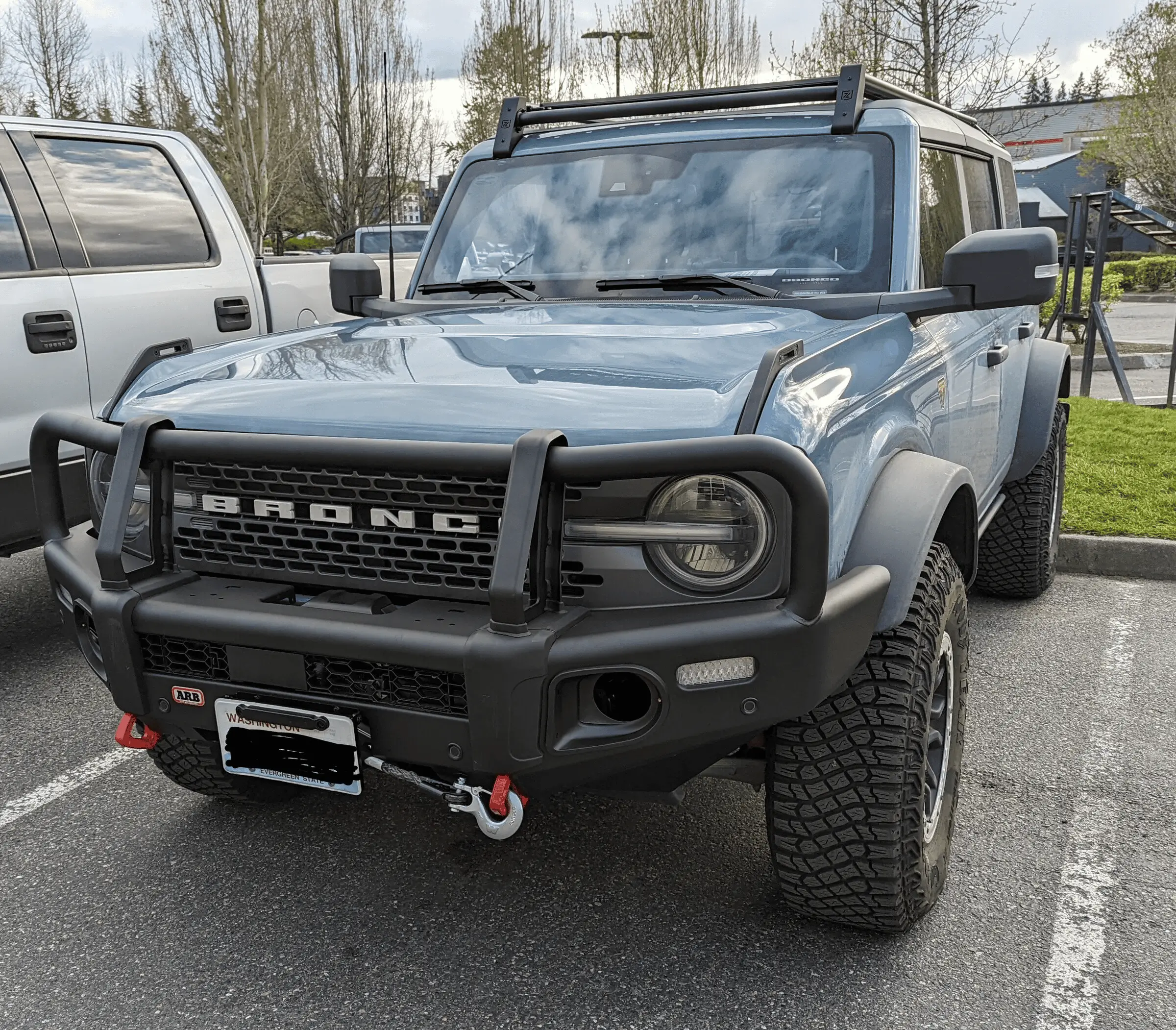

I like it. I am looking at this bumper too. It seems to sit different in these other pics I've seen. Higher up on the hood. Is it just pic angles?

3 " body lift, I'll be modifying my bull bar, the other pics are correct... however if you do the body lift it covers the gap no mod needed, flare trimming required....

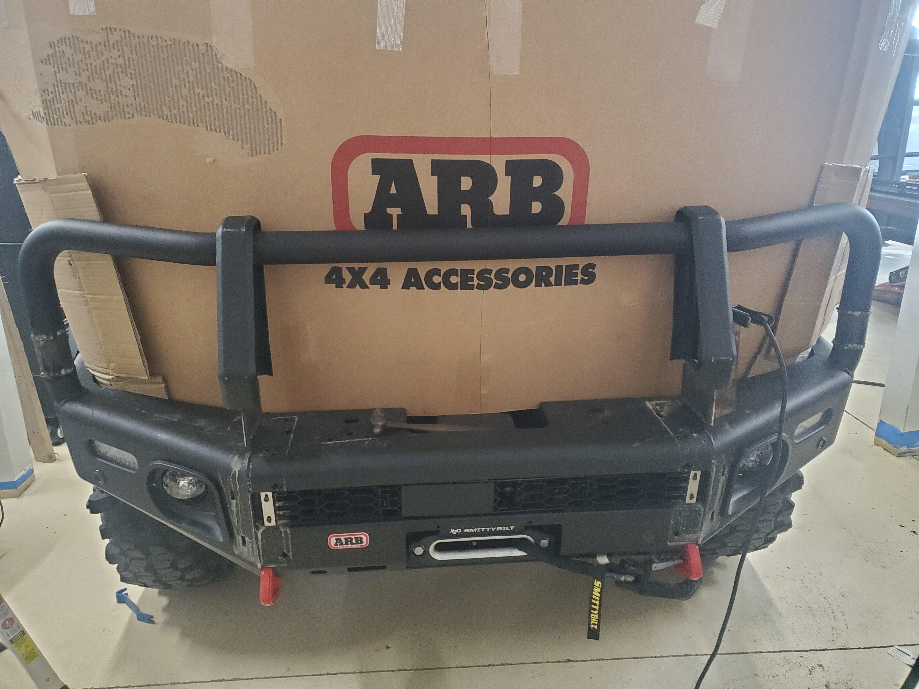

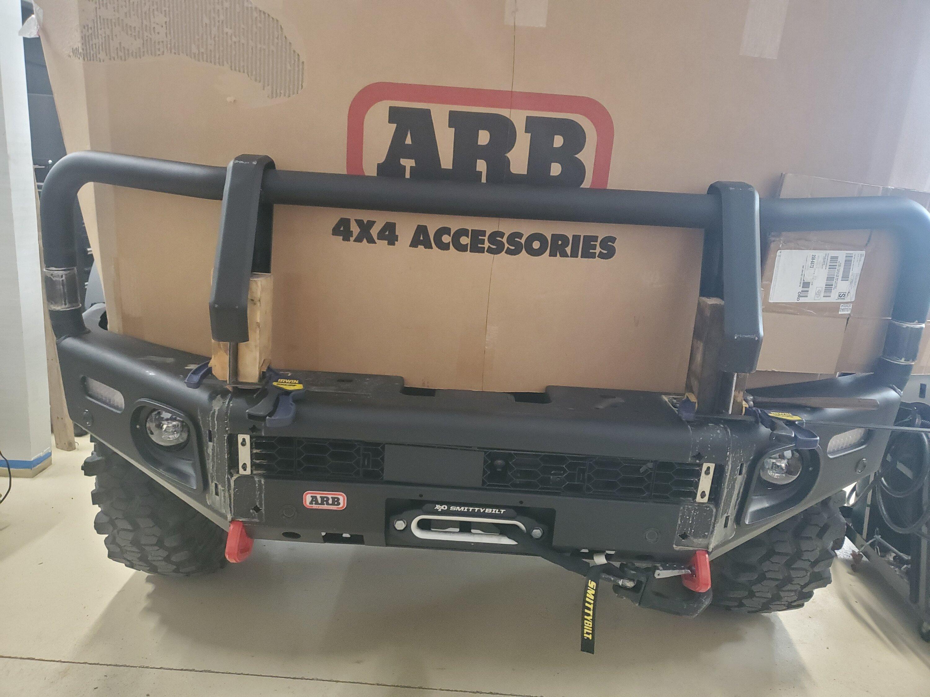

Ford Bronco Valhalla's Long term build thread 20230329_104457
this is the bar sawed off the ARB
Ford Bronco Valhalla's Long term build thread 20230330_110414
This is mached up preparing to weld
Ford Bronco Valhalla's Long term build thread 20230330_124213
mostly welded(I ran out of shield gas)
Ford Bronco Valhalla's Long term build thread 20230401_131547
done for now, I have to get some thin Guage to finish "prettying" it up.

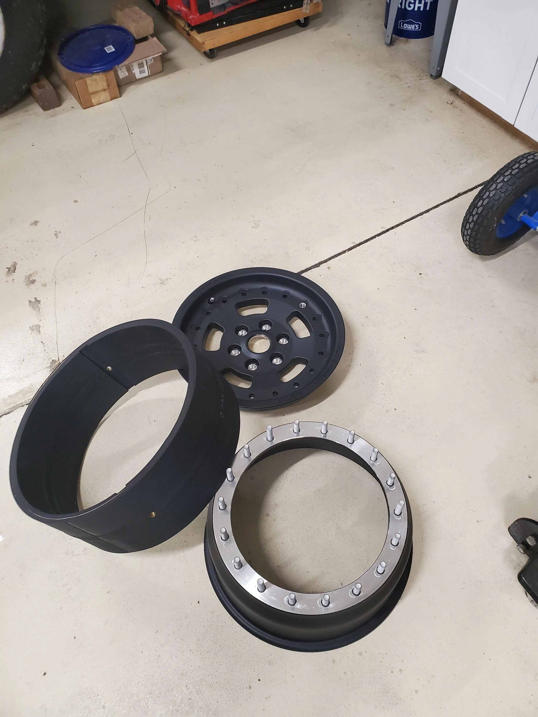

Do you guys want me to post pictures of installing the tires on a 3 piece wheel?
Ford Bronco Valhalla's Long term build thread 20230405_233818
