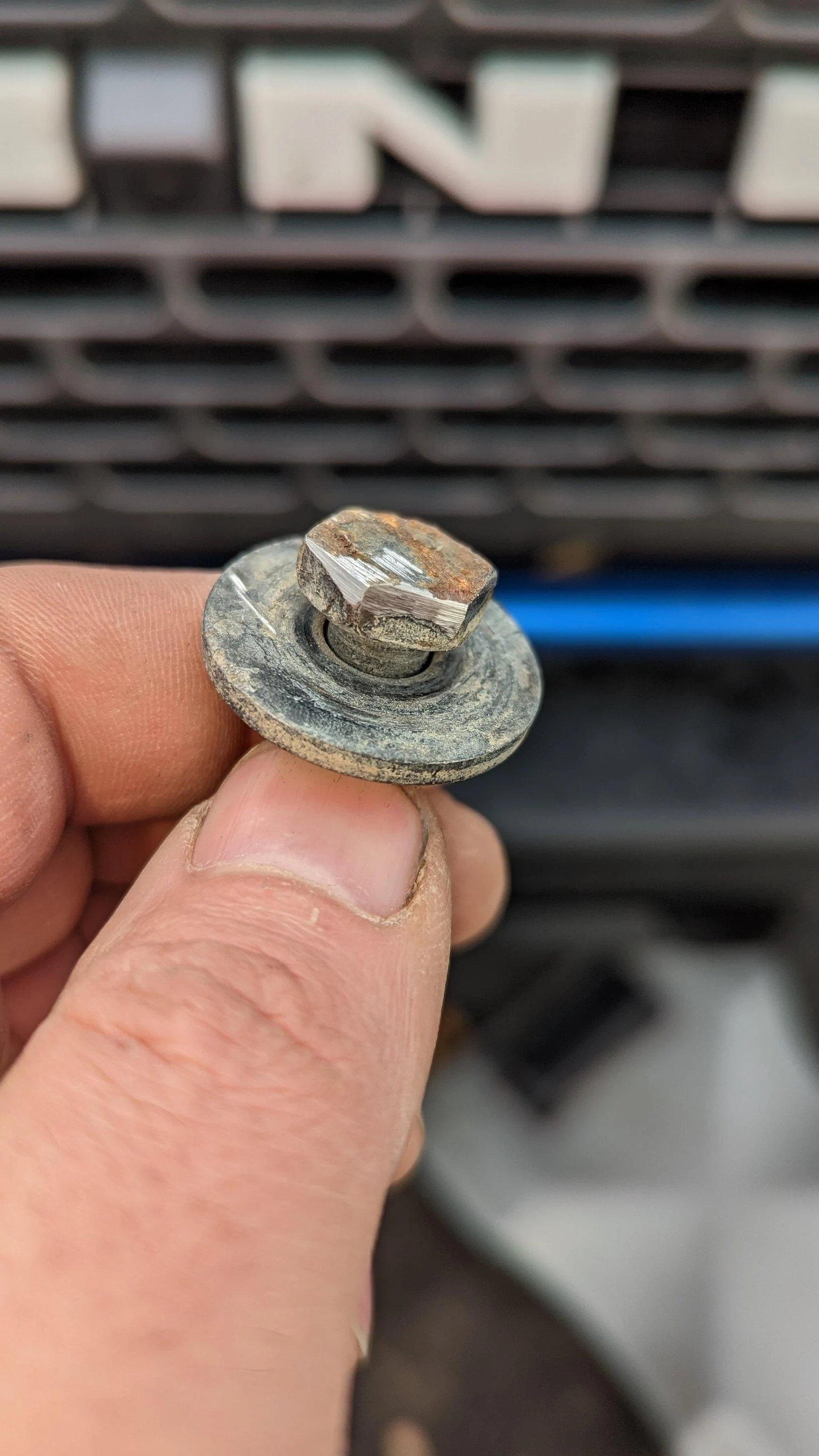

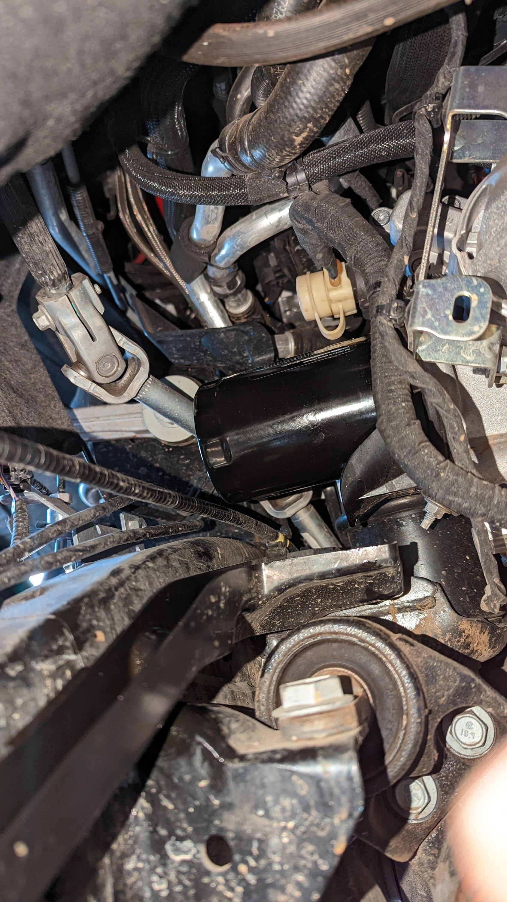

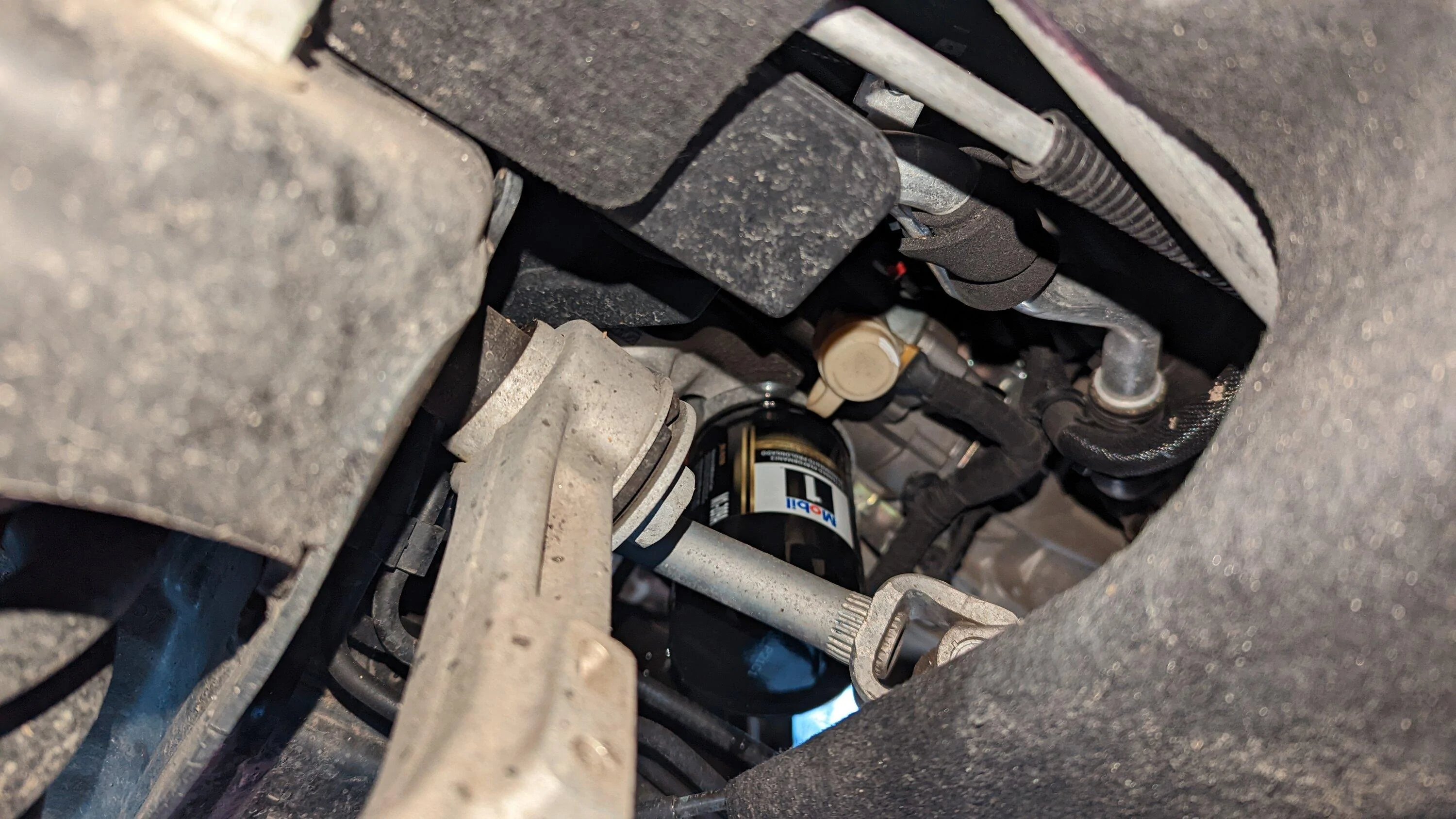

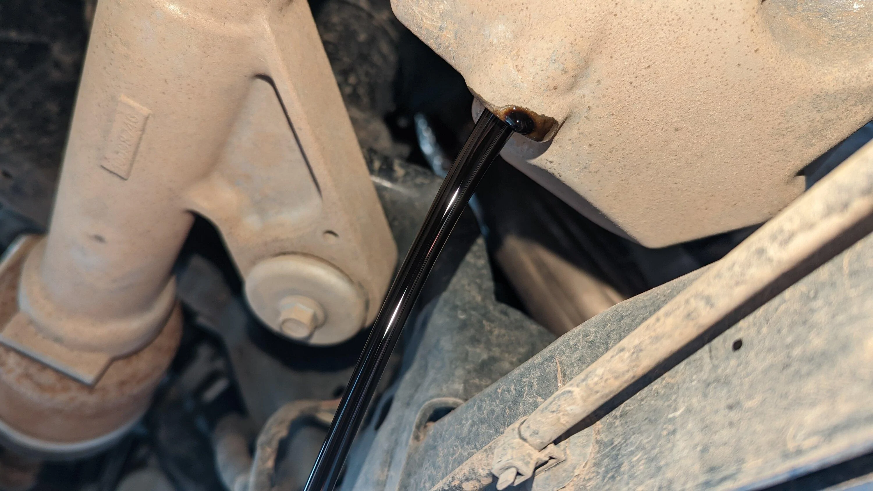

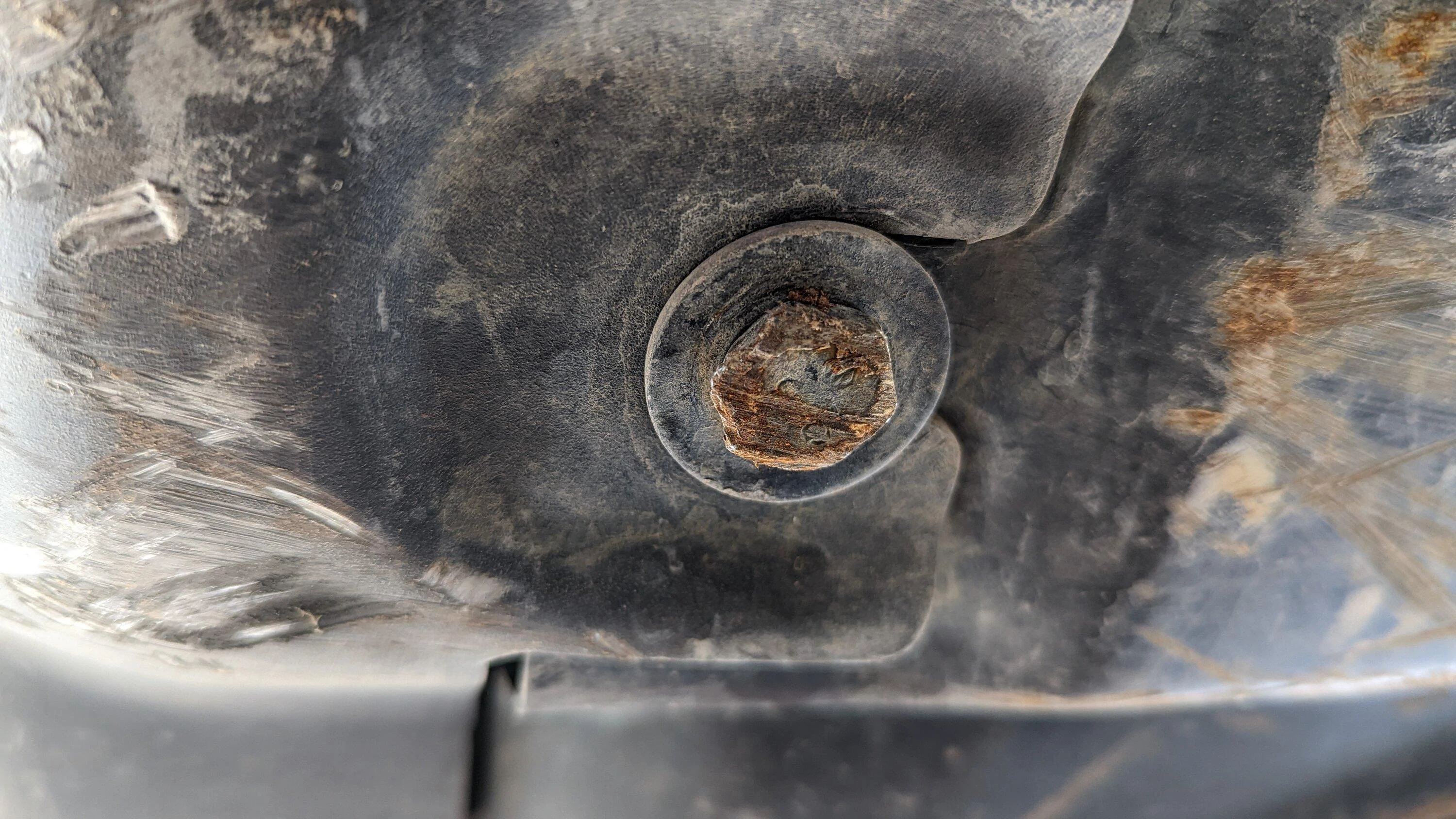

I finally got around to it at 8025 miles, about 5700 after the last change.
Slowed down a little by a messed up skid bolt.
The oil was pretty black. I'll definitely try to keep it under 5k next time.
The large Mobile 1 filter fits with plenty of room to spare. Over an inch away from the steering shaft.

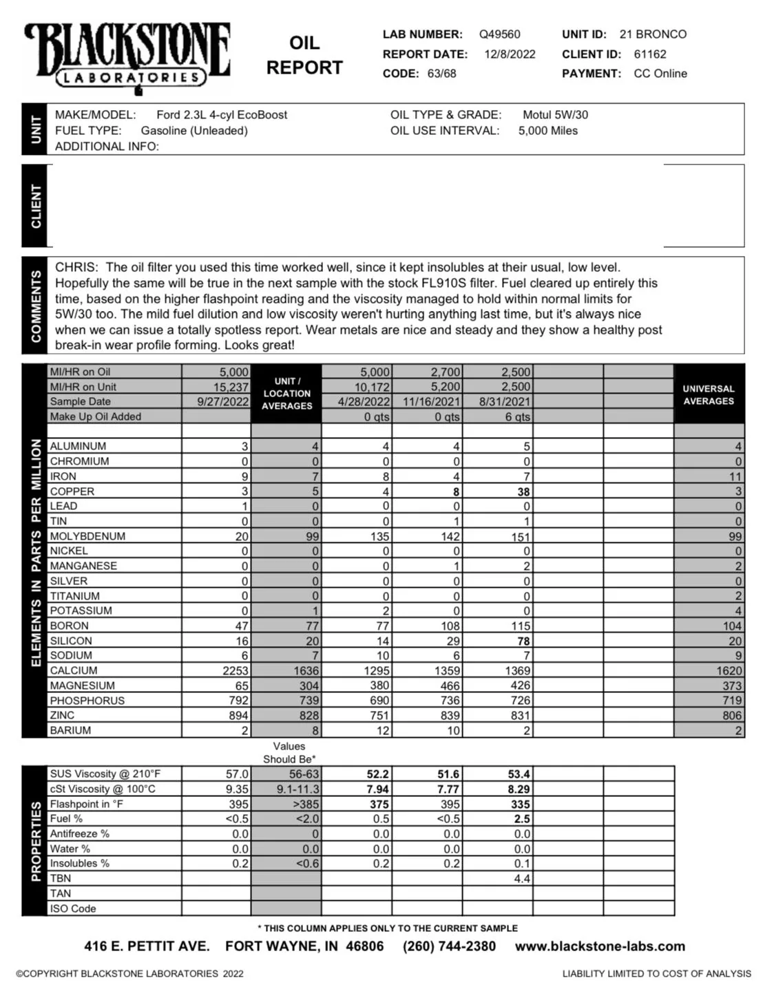

So this report is from 5k using Motul 5w30 + the FL-400S filter (Panda kit) for the first time for the 10k-15k interval. I didn’t realize it was a different filter until I did the last oil change using the kit from IAG that comes with the stock filter. So, I’ll happily submit another report at 20k to compare.
@Mitch Panda Motorworks
@IAG Performance

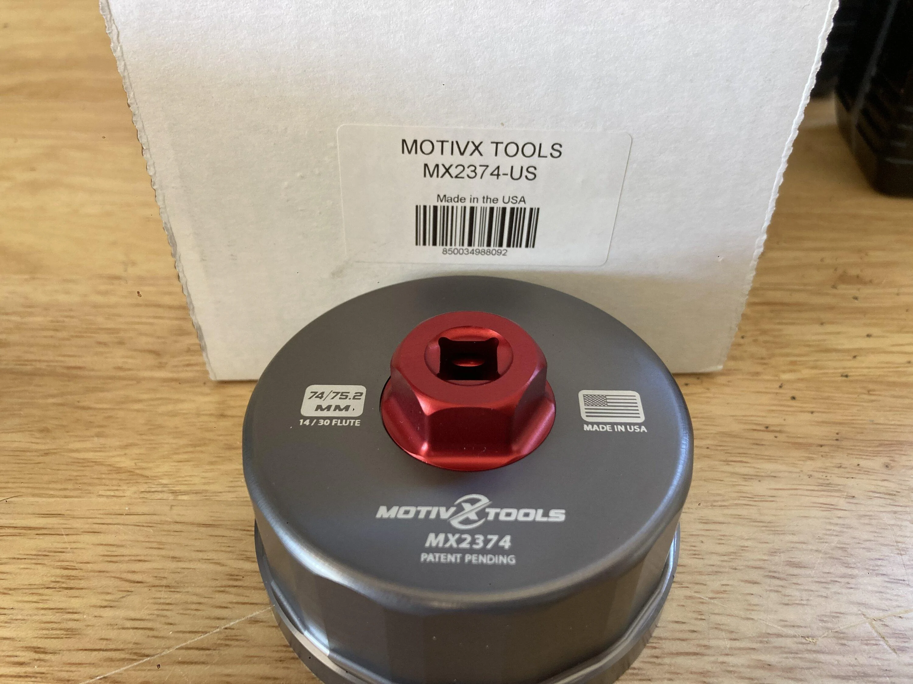

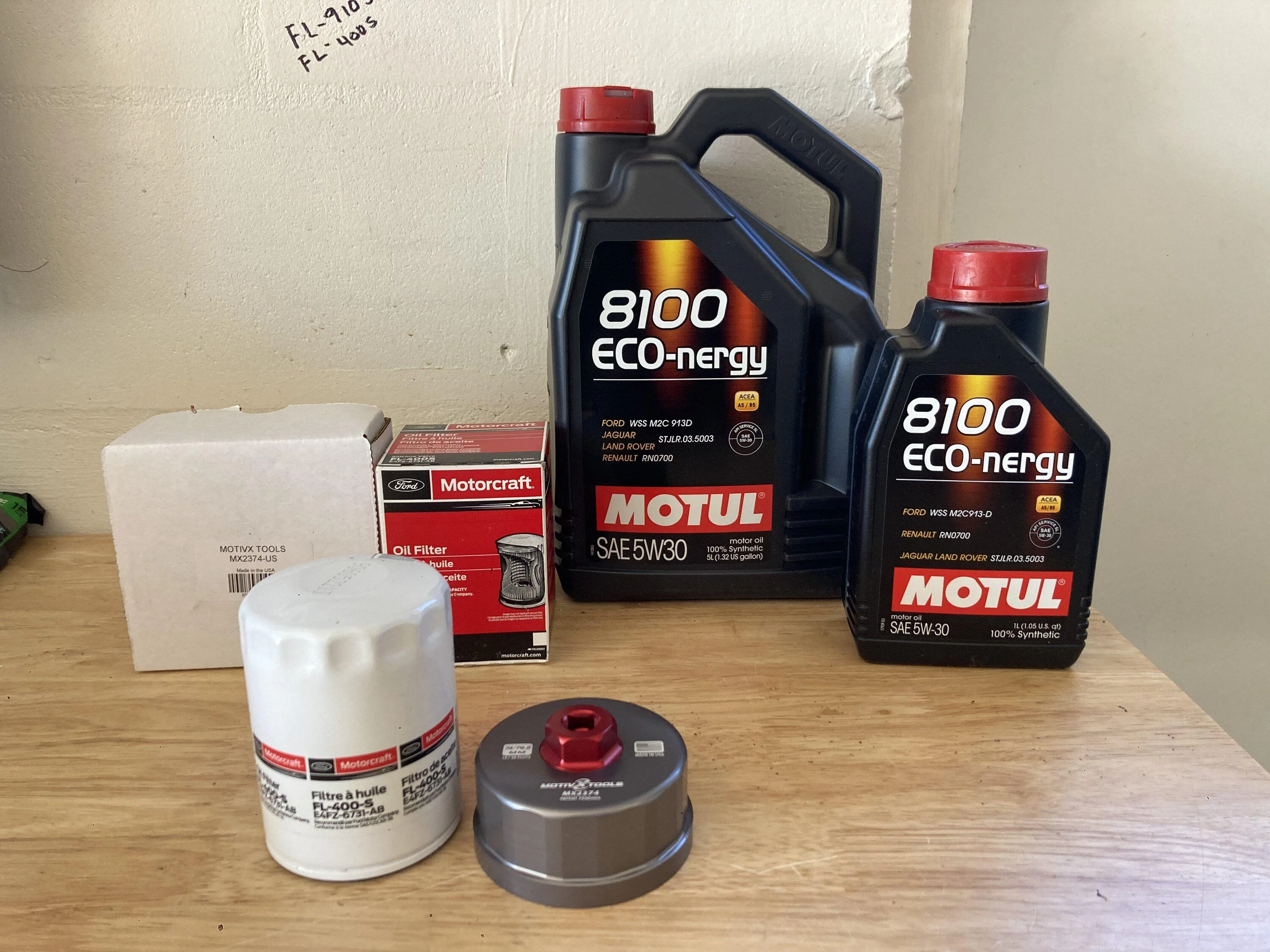

I ordered one of these - works on all the most common late-model Ford filters
https://www.motivxtools.com/products/mx2374-us
thanks, that is exactly the one I ended up finding. Thanks for your reply
so as overboost posted, here is the end cap oil filter wrench, it works on both
fl-910s
fl-400s
its a fine quality tool with sharp edges and grabs the filter well.
i ordered the panda kit, this Is what it looks like minus the tool.

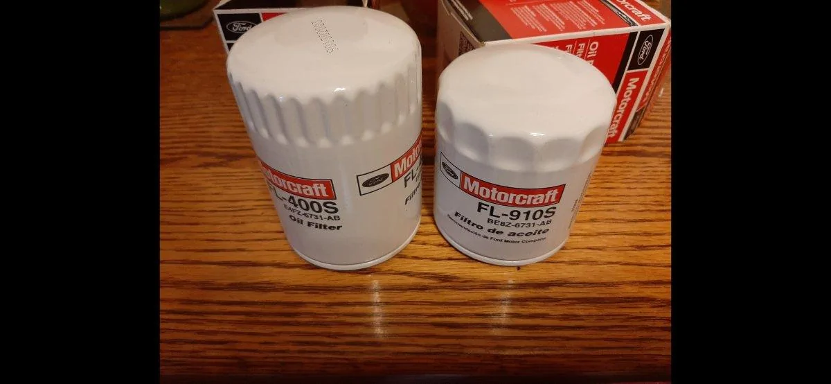

Time for another oil change and I started looking into upgrades. The FL-910S is the spec for us, but many other people with other 2.3 equipped cars have switched to the FL-400S. Additionally, the Mobile 1 M1-209 has been discussed as another step up further. I haven't pulled the specs on it yet.
FL-400 Specifications:
Thread Inside Diameter (in.): 3/4"-16
Outside Diameter Top (in.): 2.98"
Outside Diameter Bottom (in.): 2.98" Length (in.): 4.14"
Spin-On Filter: Yes
Bypass Valve: YES Color: White Burst
Pressure (PSI): 250 psi
Pressure Relief Valve: YES
PSI Relief: 20 PSI
Micron Rating: 80%@20um
Height (in.): 4.14"
Seal Outside Diameter (in.): 2.75"
Seal Inside Diameter (in.): 2.40"
Anti-drainback Valve: YES
FL-910S Specifcations:
Thread Inside Diameter (in.):3/4"-16
Outside Diameter Top (in.):3.15"
Outside Diameter Bottom (in.):3.15" Length (in.): 3.36"
Spin-On Filter:Yes
Bypass Valve:YES
Color:White
Burst Pressure (PSI): 250 PSI
Pressure Relief Valve:YES
PSI Relief:14.5 PSI
Micron Rating:50%@35um
Height (in.):3.36"
Anti-drainback Valve:YES
You ever find specs for the M1-209 filter? Just hit 2500 miles and am going to do my first change. I usually run Mobil 1 filters.
My one concern about the different filters is what back pressure they generate (at least new) verses flow rate. While the pump is positive displacement that pressure will translate into stress in the oil pump.
Back pressure should increase over time depending on how much crap the filter accumulates. I note the pressure relief is 38% higher in the 400S. That could suggest a typically higher back pressure since I think you said both have the same flow rate range. Or maybe it is expected to go higher before the oil change interval is reached.
As an engineer I recognize the smaller particle size and higher filtration percent requires more surface area to keep pressure from getting higher hence the longer length. Even if it runs higher with a brand-new filter, more frequent oil changes should keep back pressure from reaching higher than the factory filter levels or even keep it from what the factor filter with factory interval sees.
