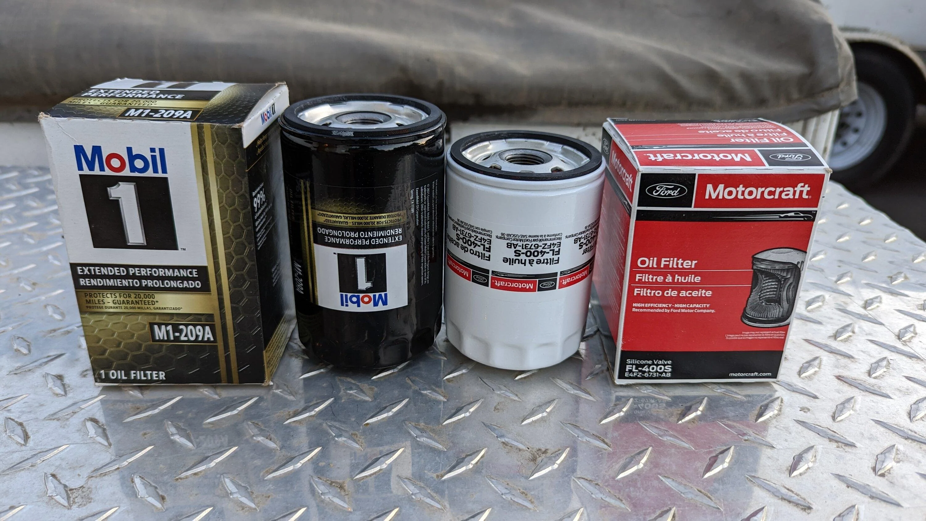

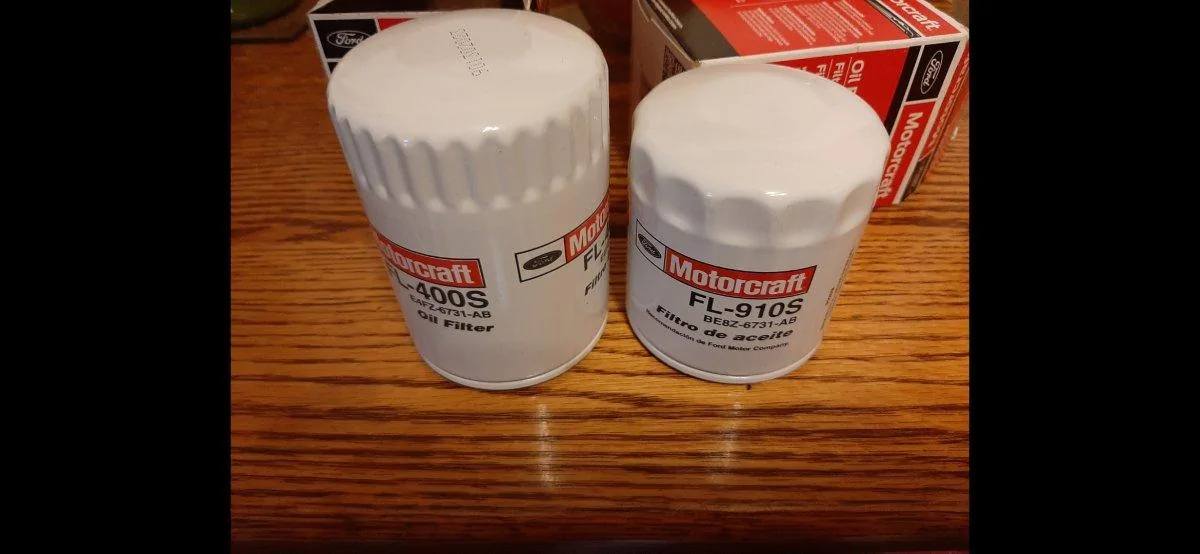

FL-400S next to M1-209 and FL-400S next to a FL-910S.
TD, I just noticed something that confuses me. Both pics have a FL-400S and I can see labels on the filters confirming that, but the two FL-400S are different. One has the same wrench pattern as the M1-209A and FL-910S, but the other has a different wrench pattern. What is up with that?
Odd. The bottom pic is older, I stole it off the internet. The top pic are the ones I bought.

I'm picking up a FL-400S tomorrow and possibly the M1-209 to compare. Both of these are taller than the FL-910S but it looks like there's plenty of room.
I wanted to think you for the M1-209A suggestion. It fits real nice with plenty of space for an end cap type socket wrench and the extra few inches of length makes it easier to reach from either underneath or thru the wheel well.
